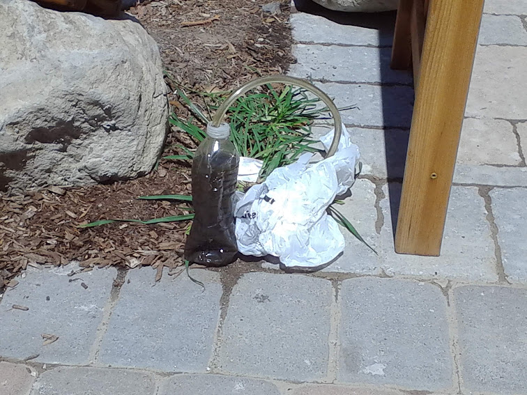

i tend to end up working alone a lot, so i made my self a one man bleeder set up. all you need is some clear tubing that fits tight to the bleeder nipple, then make that line like 2 foot long. now get a used clean dry plastic bottle. drill, burn what ever ya got to make a hole in the cap so the line fits through the hole and reaches the bottom of the bottle, then make a smaller pin hole so air can get out of the bottle. fill the bottle 1/4 way with brake fluid, make sure the line is under the fluid, open the bleeder put the hose on it, then you can go pump the brakes slowly, down then up down and up. repeat till theres no more air coming through the clear hose off the bleeder, (with your miles id keep bleeding till clear new fluid is in the line, watch the master level. it can drop pretty fast) snug the bleeder and pull the line off it. repeat on the rest of the brakes.
my diy one man bleeder after a fluid flush. whats nice is you just use a another cap and toss the bottle in the trash or drop the old fluid at the parts store.
