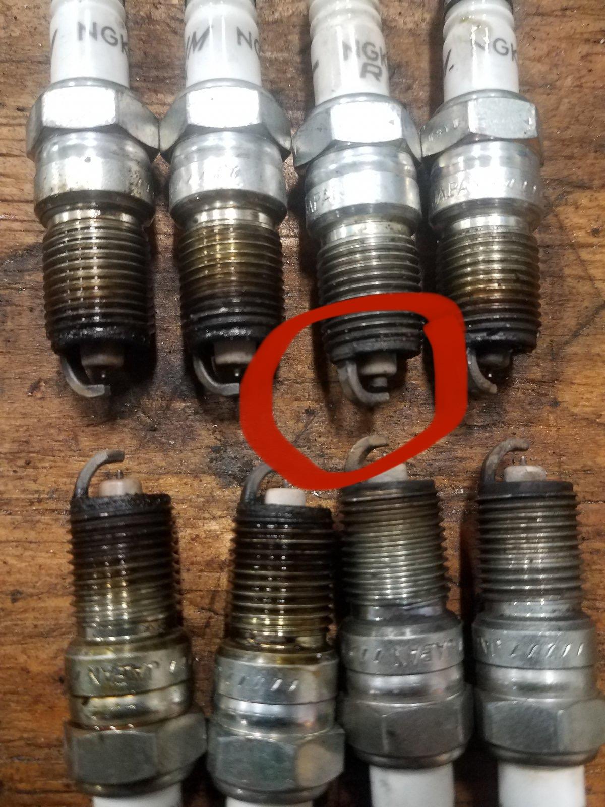

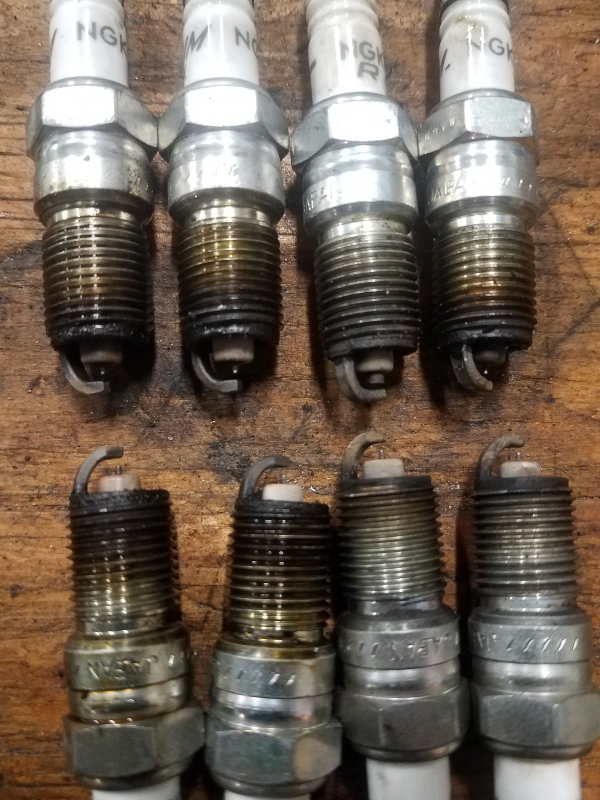

Strange that one of your old plugs looks like it's copper but the other ones are not.
Interesting!

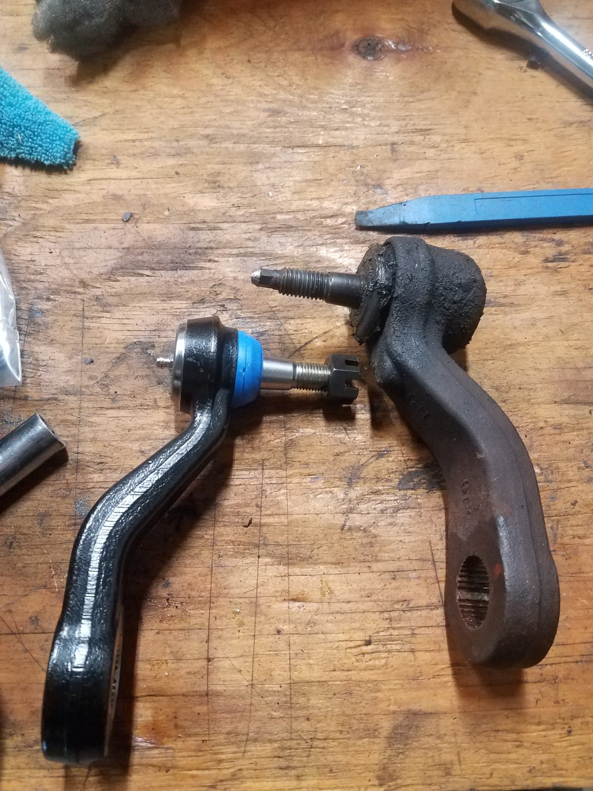

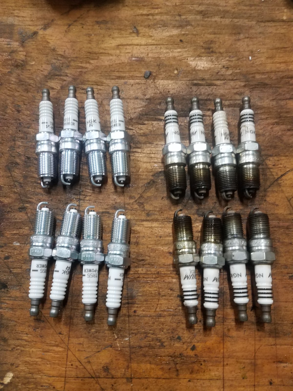

Steering is all finished up as is the wheel bearing and fresh TR55 plugs to replace the random assortment of TR6s.
Steering feels a little tighter I wouldn't say its night and day but it was never really "bad" before. Only thing I don't like is I got a AC Delco professional grade pitman arm and it seems considerably smaller than what was on there which I'm 99.9% sure was stock however, I do like the better quality blue boot.
Plugs were a little oily but I don't remember if I ever got them real clean when I installed them with the new heads.

Not a Delco fan when it comes to plugs I see. We ran NGK's in our sleds.

When I had the valve drop and the heads went to the machine shop they stole my like new tr6 iridium plugs. When I thrashed to get it slammed back together I realized it was to late to run to the parts store and get new plugs and I wanted it running that night so I scoured my old parts boxes and came up with what I think was 7 iridium from the previously boosted 4.8 on the floor and then 1 random plug from IDK what. Brushed um, gapped um, gave um a brake clean BJ, and threw um in while telling myself "Ill order new ones tomorrow". Never had any knock issues or weird misfires.
Always have run NGKs in LS stuff, I guess because LS1 tech seems to like them the best.

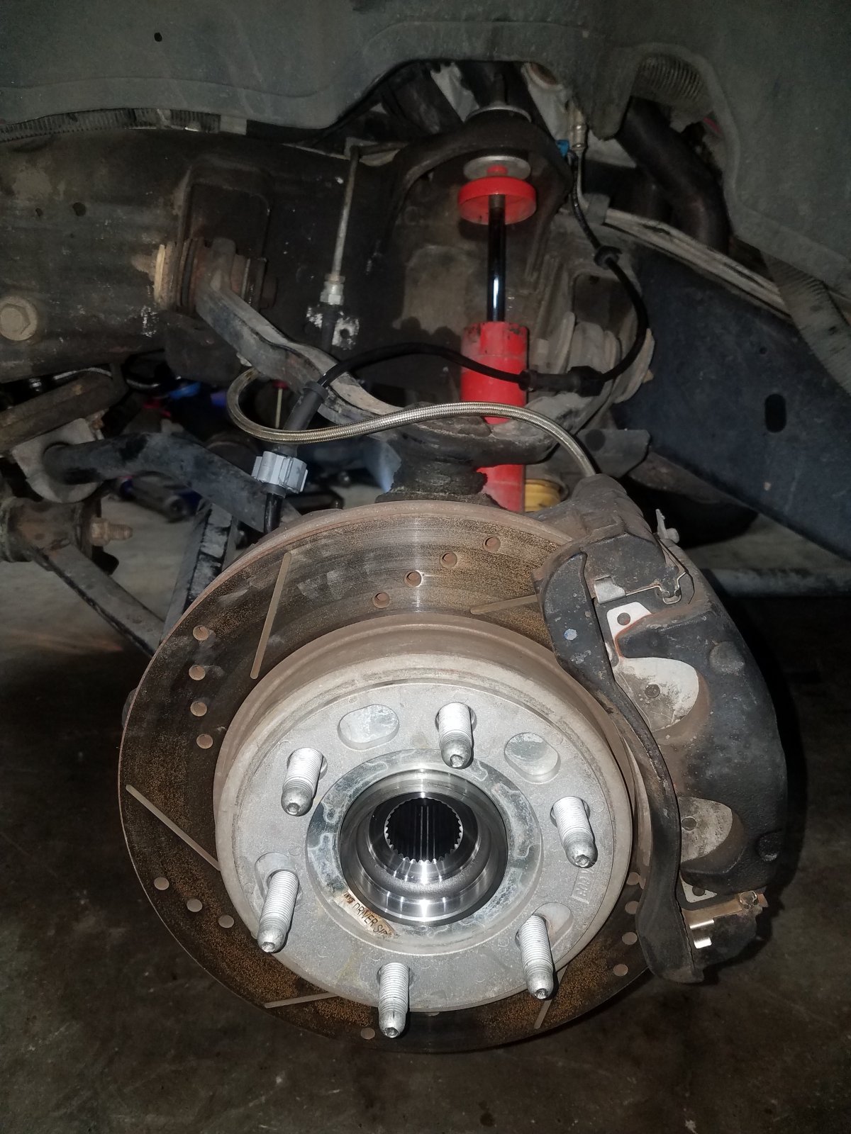

Creaky, groany, haunted house noises from the front end are still haunting me. Pretty much the only thing left is ball joints which certainly aren't fresh but don't appear to have any play or make any noise from me wiggling them around.
The problem is if I do upper ball joints I should really just do loaded UCAs cause it's easier. If I do UCAs then I need an alignment which is kind of a waste because coilovers also require an alignment. 2 alignments are more expensive than one so the solution to my groaning steering is a coil-over swap down the Randy rabbit hole of "While I'm in there might as well do XXXX".

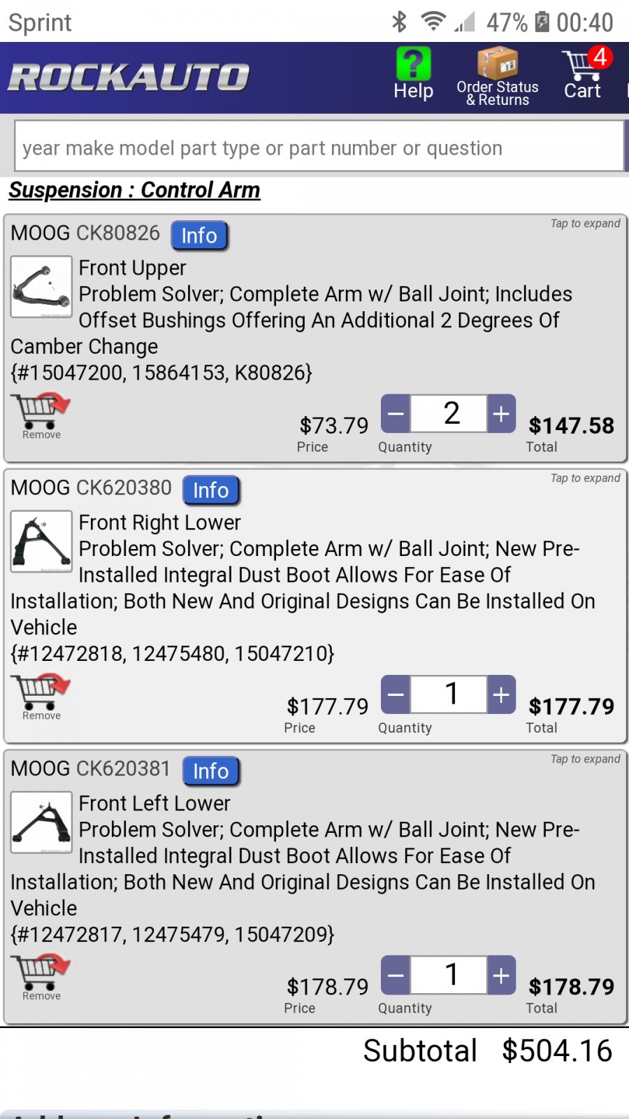

Ball joint is clunking pretty bad now, coilovers are ordered and should be here soon. Looking at doing UCAs obviously but I suppose I should go ahead and do LCAs as well since they likely have over 250k on them and it would be kinda dumb not to replace them while I'm in there.
Problem is I see so many mixed reviews on Moog and Delco parts being sent as knock offs or quality control being shit.
If you were to buy all 4 where would you get them from and what part numbers or manufacture would you use?

Went ahead and bit the bullet from Rock Auto hopefully everything is true Moog parts and fits as it should. I'm excited to feel a 260k mile POS with all the steering and suspension replaced. More so looking forward to not hearing it.
