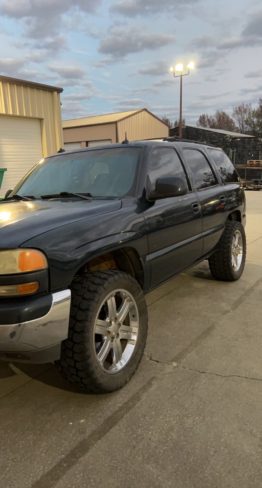

Pics of the truck, please.

Thank you all so much, sorry it took so long to get back to you all as I’ve been at work. A few more details, sorry I’m leaving things out, but the truck will drive down the road. I can take it to work and back, the issue just gets worse the lower it gets on fuel. The truck had all the seals redone (including the rear main) when it was in the shop, and I do have a scanner that can read it. I have to replace a fuse as my cigarette lighter and OBD2 port are not working, but I’m hoping it’s that easy of a fix. I’ll be replacing the fuel filter on Saturday to see if this helps the issue as well. Picture of truck currently is attached. 110F0479-35D2-43AC-BC6F-6F5104EC1331.jpeg
