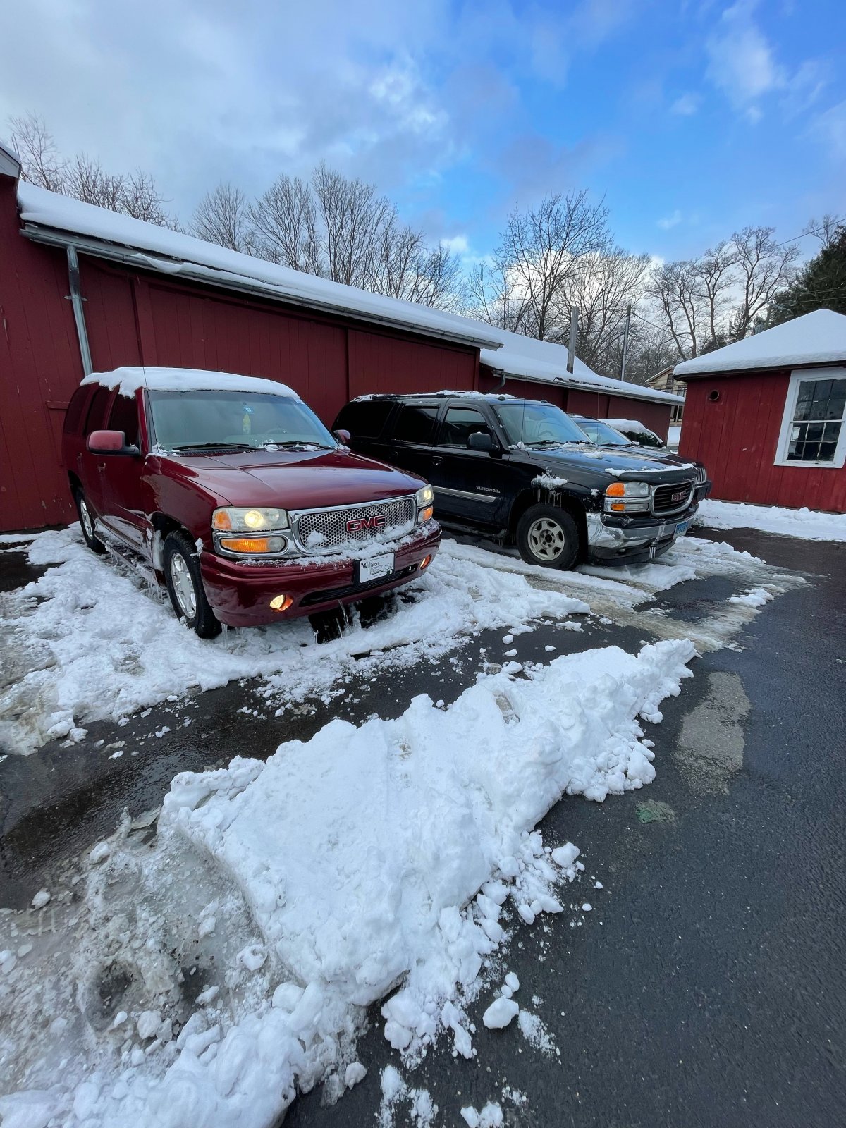

Hey Y'all I just picked up an '03 Yukon Denali. I bought it in Burlington,Vermont but luckily its a California car that I saved from certain death by salt. It had 123k when I bought it and its got roughly 126k now. What kind of General Maintenance should I be doing? Tried to search but didn't have much luck. Any insight appreciated. Also any cool mods or tricks would be helpful. Thanks guys.
W
Wings720
Dec 26, 2021
59
63
It's also de-badged and I initially thought I got scammed and this wasn't a Denali. Lol

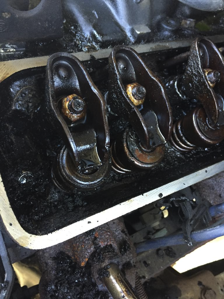

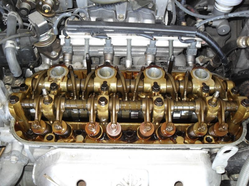

Drop your oil pan, valve covers, valley pan, clean up manually:

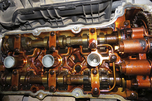

- Pop the heater core hoses out of the bracket, remove the bracket, then grab your engine oil fill riser and turn it counter clockwise. Peek inside the valve cover to see what, if any buildup/varnishing exists. Some varnish is fine - will look like a light brown coating. Anything chunky / thick / flaky looking - run short oil intervals until it cleans up. Don't bother with flush products. Just change it more often and let the oil do its thing.

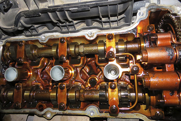

For the varnish bit I mentioned above
Normal:
Change more often:

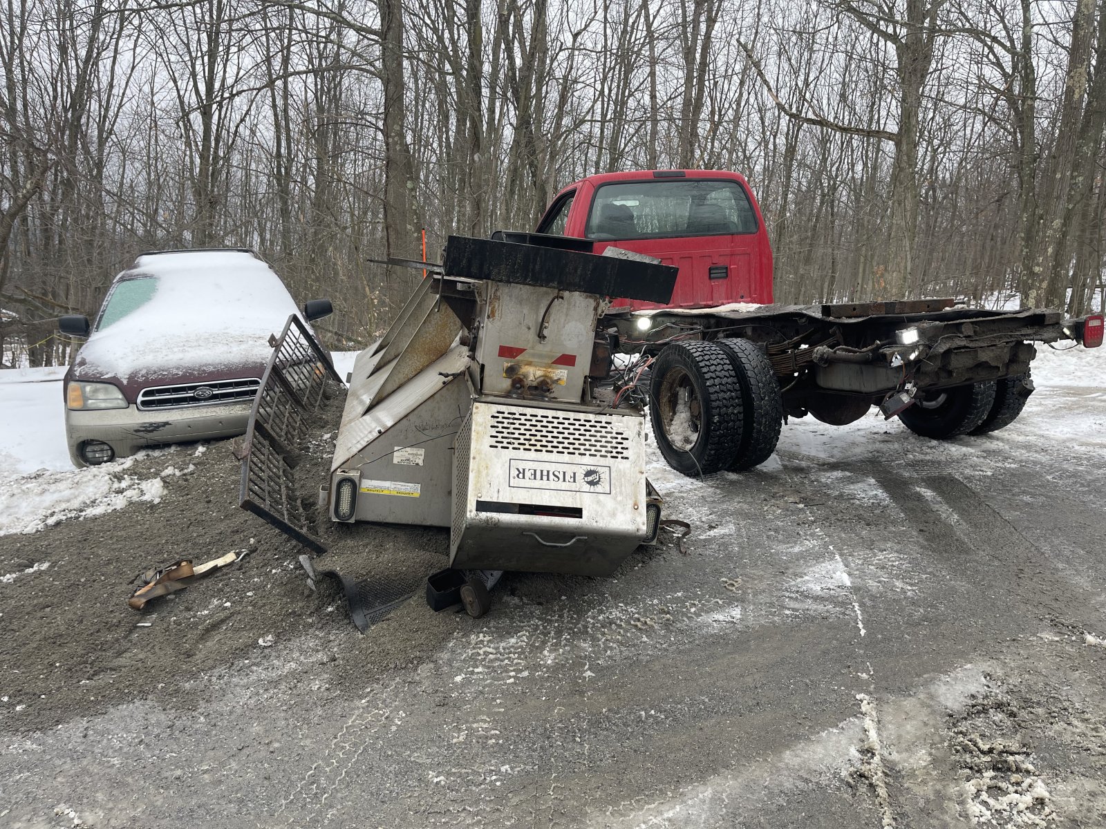

Plow truck got rekt today so have to spend the rest of the weekend working on that.
