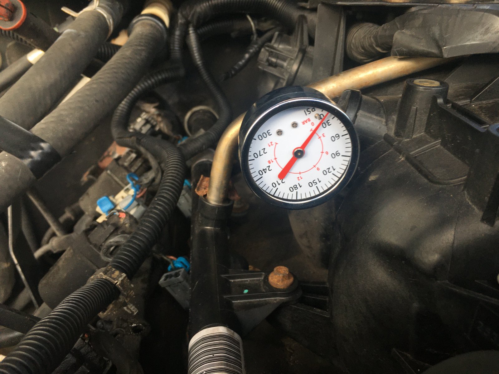

Now comes my question, I’ve purchased a fitting for the fuel rail, and a guage. Removed the valve interior, and tightened the fitting, and then secured the gauge. (It is upside down). I started the truck, after noticing nothing on the gauge after “key-on” position. Started the truck up, and still nothing.
Am I missing something? It revs up but sounds like she’s starving for fuel. Slow increase in Rpms has no effect, but a quick push to the floor results in bogging, and a shudder, and it shuts off. Unless, I catch the Rpms and tap the gas less and less to Let it down easy.

Recommend renting a fuel pressure gauge from a nearby auto parts store. Many times they do that for a refundable deposit so if it's returned within the allotted time it's free. Then put the Schrader valve back in the fuel rail and do the standard key on, engine off ("KOEO") test.
You must have some fuel pressure if it runs, so something is wrong with the current test setup. If your truck is Flex Fuel the KOEO pressure specs are somewhat different from non-Flex. What's the 8th character of your VIN?

As expected. I have not however, tested fuel pressure on the rail. My Original starter from 03 just went out this year. Completely rusted through, you could see the internals. Hell of a starter.
I am waiting on my pressure gauge to arrive.

When you check the fuel pressure, with the new gauge, I always like to have the longer line on it that allows you to bring out the back of the hood and tape to w/s to watch. Hopefully the MAF clean and TB clean will fix it.

I did also finally get the correct fuel pressure rail gauge, and have 53pounds at key on, and 56/55 at idle. Hard acceleration shows 64/65 pounds.

Fuel pressure seems high when running. I think these like to run in the low 40s -- 43, 44 or so. Fuel pressure that's too high can cause issues, maybe not these, but...
KOEO specs for NBS V8 engines:
Non-Flex: 55 to 62 psi
Flex: 48 to 54 psi
