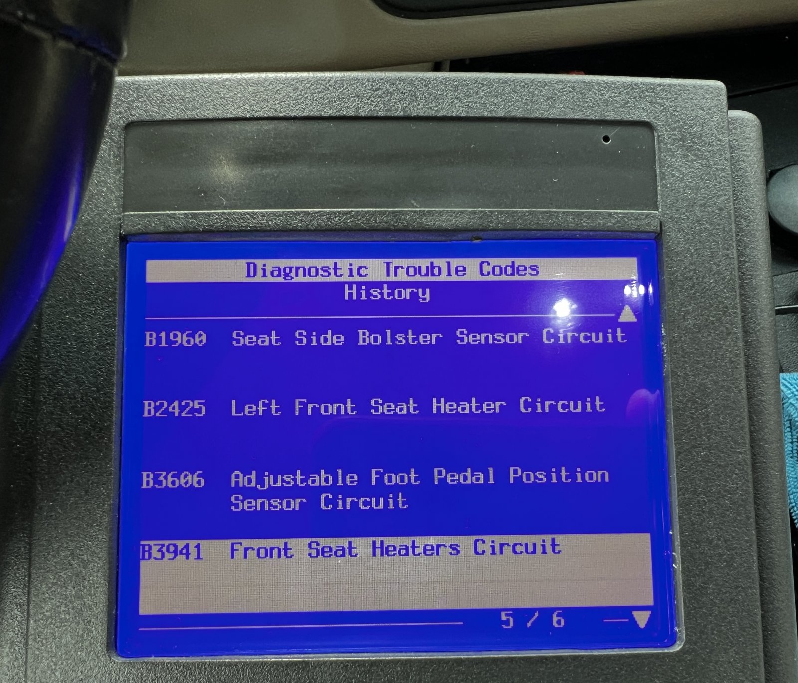

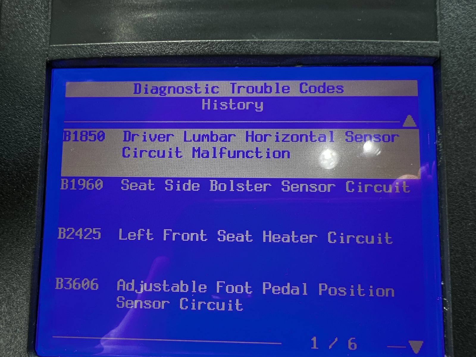

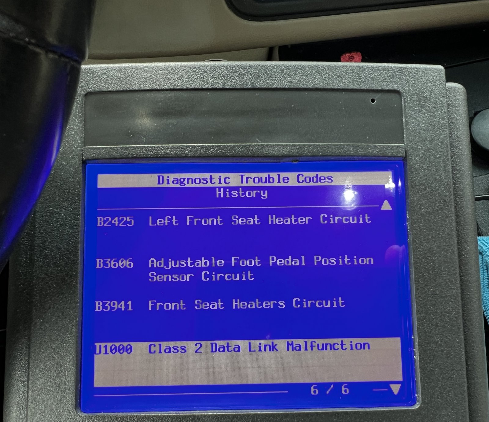

Updated information
From Tech2:
Currently no DTC for the driver seat module, but the following are in History, presumably from before heating element(s) were changed..
Do not use the adjustable pedals, so not sure what that issue was as they are working normally.
The multiple logged issues seem to lend credibility to either a wiring harness, ground, or a combination of the two.
