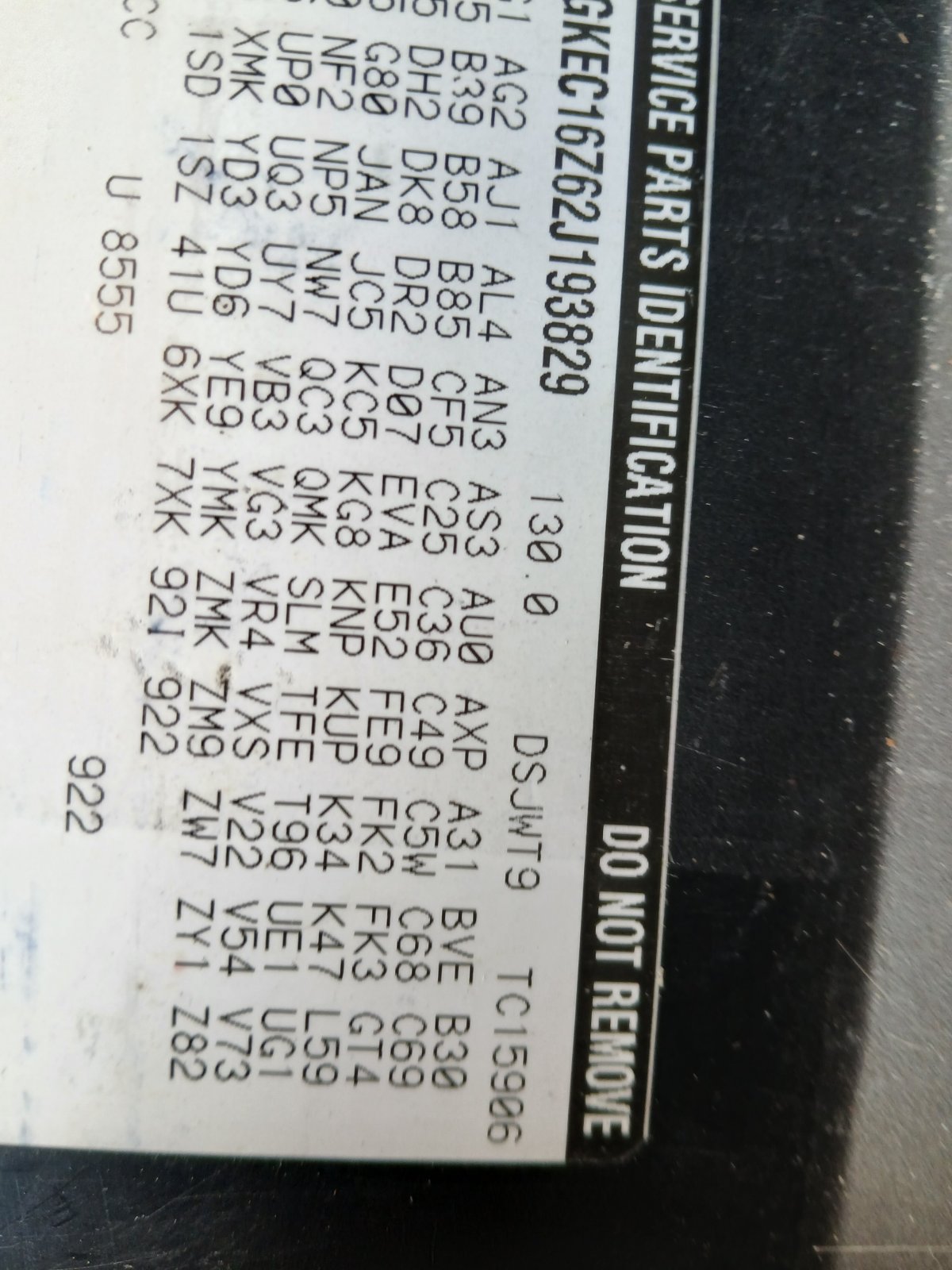

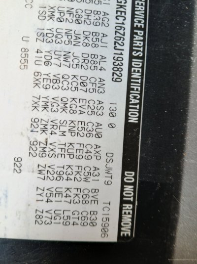

Codes from yukon xl #2
Moderator
16,620
34,401
People's Republic of Colorado
I turned it for you.
For your 2002:
G65 = Nivomat self-leveling manual shocks (if they've never been replaced)
ZW7 = Premium Smooth Ride (PSR) which means that the rear springs are softer to match up with the Nivomat shocks
If you replace the OE rear shocks you should also replace the springs. Rock Auto has recommendations, but you could use a Z71 or non-PSR spring

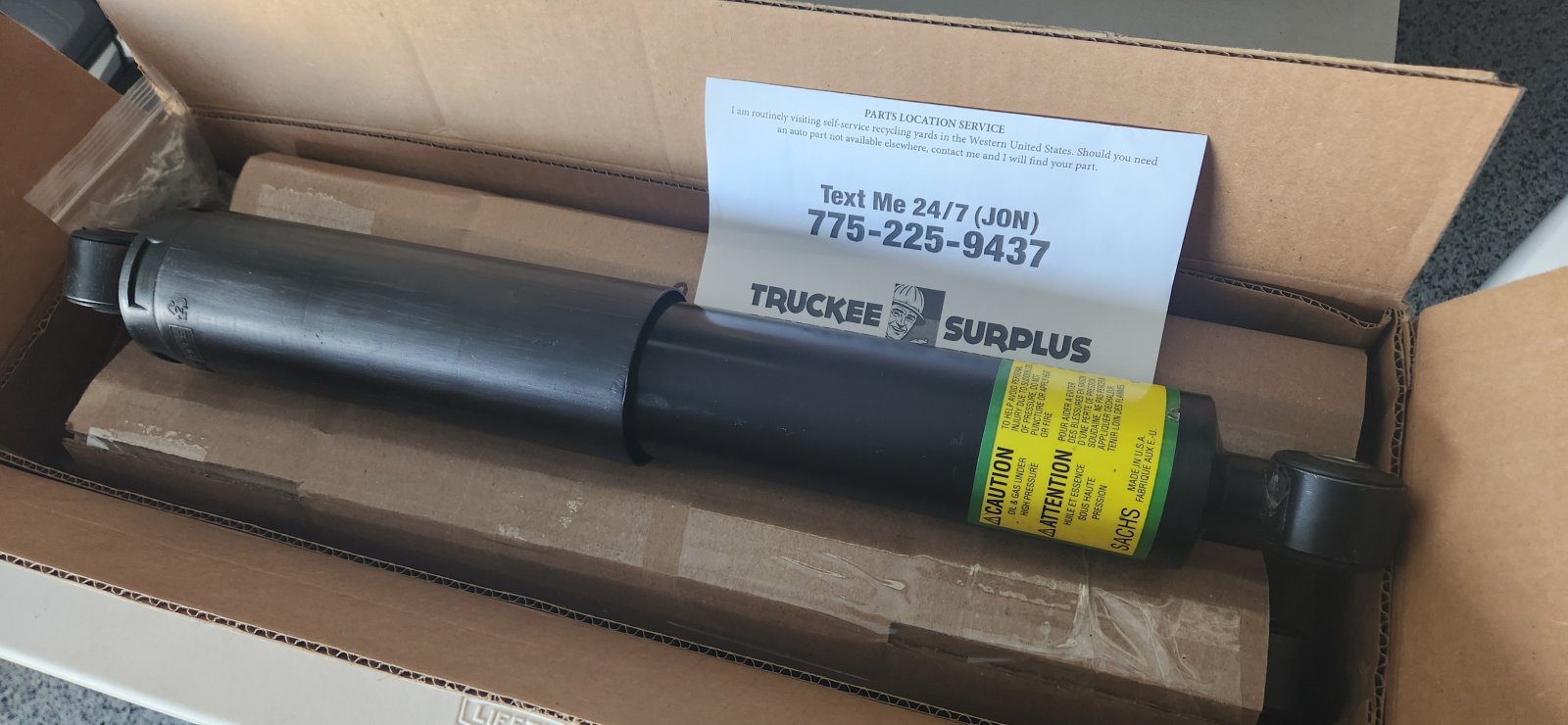

If..... You have Nivomat ( Sachs) self-adjusting shocks... Contact John at " Truckee Surplus" ( 775) 225-9437... He has good quality used Nivomat shocks for less than, 1/2 the price. ( I mistakenly ordered a set.. they were like brand new )
Your RPO codes will show you what you should have... Beware... there are 3 different factory versions of your rear set up.
So your codes are important !

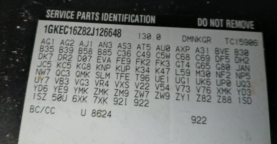

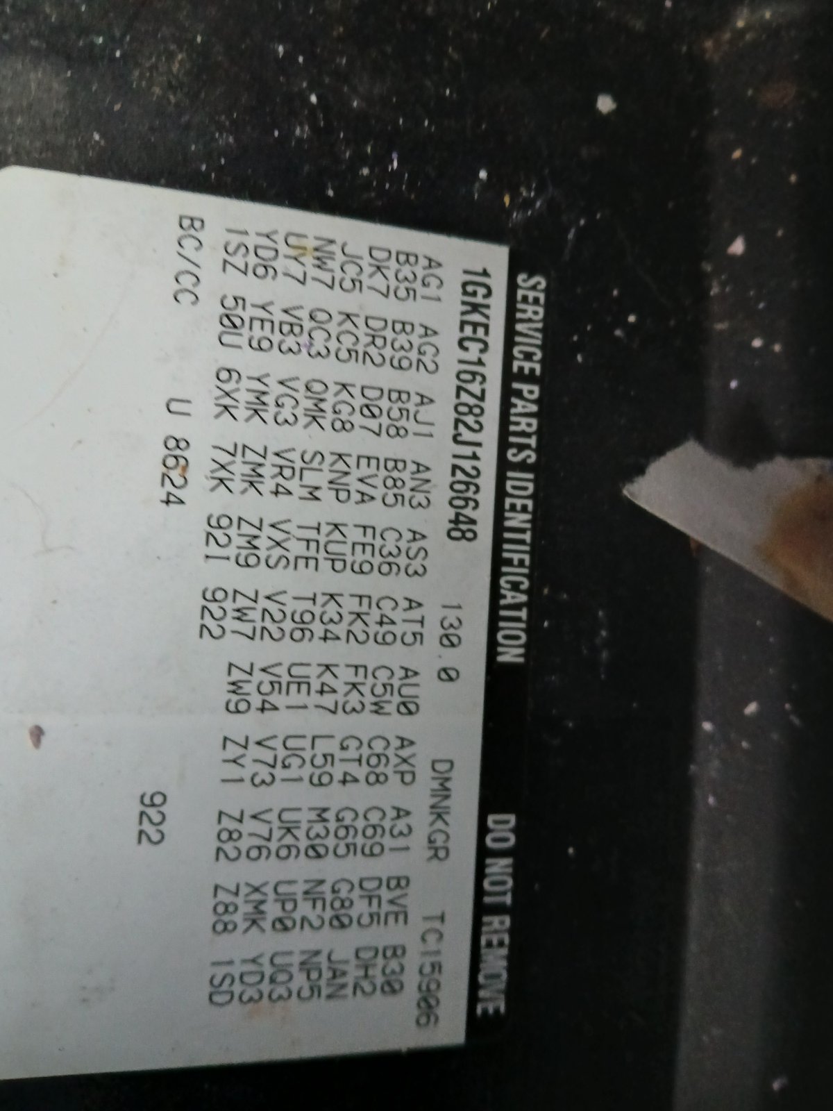

Yukon #2 codes.think its the same novomat setup. Trukee surplus shocks come off 04-06 vehicles. They may look new, but i think theyre still 18-20 year old shocks. Am i wrong?
He has a relationship with salvage yards...... The Nivomats I got were from a Yukon, that replaced them with new ones. They were not old.
I don't see the codes....
You would be correct unless they were a later replacement; but chronologically they are likely old.

Ok...codes for yukon #2
