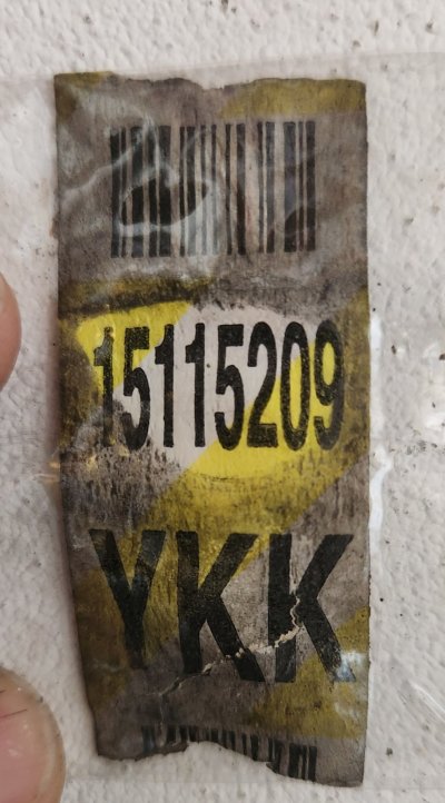

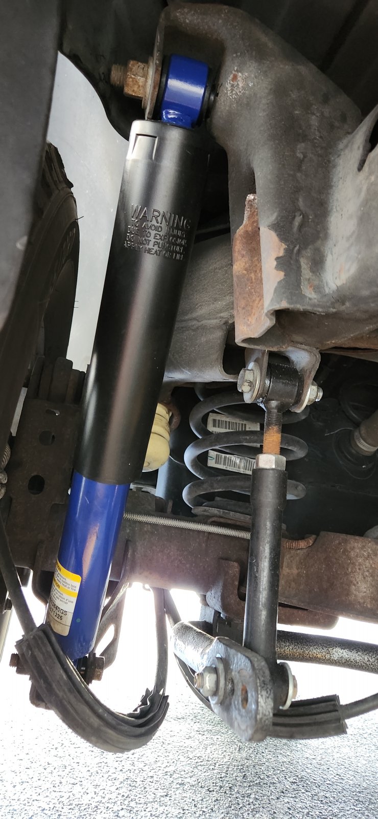

My '05 Yukon XL RPO codes...... My rear shock...... coil spring label.......
I have the ZW7 " Premium Smooth Ride"..... But not the "self adjusting Sachs "Nivomat" shocks.
The coil spring part number ( You might be lucky and still have the sticker on one of your rear springs)
I do NOT have the "self adjusting shock RPO > G65 code.
So, you just saved a bunch of money..... Just replace your shocks with the OEM standard premium shock.

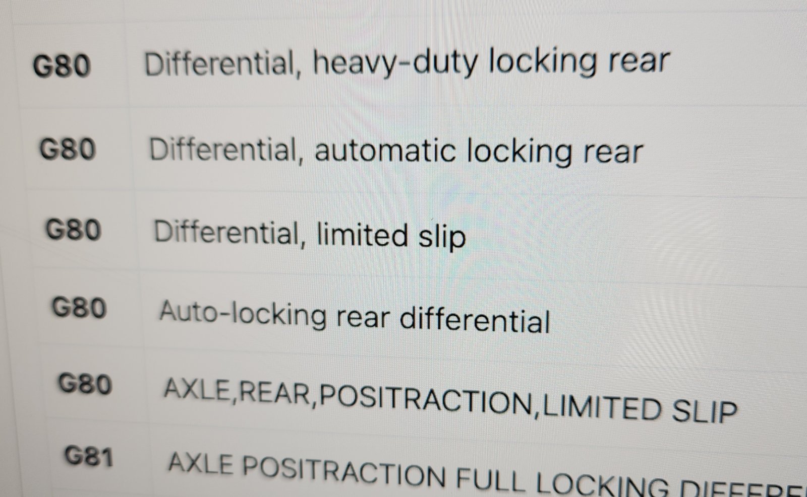

G80 is your rear axle. GU6 is the ratio (3.42:1).

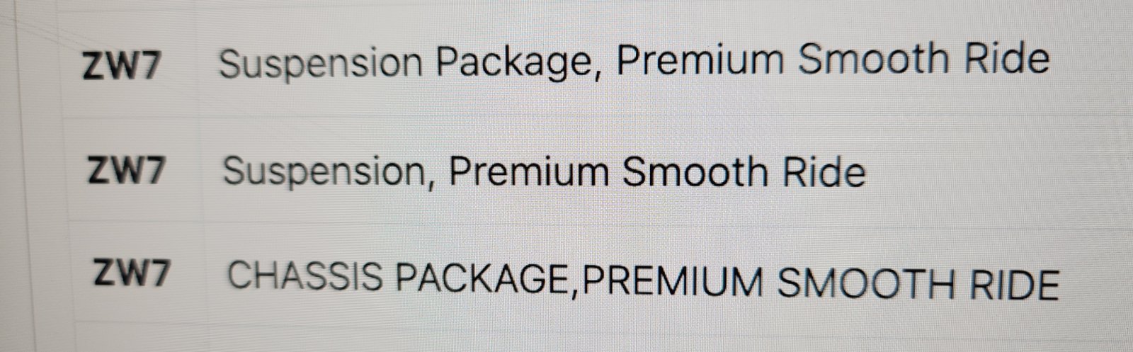

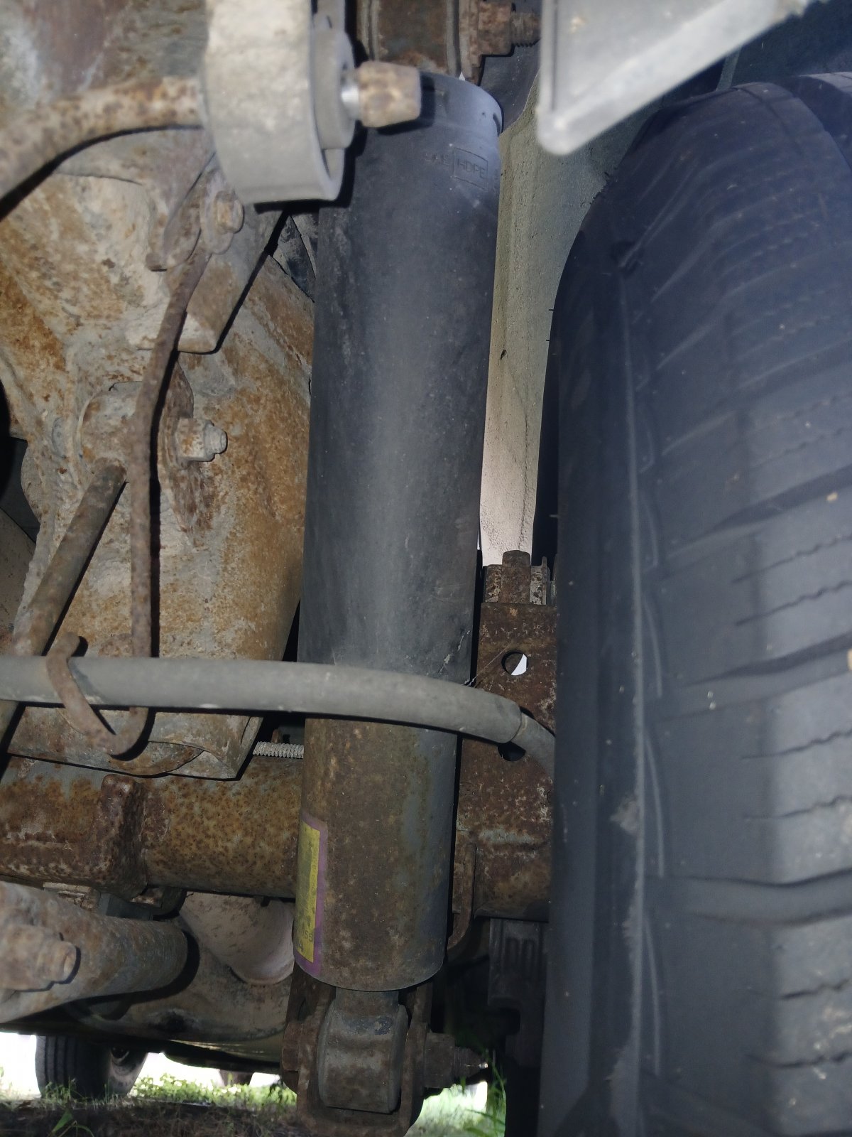

I didnt realize my codes were unreadable. When i saw zw7, i figured it was nivomat. Now im confused. I can post another photo of the codes later. So....do yall think they are or arent nivomats? Certainly not air shocks. I stood on the rear bumper and tried to bounce the vehicle. Its really stiff. But last time i towed, it bounces a lot under load.
mountie
May 9, 2018
7,199
14,016

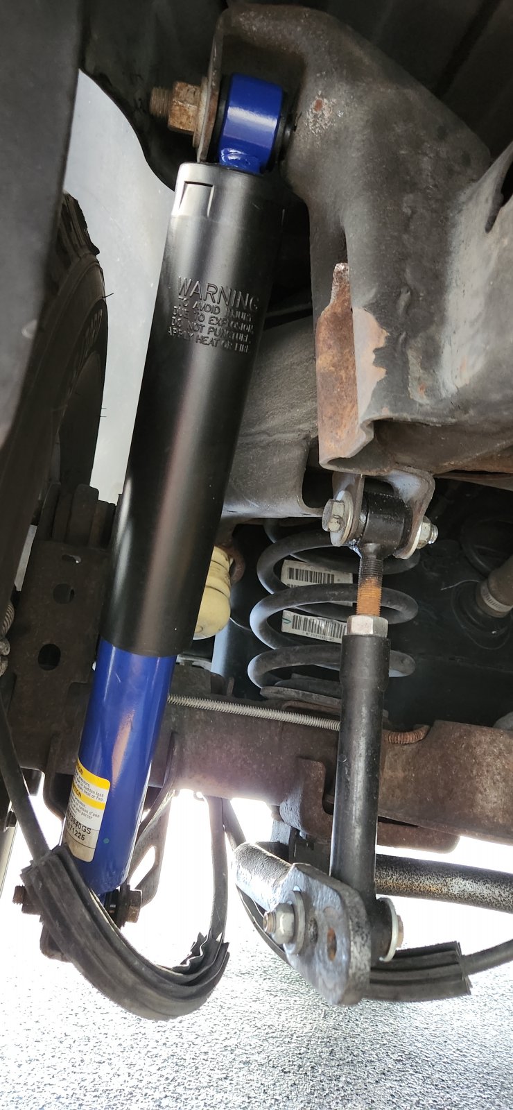

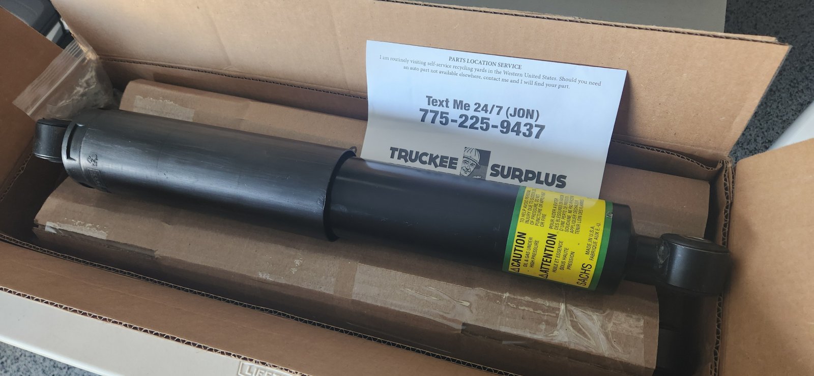

Take a photo of your shocks...... 1st photo are my new ZW7 'Premium Smooth Ride' ... standard factory shocks. ( regular width ). About $50.00..
2nd photo are Sachs / 'Nivomat' .. ZW7 , ' Premium Smooth Ride' 'self leveling shocks' ( self-contained / no air compressor ) , a larger width. About $400.00 (+ - )
Then there is a premium ZW7, leveling shock, with an air compressor fitting on the shock. ( I don't have a photo of that)
( My info may not be perfect, but just to give you an idea )
FLESS IS WATCHING ME...... He's better at this stuff, than, me.... :love51:

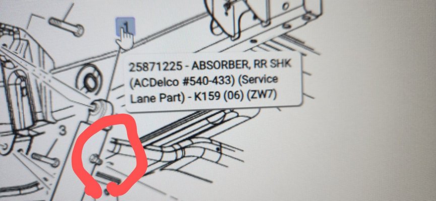

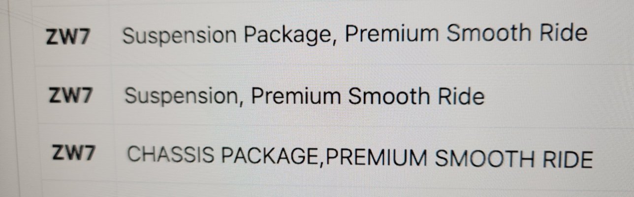

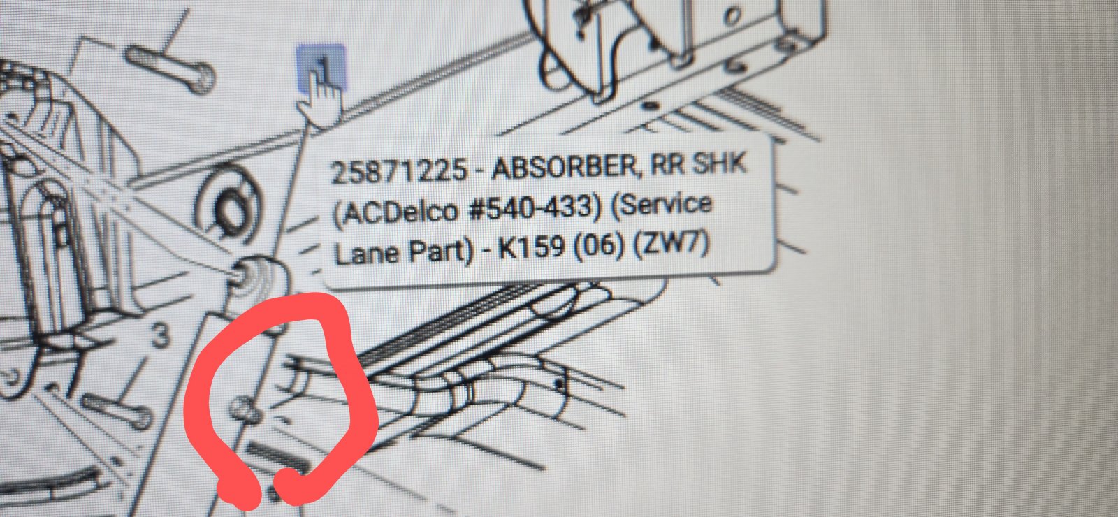

If you go to the dealer, and do a parts search for your ZW7, and using your VIN #, THIS WILL CONFUSE YOU EVEN MORE.... The drawing, AT THE DEALER, is for my ZW7 premium smooth ride / STANDARD shock.....( #540-433 ) But for some silly reason, the drawing, AT THE DEALER'S PARTS COMPUTER, shows an air fitting on the shock, even though, THAT shock does not have an air fitting.....

ZW7 indicates a variation of the "Premium Smooth Ride" suspension. On the GMT800 chassis the "G65" RPO indicates the Nivomat shocks in the rear (and likely a front shock that is different from the Z71 or standard suspension). The rear springs are also softer. Take both RPO codes into consideration.

Codes and shock photos

Ok...i loaded the rear axle with over 300 lbs of weight. Took measurements at my hitch before and after. 13" before and 11.75" loaded. Drove it a couple miles and took another measurement. Still 11.75". Drove it another 3 or 4 miles. Measurement wasnow back to unloaded measurement of 13". Maybe nivomats are ok? Maybe my bounce is front shocks? Its worse when i have my camper attached going down bouncy road.
M
me262
Dec 1, 2024
23
I think im going to try kyb shocks on the front. Anyone used these before? Thks!
