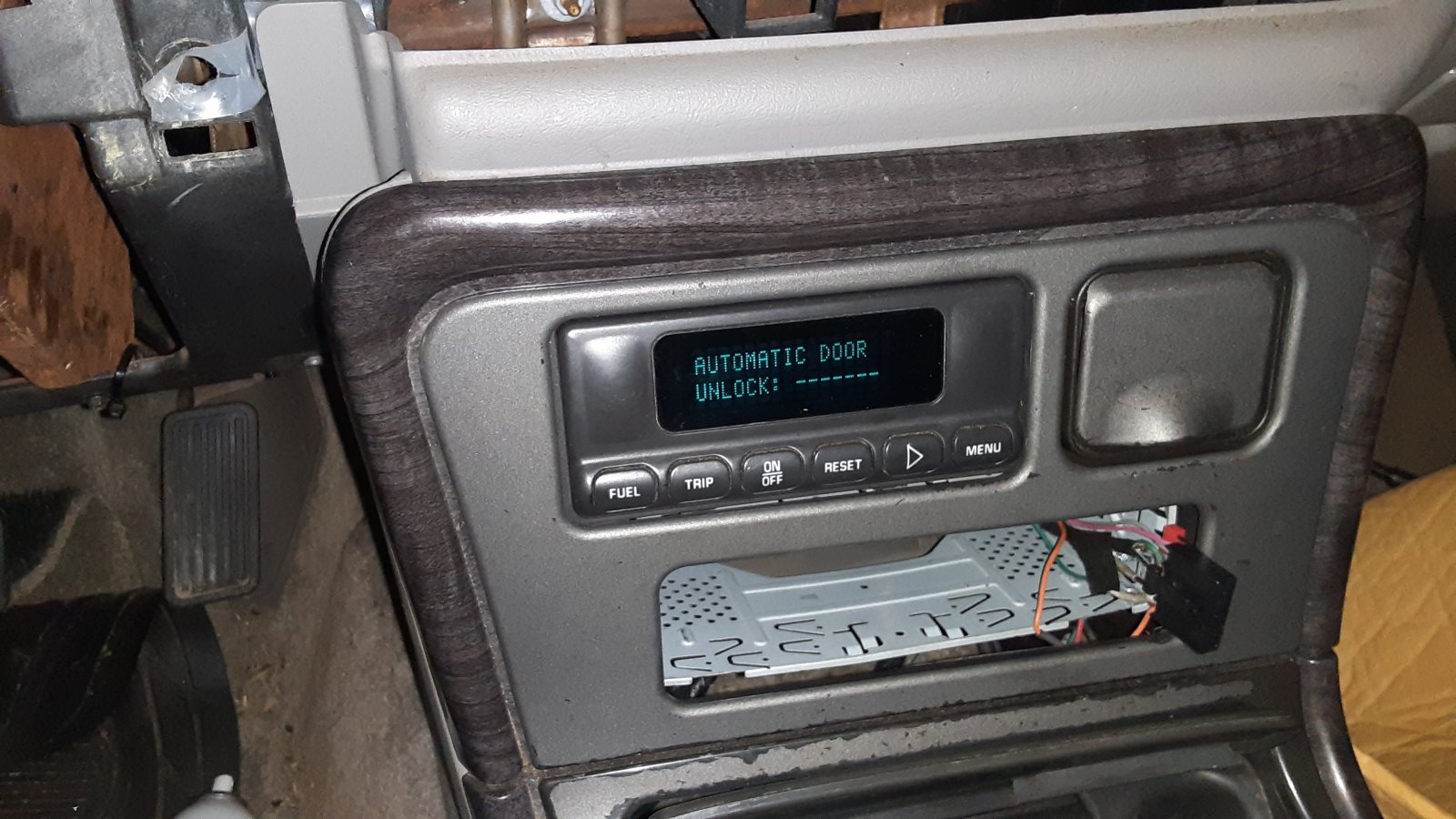

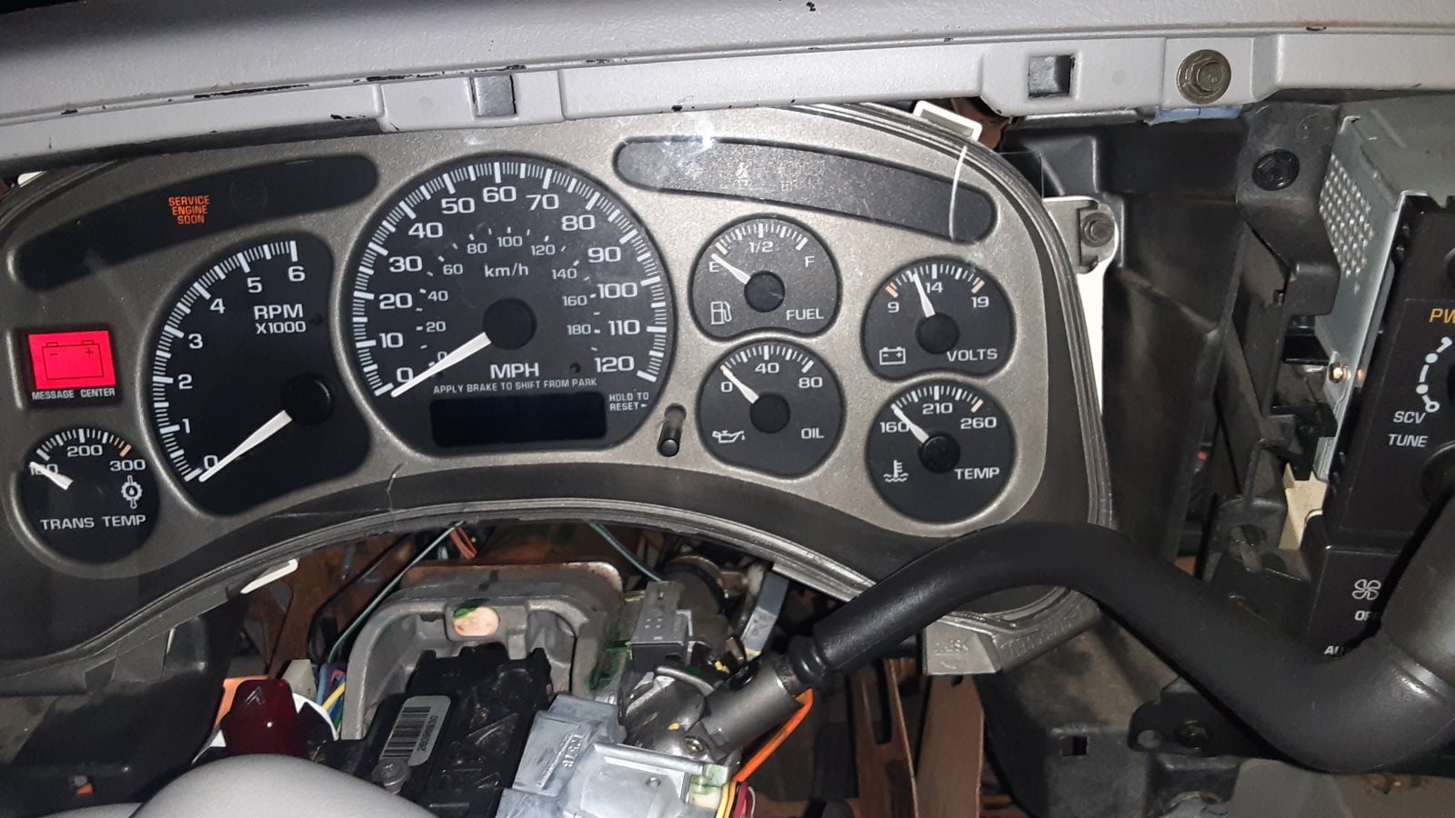

Hey guys I have a 2002 Yukon XL Denali and I can't get it to start. I think it has something to do with the VATS but I have replaced the lock housing and cylinder. Also the temperature and the fuel gauge are not working and the radio's not working and some of the options on the DIC have lines in them so you can't edit them. Also the PRNDL lights come on in every position except run and all the the DIC options work in accessory. I've cleaned the 2 grounds behind the engine and the 2 on the frame on the drivers side. Nothing's working. I've been over the wiring extensively and I haven't found anywhere that one is shorting out. I attached a video of the problems if it helps. Any info would be greatly appreciated, thanks in advance.
