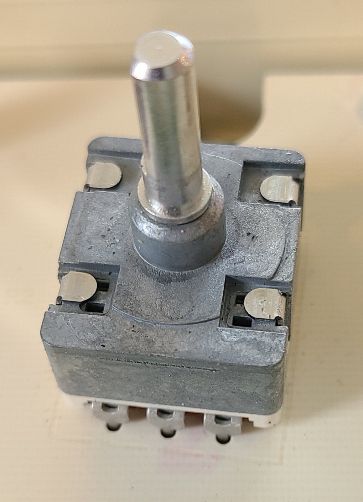

19
Manitoba, Canada
this is the switch inside the module. We're you suggesting that I open it to clean it or were you thinking of a different setup?
