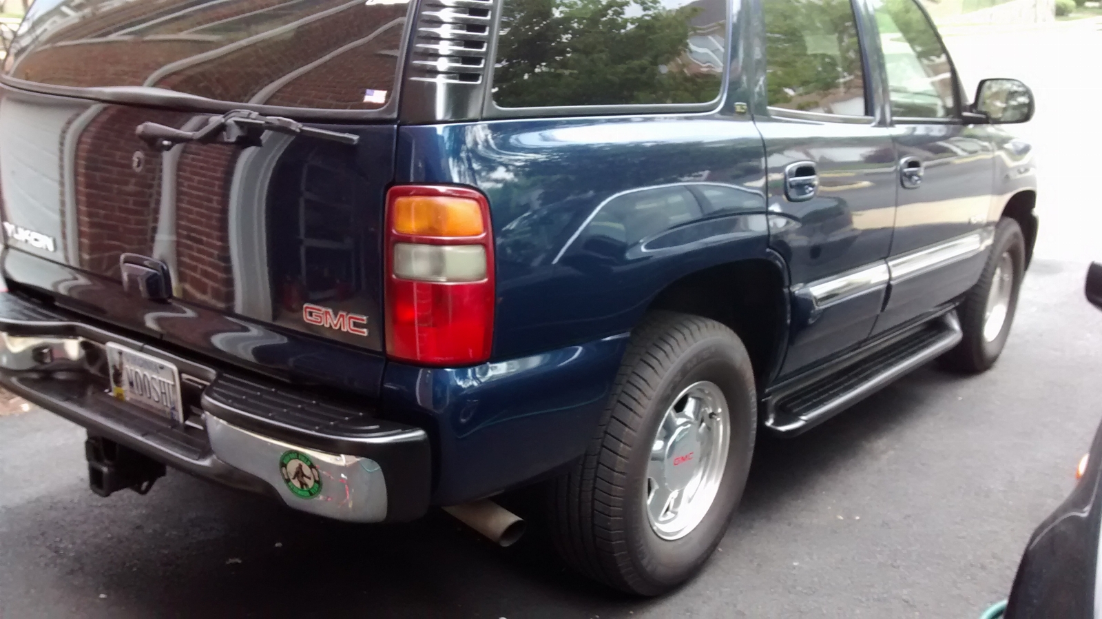

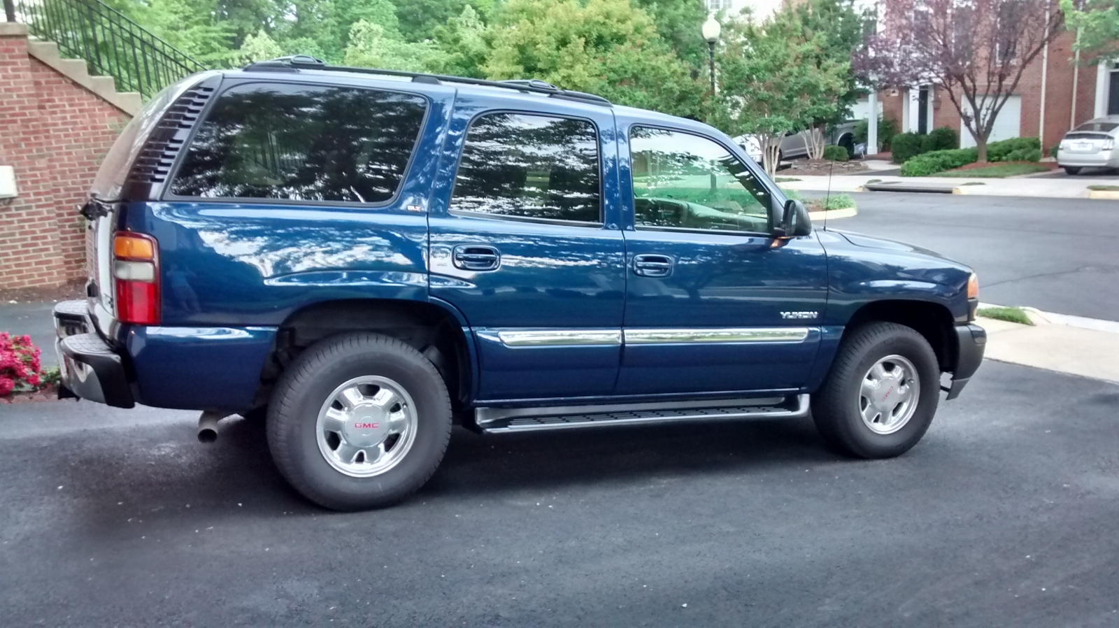

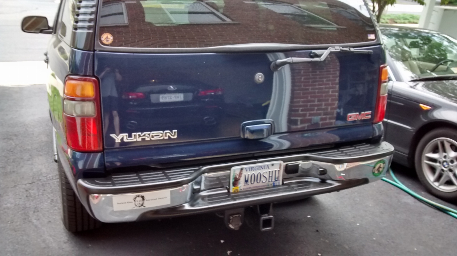

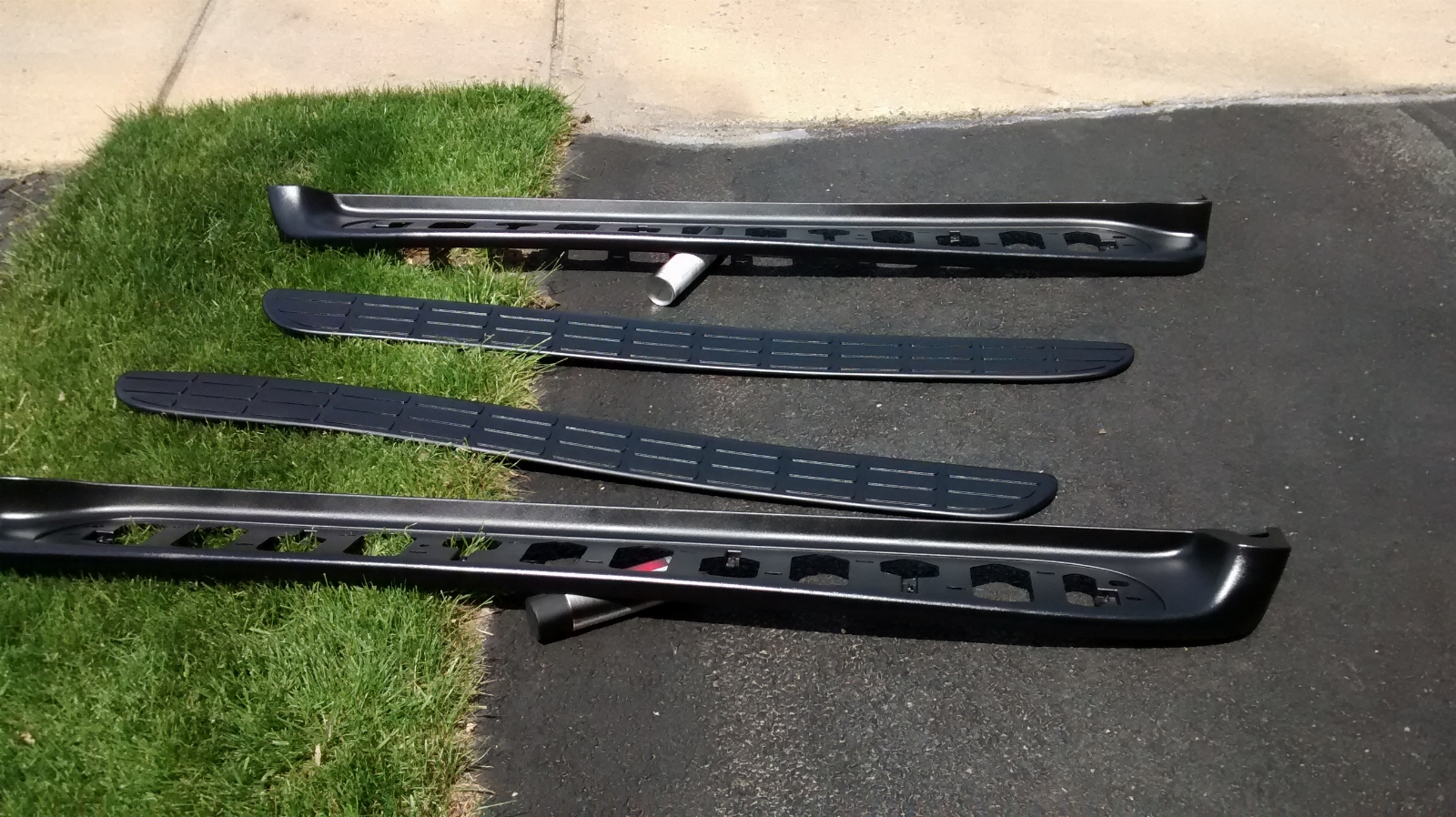

I decided to remove ALL the trim and paint it. I mean, the roof rack turned out great.
I also undercoated the wheel wells. Those were full of faded gray plastic and really helped to show how old the Yukon really is.
Faded wheel well:
Undercoated wheel well:
Rear trim removed. Remove the spare tire to do this and be patient. What a ******* pain the ass. I took my time and didn't break any of the plastic clips. On the portion below the license plate wedge a thin screw driver between the plastic and chrome and push down on the tap to clear the upper tab lip. Try to pinch from behind with pliers. Be slow.
Remove the step trim. Stupid me, you don't have to remove the entire step. You only have to remove the cover. I found out 1/2 the way through the first side. What you do is remove about 8 screws under the step that bolt into the trim. Be prepared for a metric shit ton of rust to fall out. I ended up spray painting the screws to help slow future rust.
When removing the rear trim I found that the prev owner had a hidden key box! Its off now.
For the paint I used this. To apply I washed, degreased, scrubbed and then rubbed down the parts with 1000 grit sand paper. Then a wipe down with a rag with some time in the sun to dry.
Step trim removed and painted, baking in the sun.
Rear trim being painted.
Finished trim. Like the roof rack, the gloss will fade a bit with time and will have a really rough and tough touch.
Rear:
Side:
Angle:
My truck doesn't look 13 years old now! :)

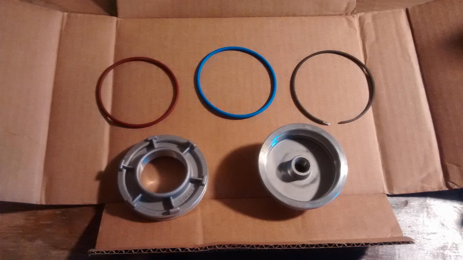

I got two new mods. First was $20. The other $650, and wifey doesn't know!

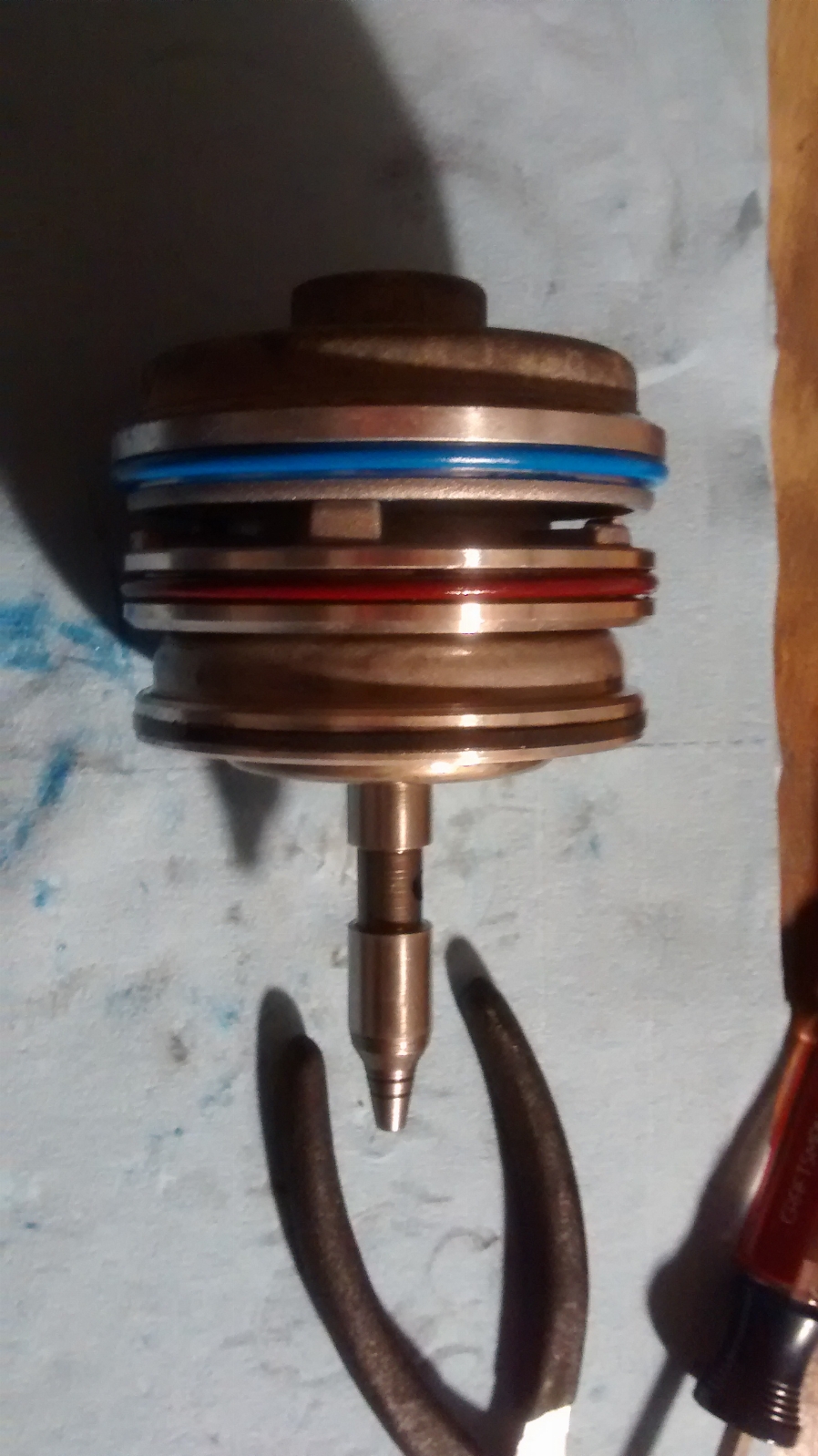

I've been wanting to clean up the shifts for a while on the 4l60e, even though its getting ripped out.
Today I installed a corvette servo. There are a ton of howtos out there. It took me a couple hours because I was stupid. I did however bend the heat shield out of the way over the passenger CAT to help get things in and out.
The shifts feel quite a bit firmer. I did suspect that the ECU mandated torque pulling on shifts caused part of the new firm/jerk on shift since while the new servo was making the shifts faster, the same timing delta applied. So remember physics? First derivative of velocity is acceleration, second derivative of velocity is impulse, or rate of change in acceleration. This faster shift (delta T) with the same total loss of power/speed from torque management caused a higher impulse (also known as jerk), or what I sound like now!
For $20 I recommend this upgrade!!!
Pics of parts.
Looks like a metal hamburger....

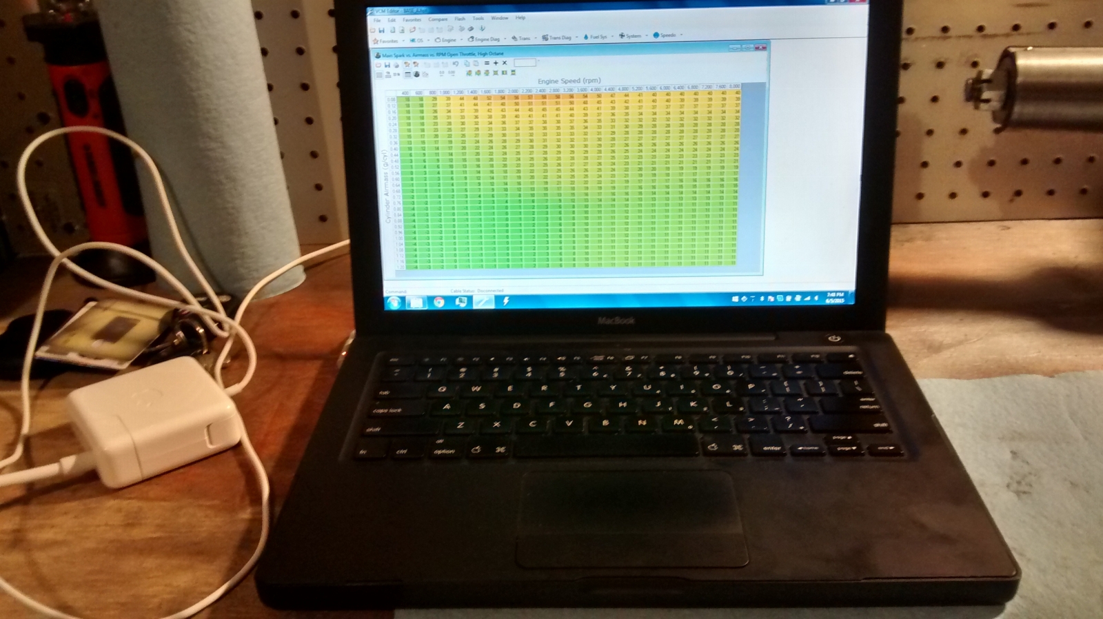

$650, full tuning suite. I wrote my own tuning suite, but don't have time to hack communications, maps and other shit with the Delco ECU. I gots real work to worry about!
I found a reputable 87 octane map, reduced shift torque loss, upped timing and leaned out the fuel a tad. I still need a wide band sensor.
WOW!
She ain't super fast, but she moves a ton better than before!! Power doesn't fall off on shifts, shifts are smooth and firm, and the power just grows with RPM! I'll have to log a ton to verify but so far I'm happy :)
