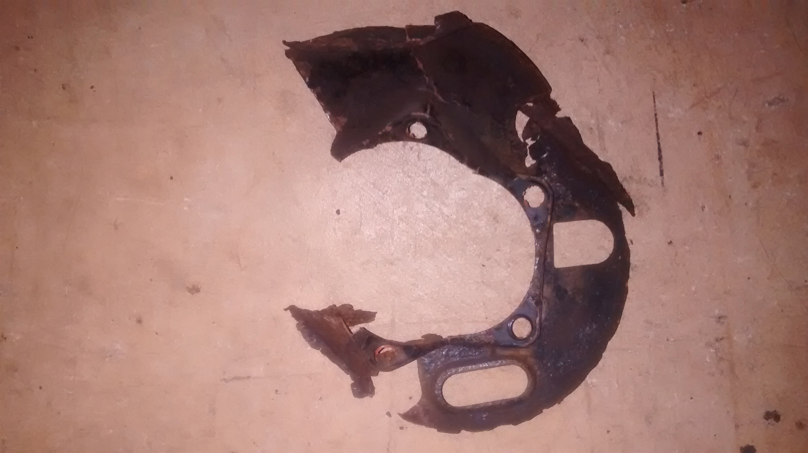

Did drivers side rear dust shield. It was OK before the winter. It turned to a rusted ************* by now. I used the other dorman two piece part. No need to remove axle shafts. Just grind off the stock part.

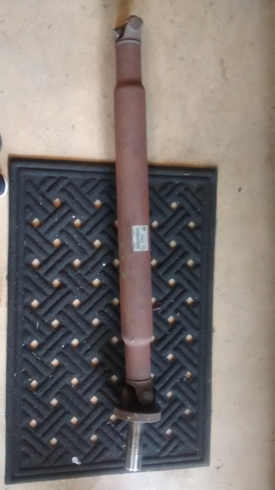

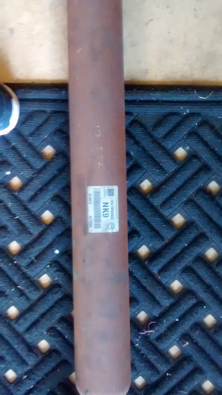

Got the Cali drive shaft in hand. If you're not on the east coast you won't understand how beautiful it is! My stock one is bumpy with Rust.
---------- Post added at 09:49 PM ---------- Previous post was at 09:48 PM ----------
Closer. I want to lick it.

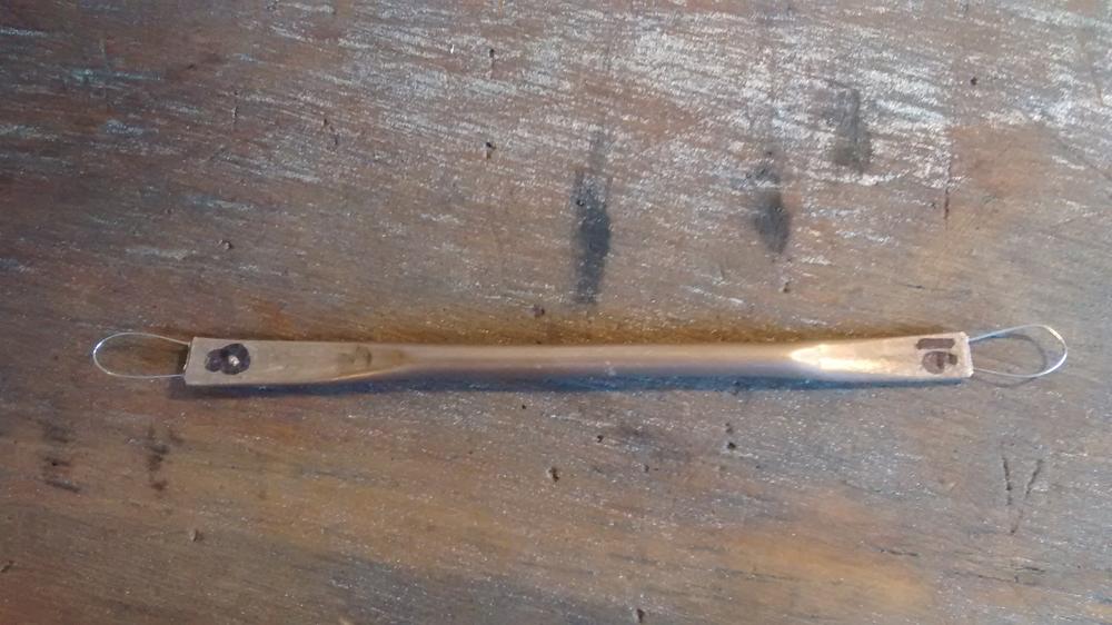

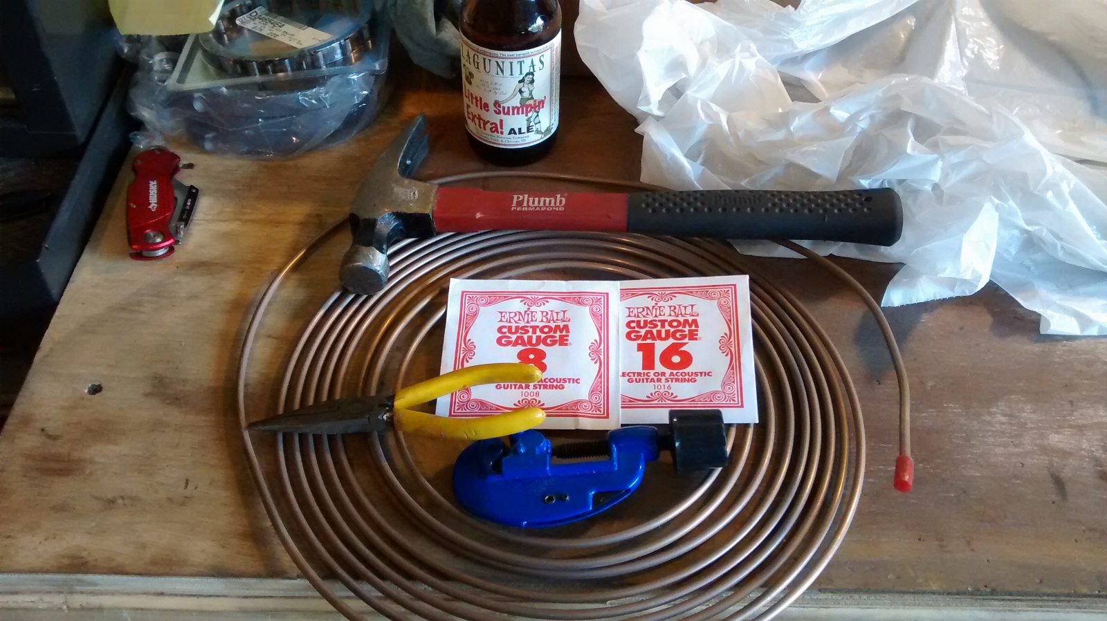

Made a lip seal tool for my trans.
