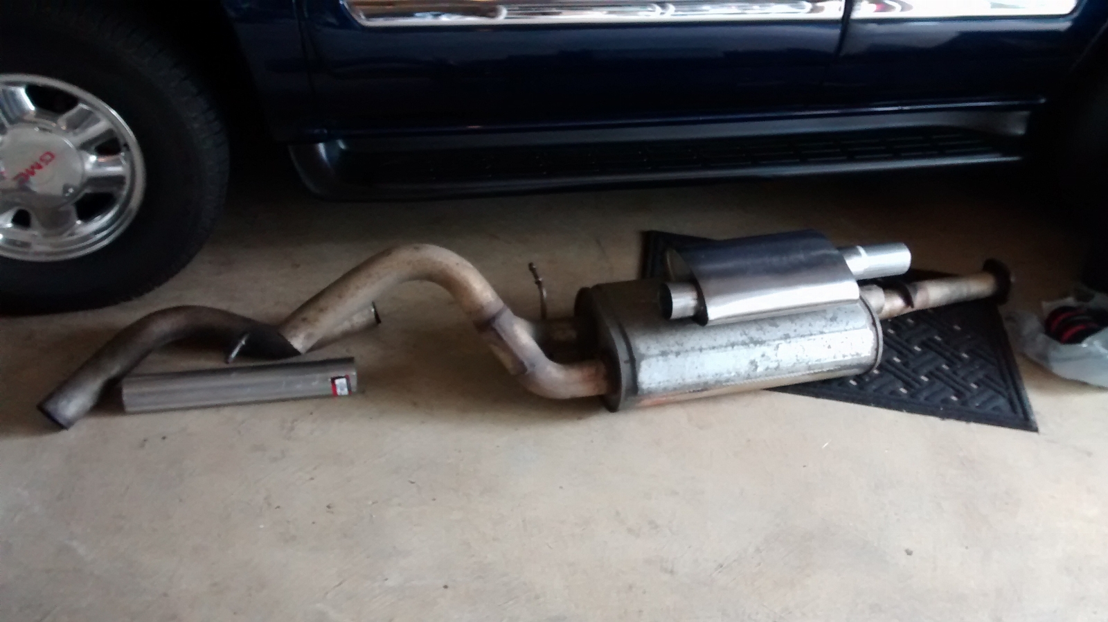

I should really read up on things before starting. I didn't realize I needed to cut the old exhaust out.
Oh, and y-pipe to catback manifold studs both snapped off after soaking in PB blaster. The drill bit I had was too dull to drill out the studs. Also the exhaust hangers are toast. The metal inside them is just rusty dust now :emotions122:
East coast problems. :)
Here I was "laying pipe" on the ground to see how I'll do things.

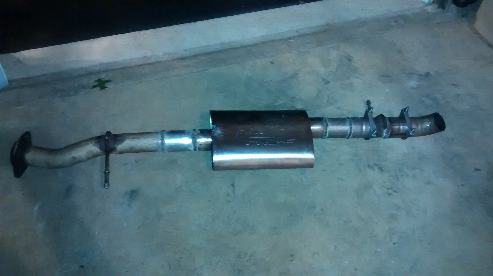

I had an hour and hacked up the stock exhaust and other pipes in prep for the final welding. I also ground off sharp edges and whatnot.
Stupid old muffler is big and stupid.
---------- Post added at 09:07 PM ---------- Previous post was at 09:06 PM ----------
Here are the pieces laid out.

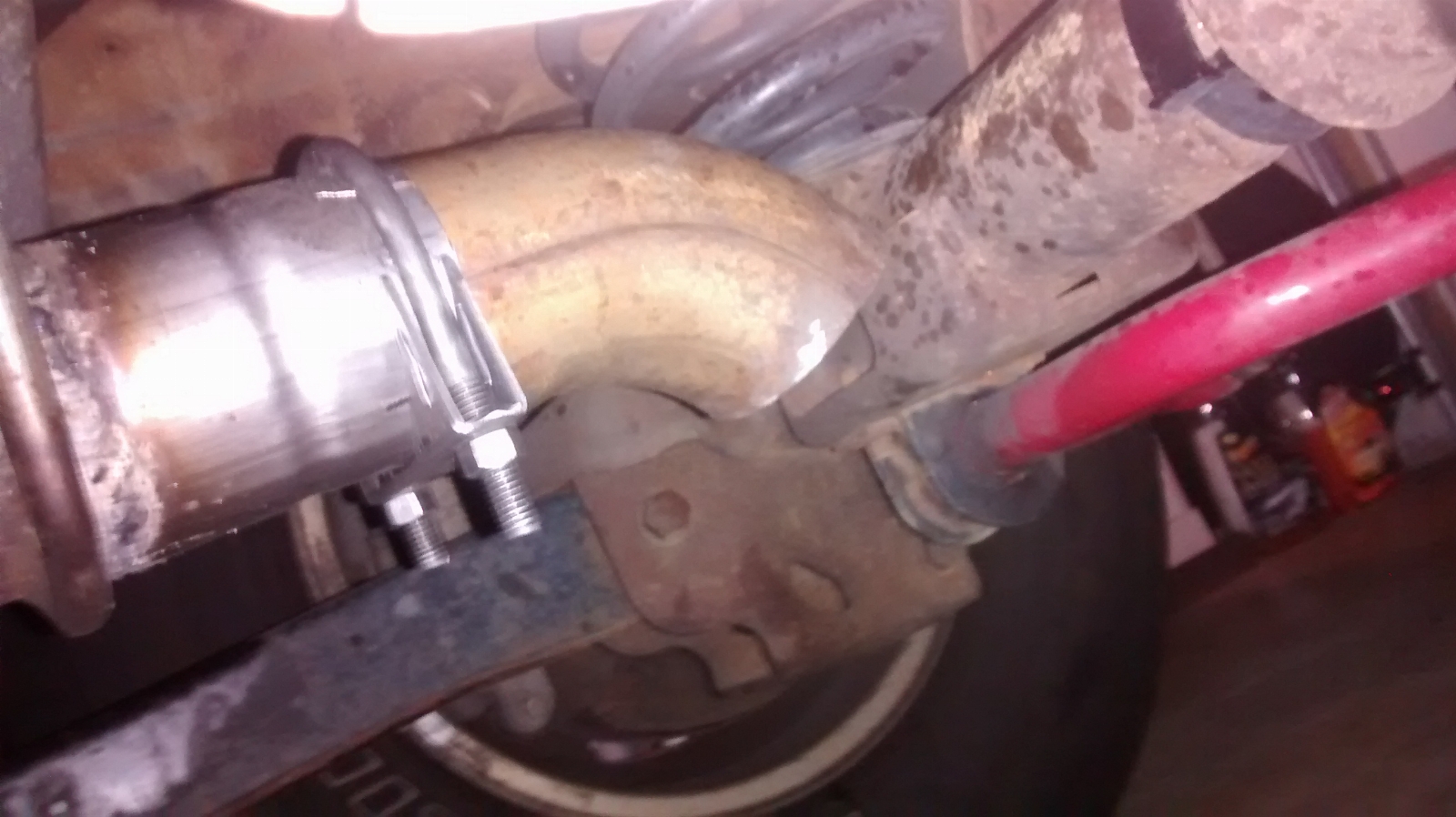

We have a huge storm moving in soon. I wanted enough done tonight to get my fancy car in the garage.
I had a ******* ***** of a time trying to connect the last 1/3 of the stock exhaust. I gave up and put a dump on the end. I was still worried it would heat things up.
Uhhggg, test drive sucked. Sounded like shit. I need to finish routing the exhaust. The whole cab vibrated at times.
Am I getting old? Sigh.... I never thought a V8 would be too loud. Back at it tomorrow.
Quick dump added.
---------- Post added at 11:50 PM ---------- Previous post was at 11:46 PM ----------
I did not like this before the test drive. As I suspected after the drive the sway and axle were too hot.

Just stitched together the cut apart tail pipe. I'm still not good at welding.

Done.
---------- Post added at 04:19 PM ---------- Previous post was at 04:16 PM ----------
It's very quiet at idle, screams when truck is floored. No drone now.
