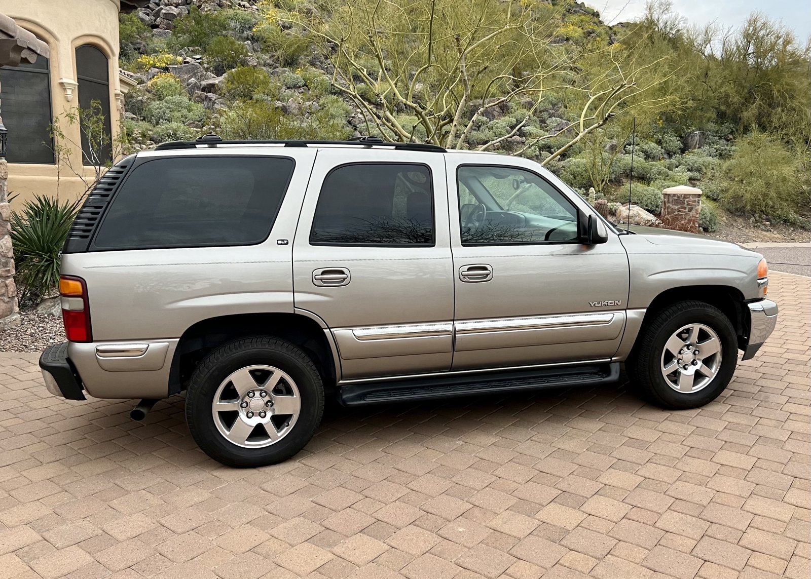

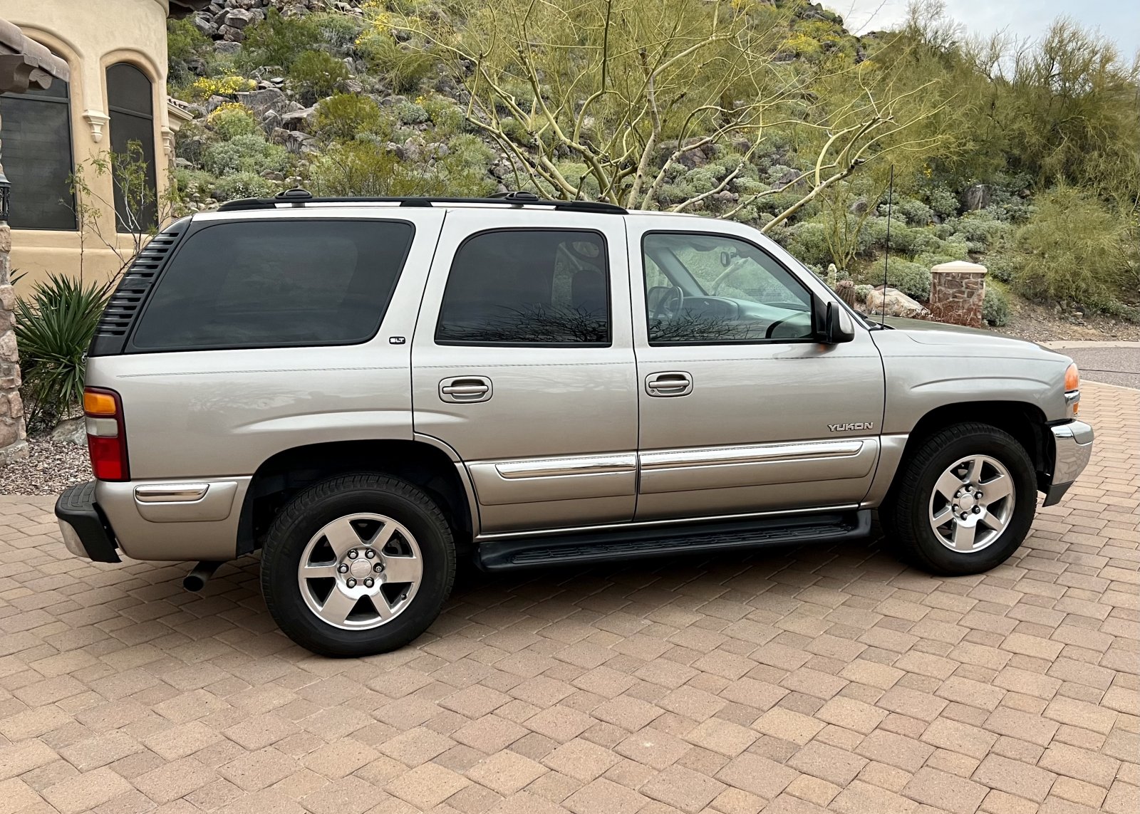

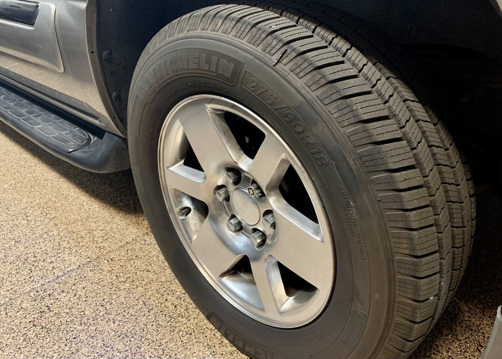

On my 2001 Y-SLT 4WD I replaced the OEM chrome steel 16’s with mint ole’ skool machined aluminum 18’s, and Michelin Defender LTX 275/55-18’s. Got a good deal on the wheels … tires cost 4X the price of the wheels! To me this is the ideal rugged road cruising setup. Diameter is a near-perfect match by math and speed measured by GPS is dead-nuts match vs dash speedometer once the rubber wears down a little.

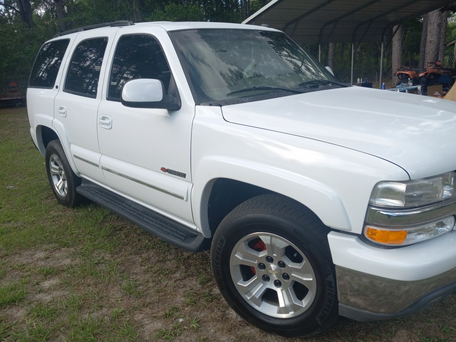

I use Tire Size Calculator they show side but side and rpms, Marky is that backwards? I'm running 265 65 18 and they are same as 265 70 17 no rubs.

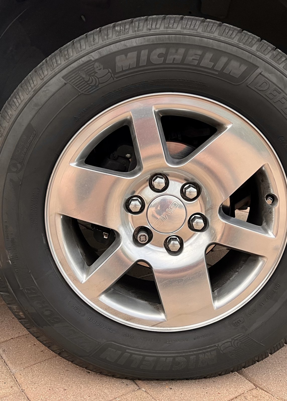

I upsized my 2001 from 16” to 18” wheels and 275/60R-18 tires and the speedometer is absolutely dead nuts on, measured with GPS.
