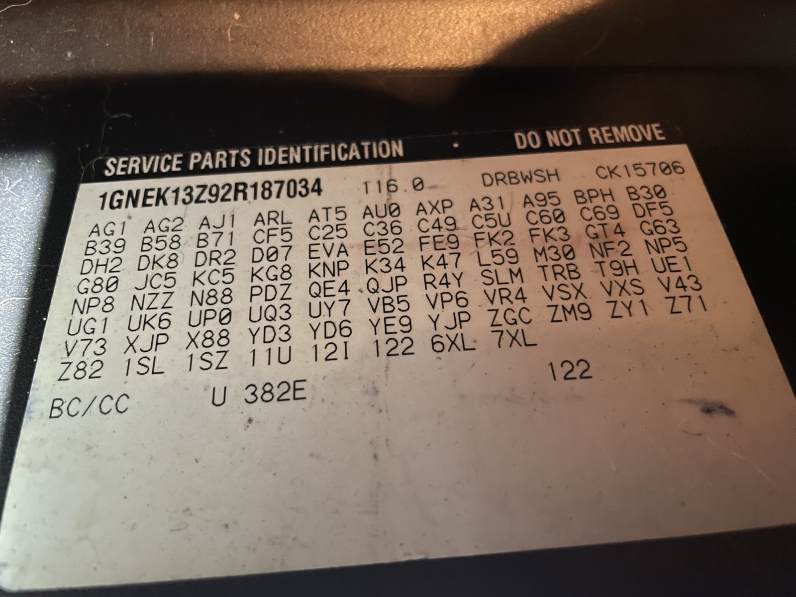

I have the G80 rear diff according to my sticker.
