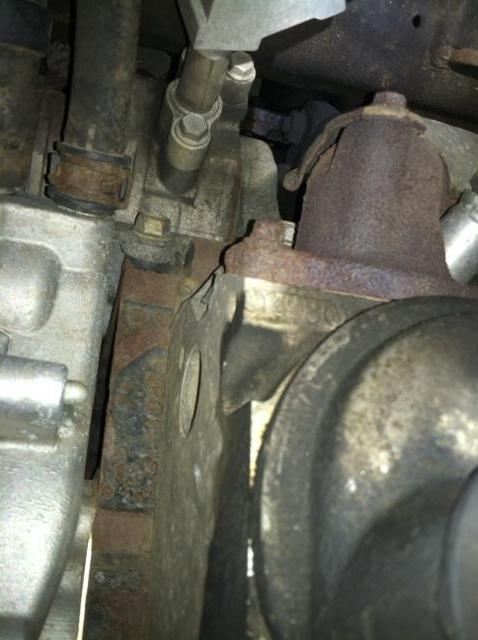

My 2002 yukon 5.3 with 236K miles has begun to loose a little coolant over a few weeks or so, about an inch in the resevoir for every 1.5 to 2 weeks. I have been researching the issue, and it seems like the 706 castech heads have been causing what i have been experiencing. I pulled the oil filler tube and it looks clean with no signs of coolant and from the valves i can see there is only oil, no milky mixing. Are my heads the good heads from this photo, there is an 862 stamped to the bottom right of the filler cap.
Next guess would be head gasket, but would there still be pressure released when opening the resevoir cap after 14 hrs or so from starting if it was a head gasket issue? I dont want to dump much many into this high mileage truck, so im thinking of using one of the stop leak products. Would that Bars Stopleak product, or the oem GM tablets be best? THe waterpump has also been replaced and i have looked all underneath the engine for any leaks, and there are none. There is also no signs of coolant in the oil and no loss of oil after 3K miles.
