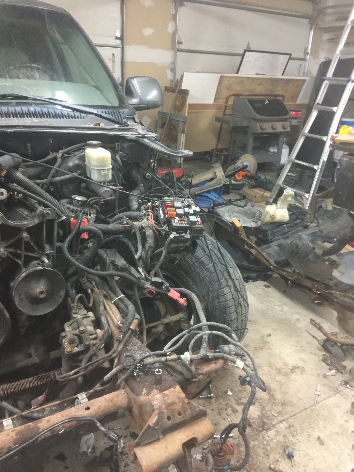

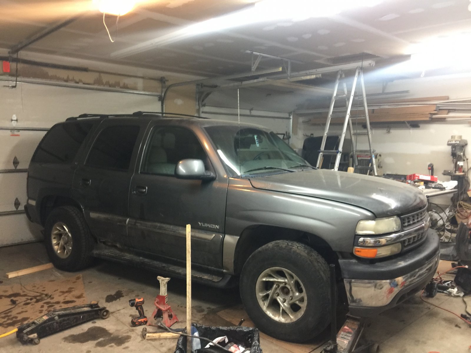

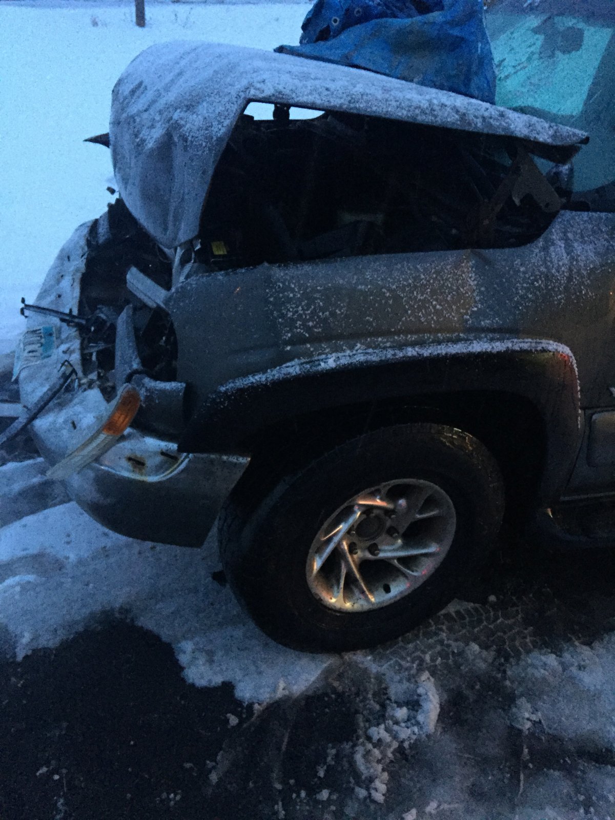

The collision wasn’t to bad but the radiator was pushed into the flywheel and just left the nut attached. Both air bags went off and the fuse box was cracked but just the case. I think it looked worse then it was but just stuck on finding the answer to why the engine can’t run on its own.
Any help would be great! Just haven’t found he answer on the internet that would match the situation we are in.
Thanks!
Easton

Check the ground wire that attaches at the driver side radiator support mount pad or the one on the drivers side engine block to the fuse box.
