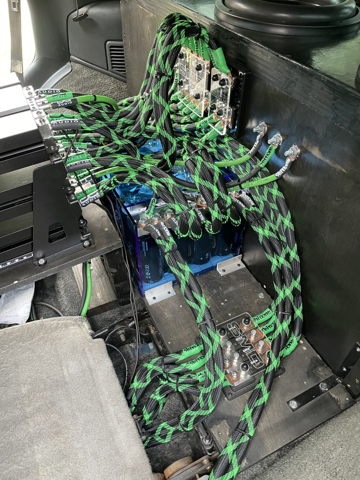

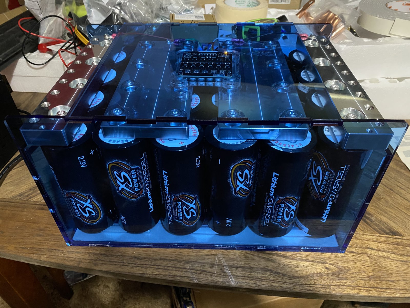

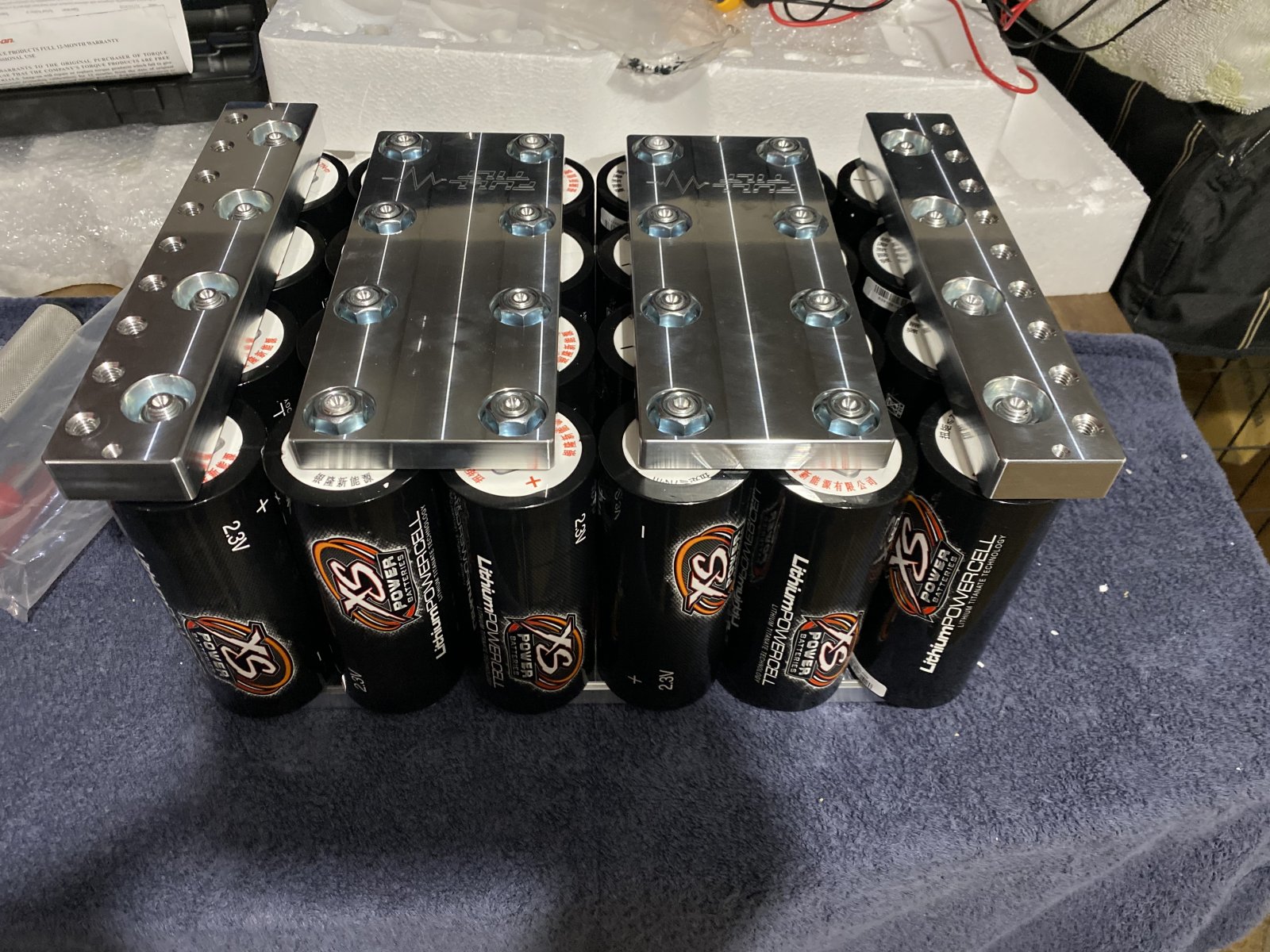

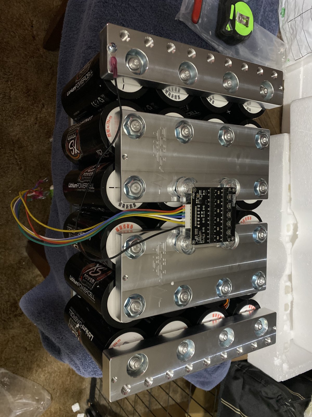

After waiting a full week for hardware to finally show up I got the bank assembled and it was sitting at about 13.6v. Got the balancer connected and charged it to 15.6 in prep to go into the Tahoe. View attachment 273878View attachment 273879View attachment 273880

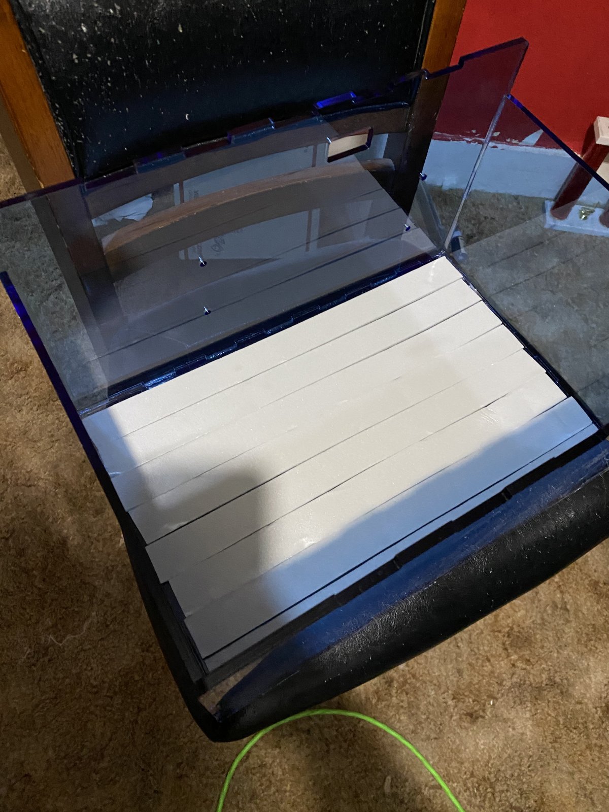

Since I do have the battery in front of the sub box it will see a lot more vibration so I put a layer of canopy foam at the bottom of the battery case and underneath the battery case as well.
Got the battery in the case and I’ll tell you what it’s not the lightest to try to gently put into an all acrylic housing hahaha

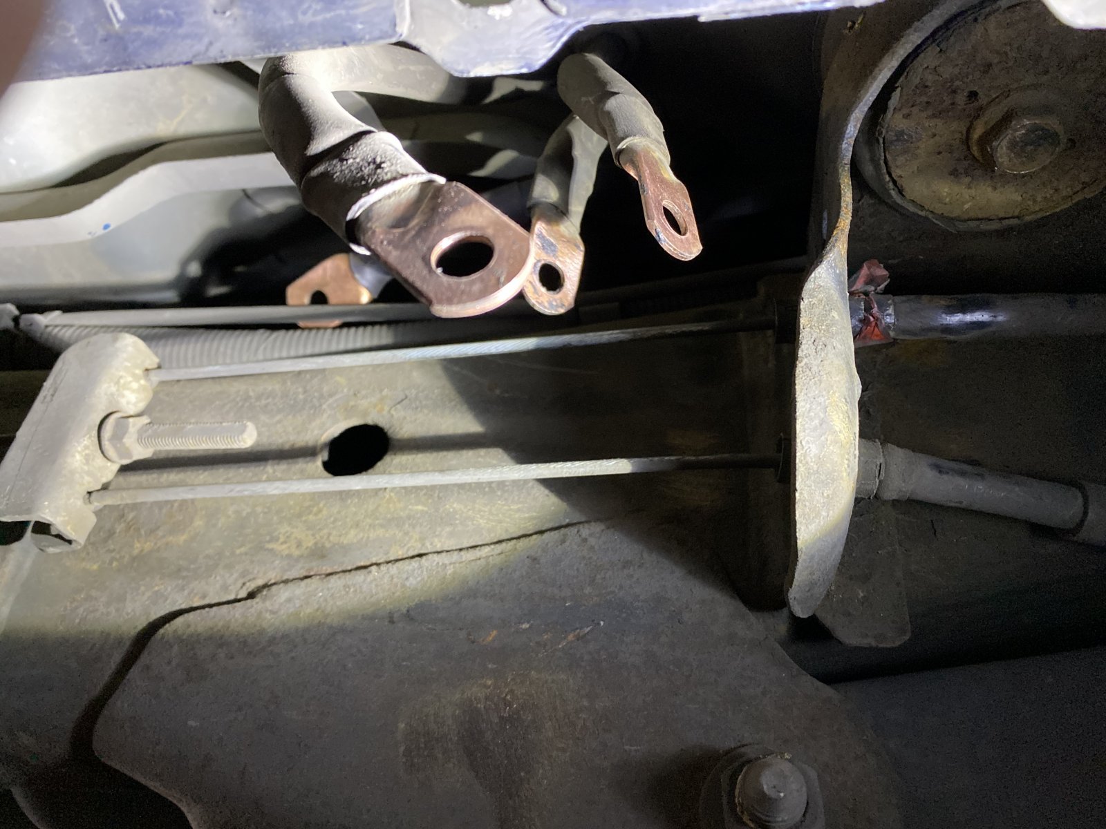

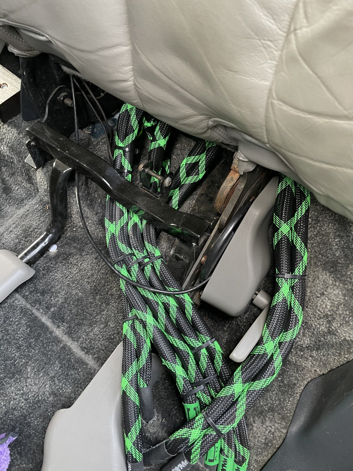

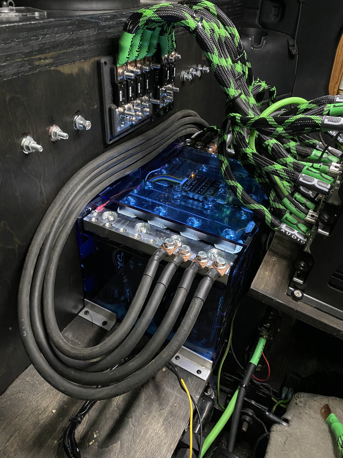

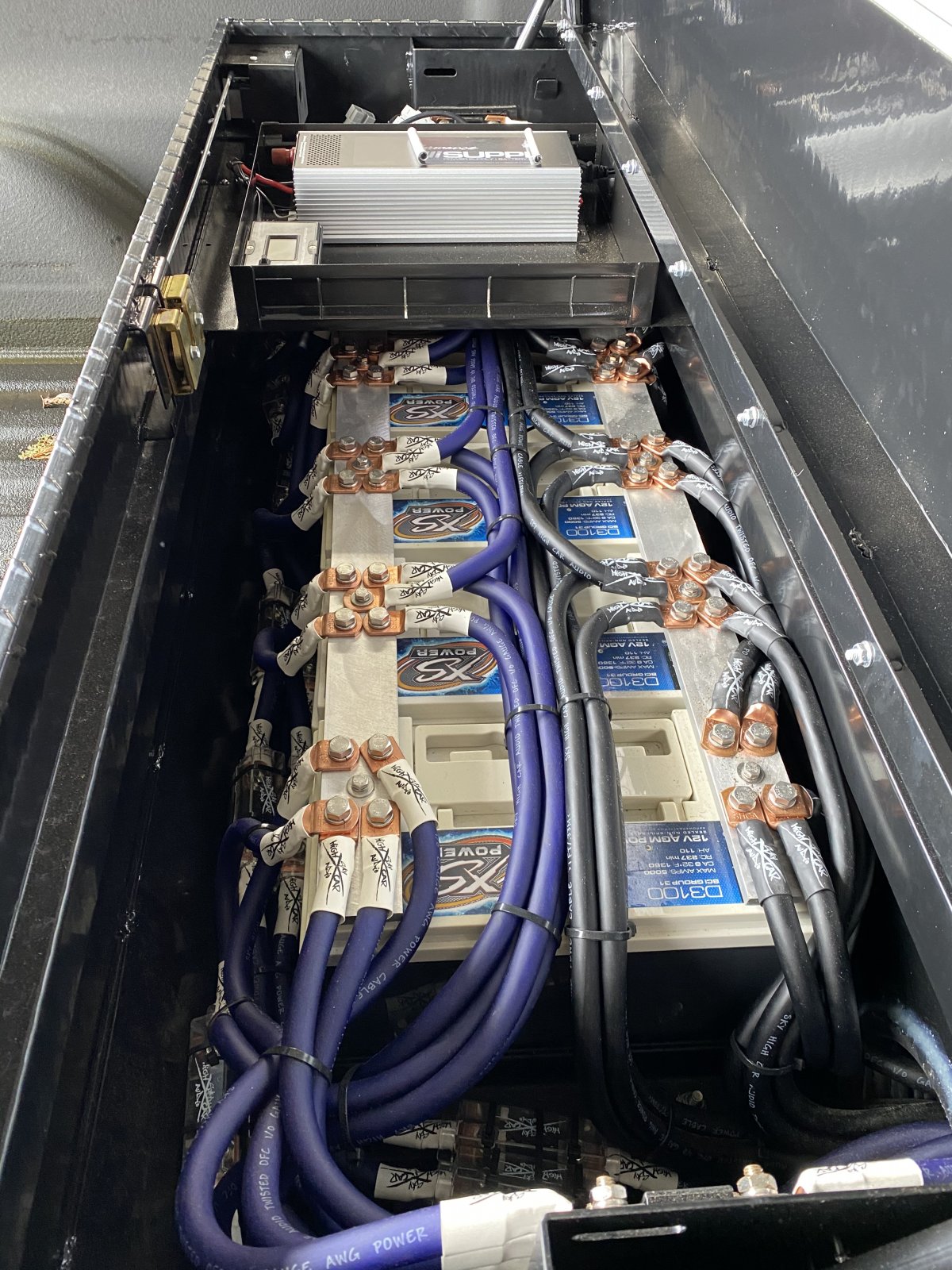

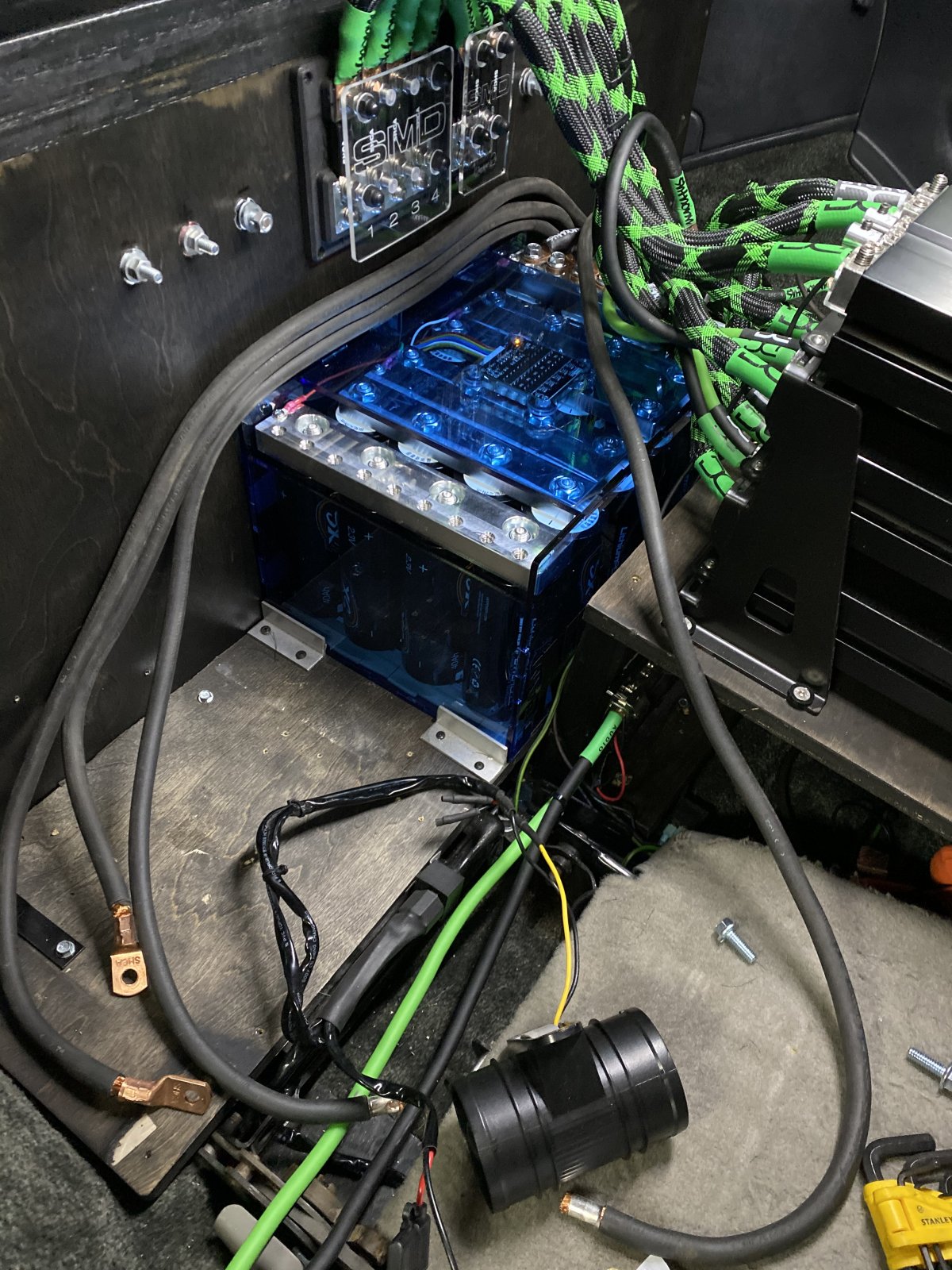

First item was to move a ground from passenger to driver side then while I was under there I re cleaned all the frame grounds and re installed.

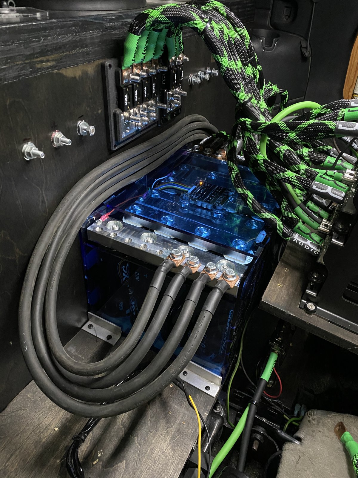

Luckily between my scraps and my buddies scraps of wire I had enough to redo everything. Since the limitless sat on its side with the power and grounds facing the front horizontally I had everything wired specifically for it. So I had to redo pretty much everything besides the amp power wires that are attached to the fuse block. I ordered more tech flex so once that comes in next week I’ll pull those 4 power runs and get them wrapped then I’ll be able to toe and organize all the wiring so it’s pretty and suits my ocd.

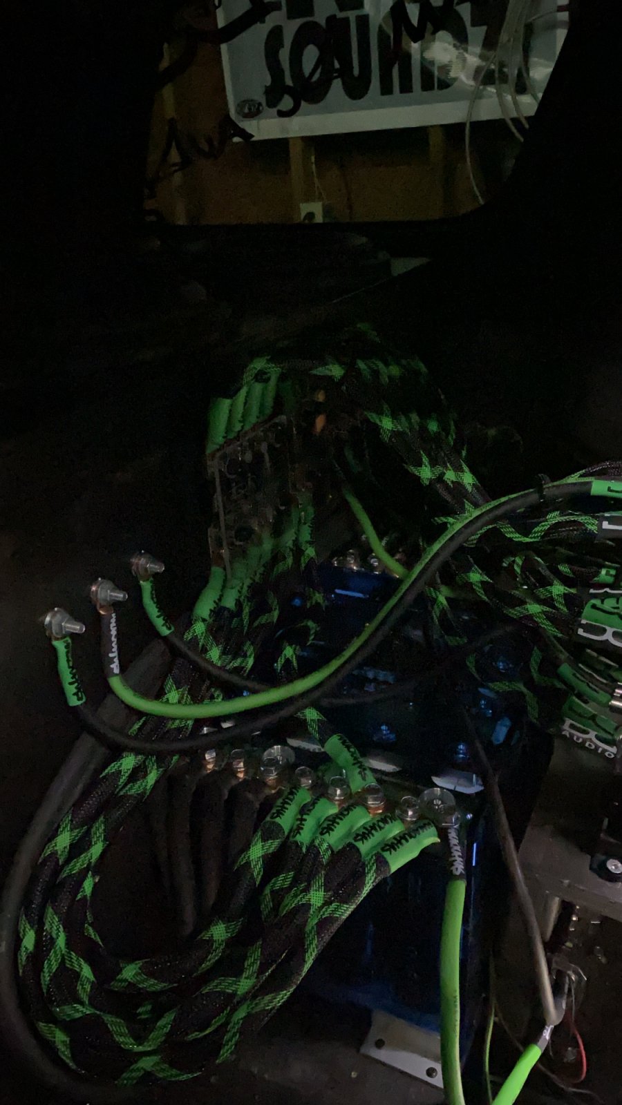

Wiring is finished!! 2FF13A76-2E22-4702-9886-81245A2C46A9.jpeg DB09767A-17EF-4C8C-842F-EBFAEF2D9428.jpeg

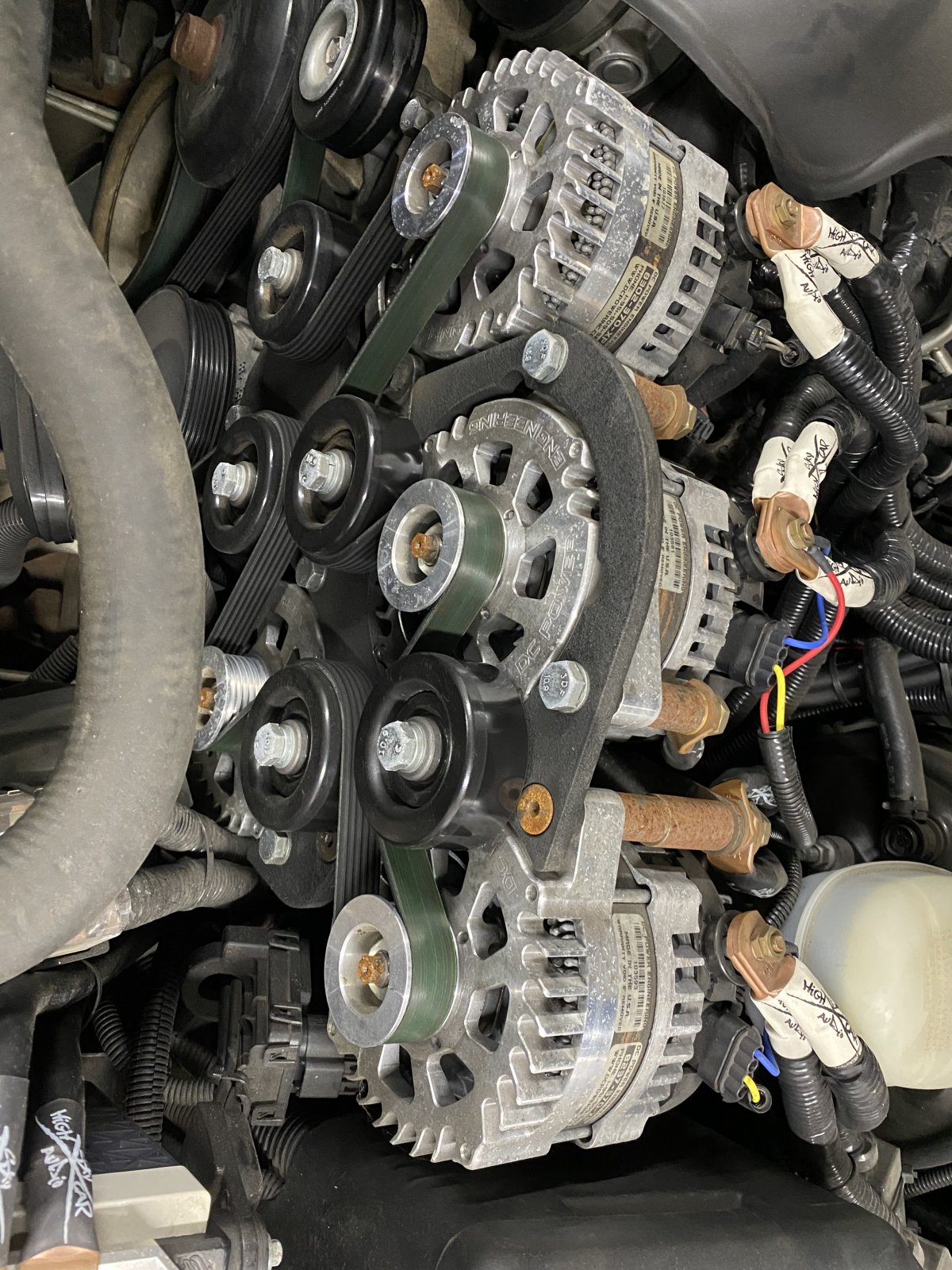

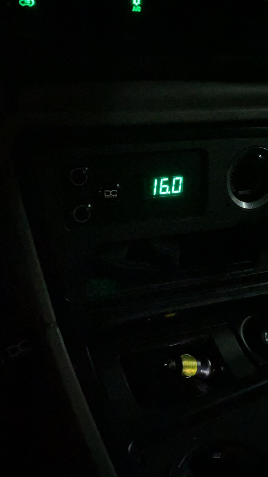

I messed up on that last post with picture order lol. Got the mechman H104L harnesses connected to bump the voltage up. And it worked as you can see in the last post voltage cold is sitting at 16 then once it warms up it has been sitting around 15.5-15.8 which is perfect. It’s insane being able to play my stereo at 12000+ watts with one battery and not drop below 15v!

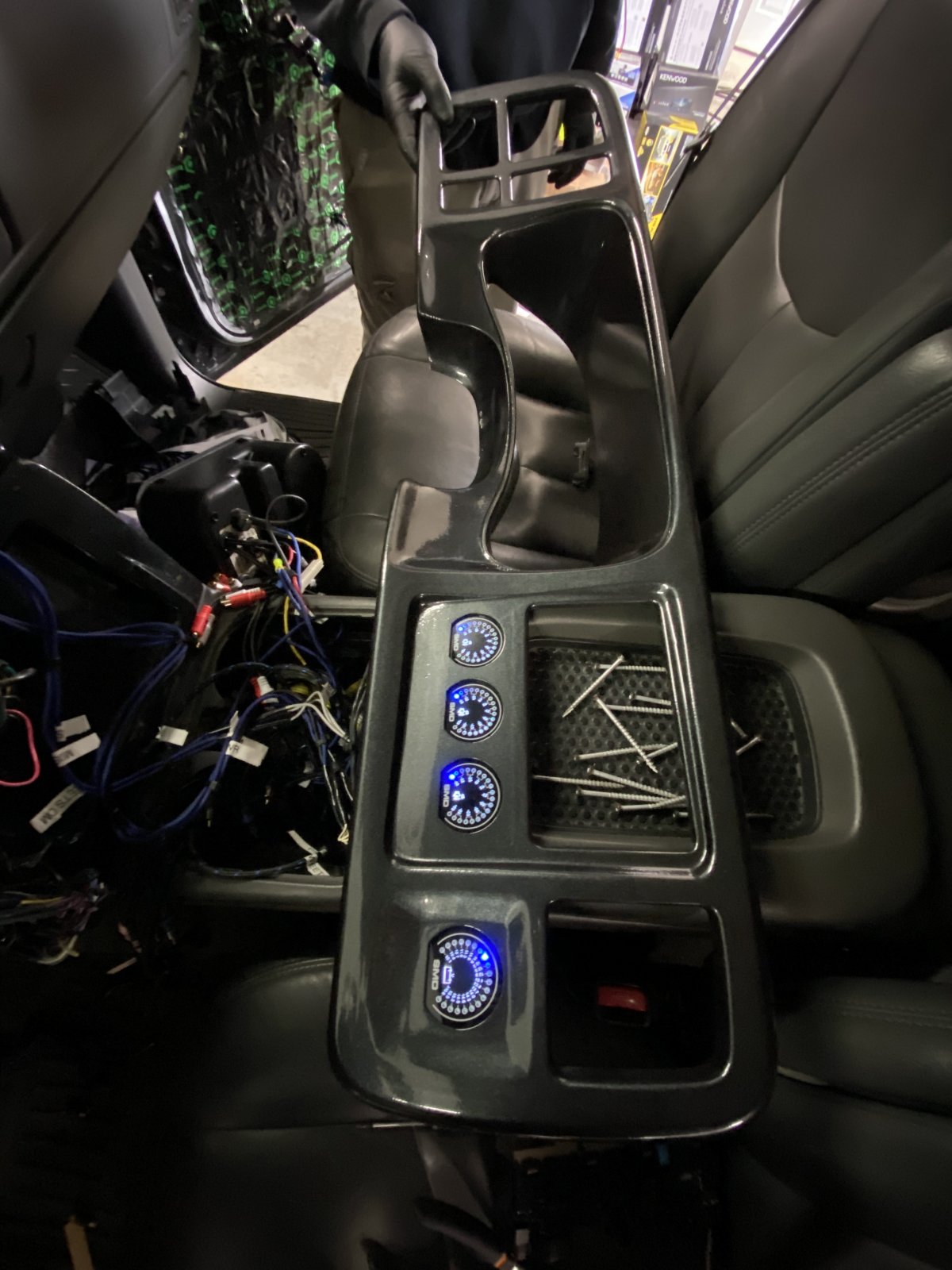

Took a few pictures of the equipment in the denali I don’t know why I didn’t think to take pics of the whole truck it was insanely clean though. I had seen it back at 2017 at a show but hadn’t seen it again until today. I know some of it looks messy but he is in the middle of returning it to factory. The build quality and integration of the smd meters in the dash plus the iPad for the 03-06 console made me wish I had a 03-06 console for mine.

I think the wiring just looks that much crazier because the only thing differentiating the power and ground is the heat shrink color on the ends so it blends together lol.
I got most of it tied off and managed now so it looks a little better

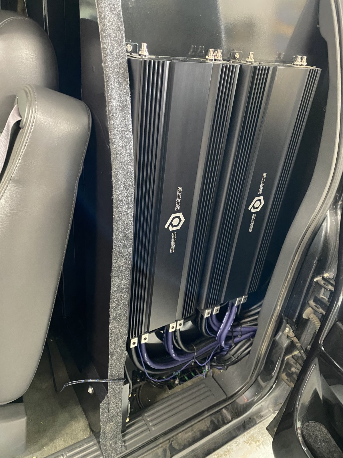

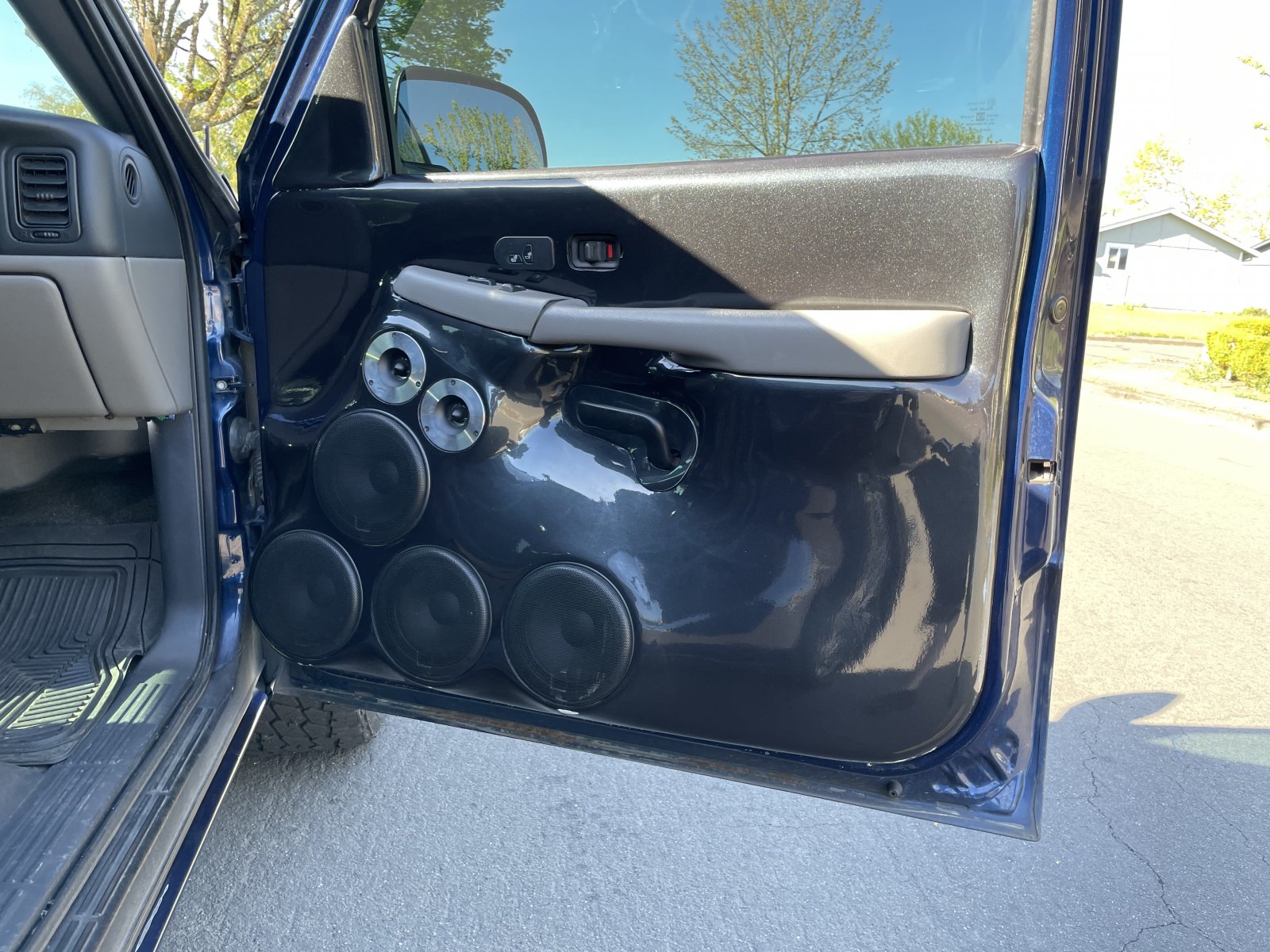

Friday after work I got two more runs of speaker wire to each door, got the second DC 90.4 4 channel installed under the rear driver seat, and both panels installed after putting my handles and switches on them from the stock door panels. The speakers that are in these doors are super cheap pro audio speakers. Like 40 bucks a piece cheap. They are surprisingly clear though and holy crap they scream. I have maybe 60 watts going to each speaker currently and it’s more than enough. Hopefully sooner rather than later I’ll have the funds for the DC carbon neo 6.5s. One ****** thing about it is now I have 8 speakers to buy just for the front doors so it adds up quick haha. These panels are pretty heavy and after this season I’m gonna try to sand some weight off of them and wrap them to match the factory charcoal panels/dash but I’ll keep the handles the light grey I really like the two tone.

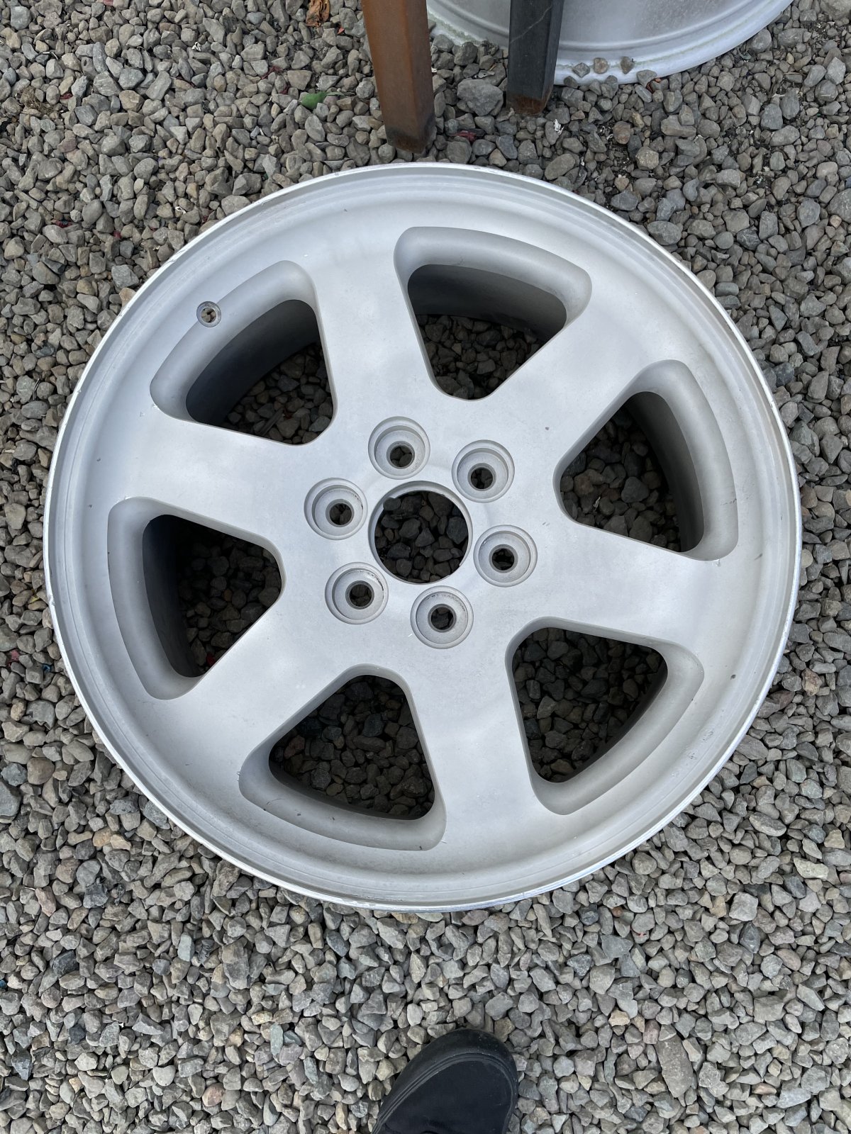

Well I need to learn to not tell people that I’m in no rush. Cause I was starting to get a little antsy. Almost 3 months later I finally get ahold of the local tire shop I had fix the wheel. They got it done. It was only 30 bucks so I can’t complain too much I guess. Picked it up and back to the powder coater it went
My powder coater got the wheels busted out already. We went with alien silver and a clear coat on top. I’m pretty stoked on how they turned out I wanted just a oem plus color. Something that’ll be easy to sell if I decide I don’t want to keep them. But this has a lot of flake in it which really pops in the sun!
Those center caps probably won’t be going on. Just had them and figured I’d see how they look 69FC7D7B-CAC4-462A-AA36-1E20869F09FE.jpeg

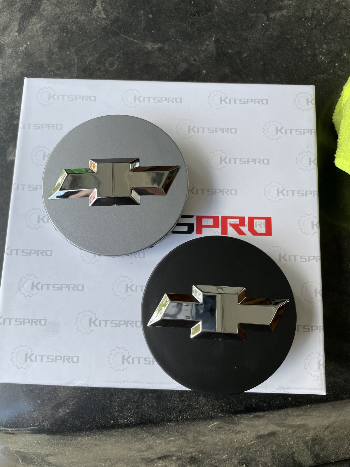

Ordered these black center caps months ago. Didn’t like them against the silver. Found some wrap that is very close to the alien silver. Much better
Took off the open ended lugs and put on chrome close end ones. Installed the center caps. And put some tire shine on. Much much better. I can live with this look and it’s starting to grow on me more.

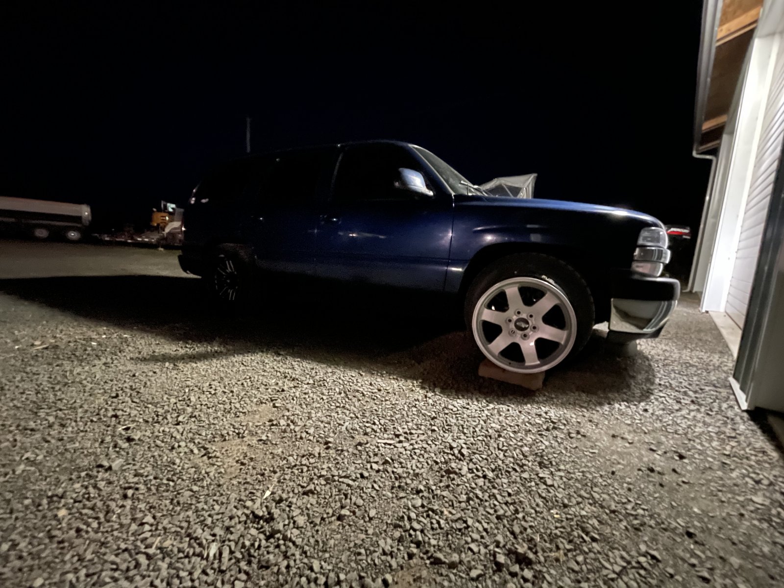

Let the air out of the rear helper bags to about 5psi and it dropped the rear a 1/2 inch. Decided since I’m gonna be inside the wheel Wells now that I need to go a little lower. So 5” drop springs and front drop keys might be in the near future. This look is starting to grow on me. Which might have to if I end up waiting till July for the new wheels. Only time will tell. Grabbed a few more pics tho.
