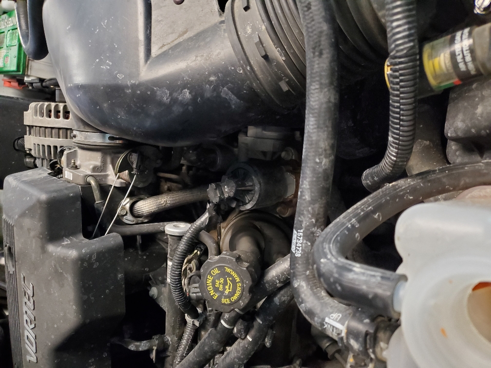

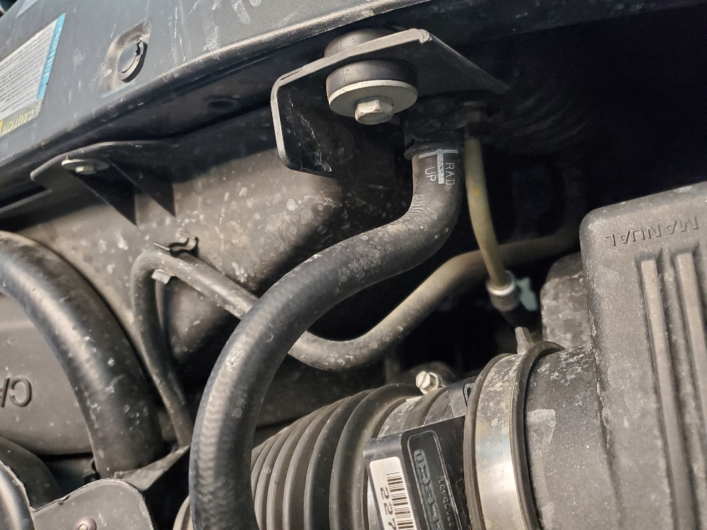

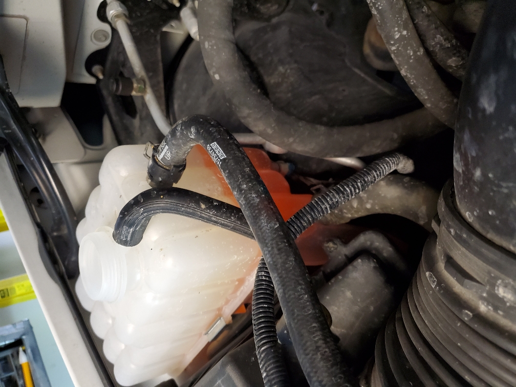

Had to do an emergency brake pad slap on the rear of the Yukon. Just pads for now till summer when i put a kit on it.
Anyhow...had time to look at the heat and check things out. It was 17F this morning and VERY Windy. Pulled into the garage and started it up and let it run for a couple mins.
After 10 mins (both heaters on low) this is where i was. Pics are attached.
What i noticed was the upper rad hose was getting warm along with the drivers side tank on the radiator. Not as warm as the heater hoses.
There is definitely a temperature difference between the 2 heater hoses. I can definitely tell that.
Those bypass hoses, is the one that goes to the overflow tank the one that needs a restriction inside it?
When i revved up the engine i could definitely see surges of coolant going thru that small hose into the top of the tank.
I do not know if the radiator is original or not. All the hoses look original for sure.
So....possibly a leaking by thermostat since the drivers side rad tank is getting warm?? Thats my thinking.
What do u guys think?

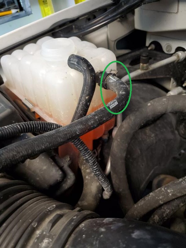

Hopefully you're running that tank with the proper cap on it. If not, all bets are off. That in and of itself could be the cause of the cool temps.
The smaller hose that goes from the radiator to the tank is the one that needs to be restricted somewhat (circled in green below). With OE radiators that's done at the radiator, but you can pinch that line down some, maybe with a small valve or hose reducer.

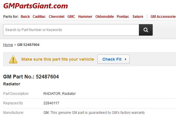

I just was looking under the hood and found a part number on my radiator
52487604
When i look that up online it is a genuine GM radiator. Whether its factory or Not i can not tell

I do think you have the original radiator. A search of GM Parts Direct for a 2000 Yukon 5.3L calls for radiator 22840117, which is what superseded yours.
