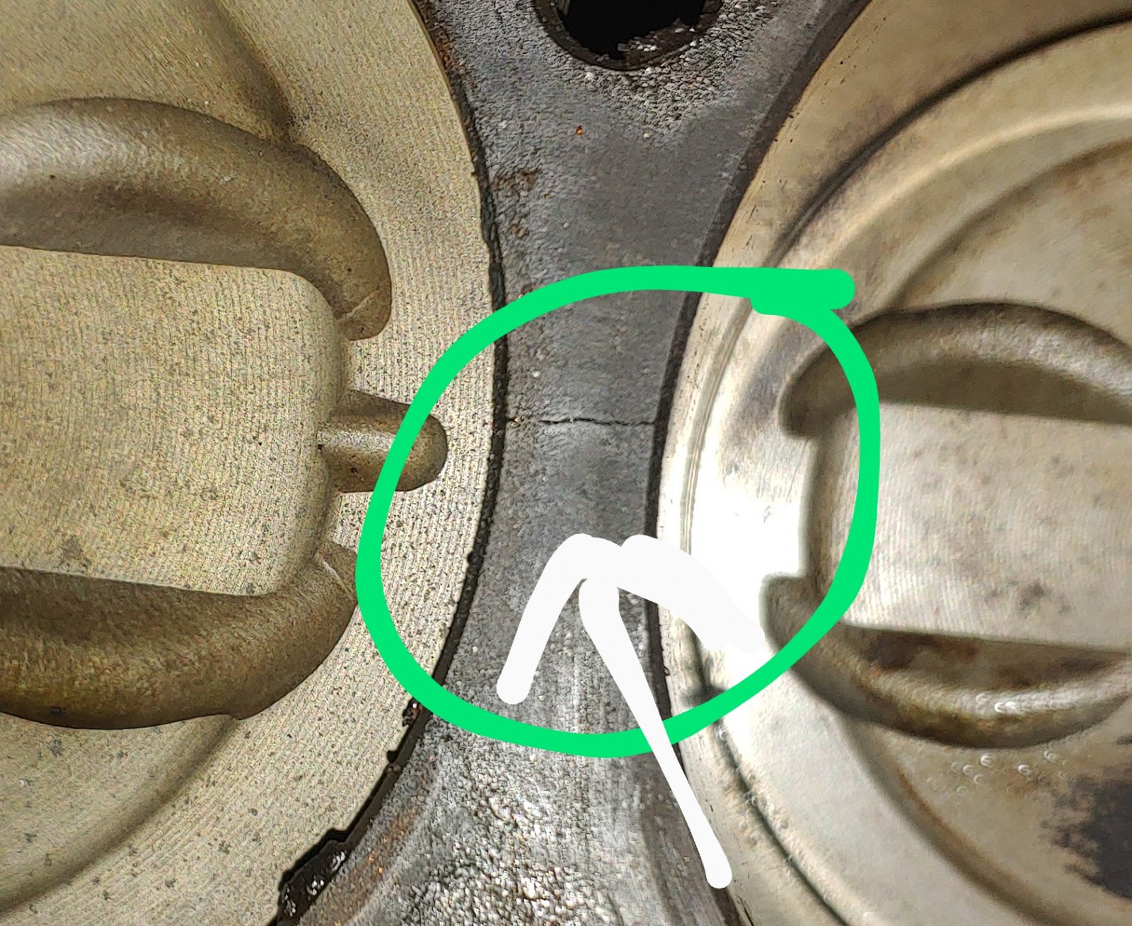

PNW VietVet.... So I came across some bad news, and got some good news today. I decided to take a closer look at my block since it was stripped. There was a crack between cylinders 4 and 6. (Pics included) so... I ordered a brand new crate long block for her. As i said Never getting rid of it!

Ok, well, you kind of wanted to go that way anyway and now you have a great excuse for the wife for why you HAD to order an engine.
Where did you order the engine from? What warranty with it? Stock block or some upgrades?

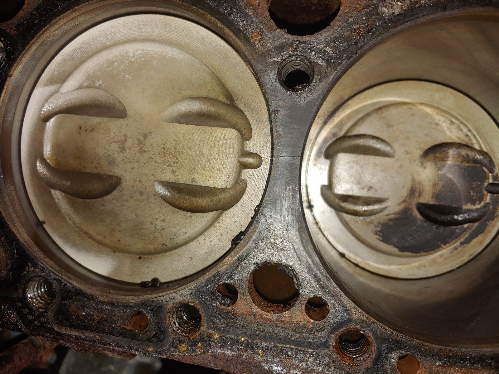

When you look back at your original heads and block pics, looks like the #4 and #6 cylinder piston tops are the cleanest ones.
Have you already made your list of what else will be done since you took it all apart? Hoses, belts, water pump....etc.
Gonna stick with conventional oil, if that is what you ran or are you running full synthetic?

As big as that likely got when hot, I am amazed that you didn't have two really bad cylinders misfire.

PNW VietVet.... So I came across some bad news, and got some good news today. I decided to take a closer look at my block since it was stripped. There was a crack between cylinders 4 and 6. (Pics included) so... I ordered a brand new crate long block for her. As i said Never getting rid of it!View attachment 280375View attachment 280374
View attachment 280373 View attachment 280376
I’m guessing the good news you got was that you can afford the new long block?:eek:

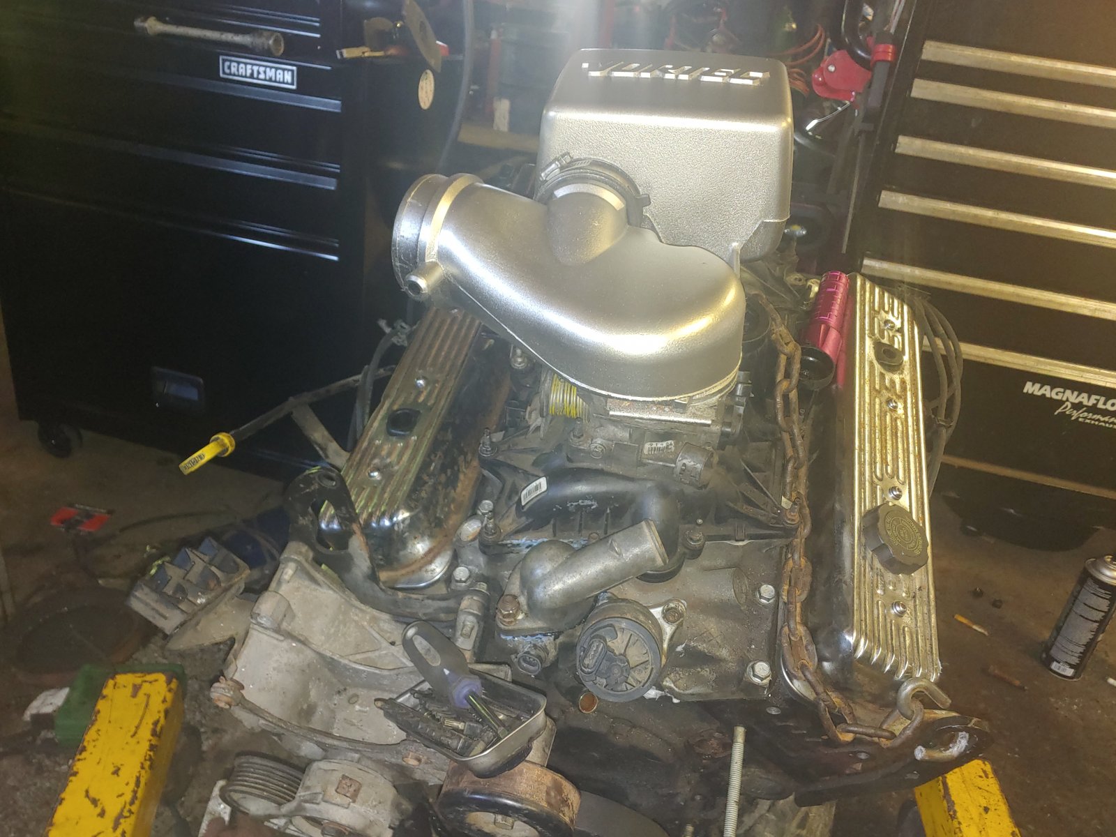

Well, I finally am getting this build under way. I had some serious family issues pop up which put everything on back burner. Now, my new hear is ready to go into my baby....

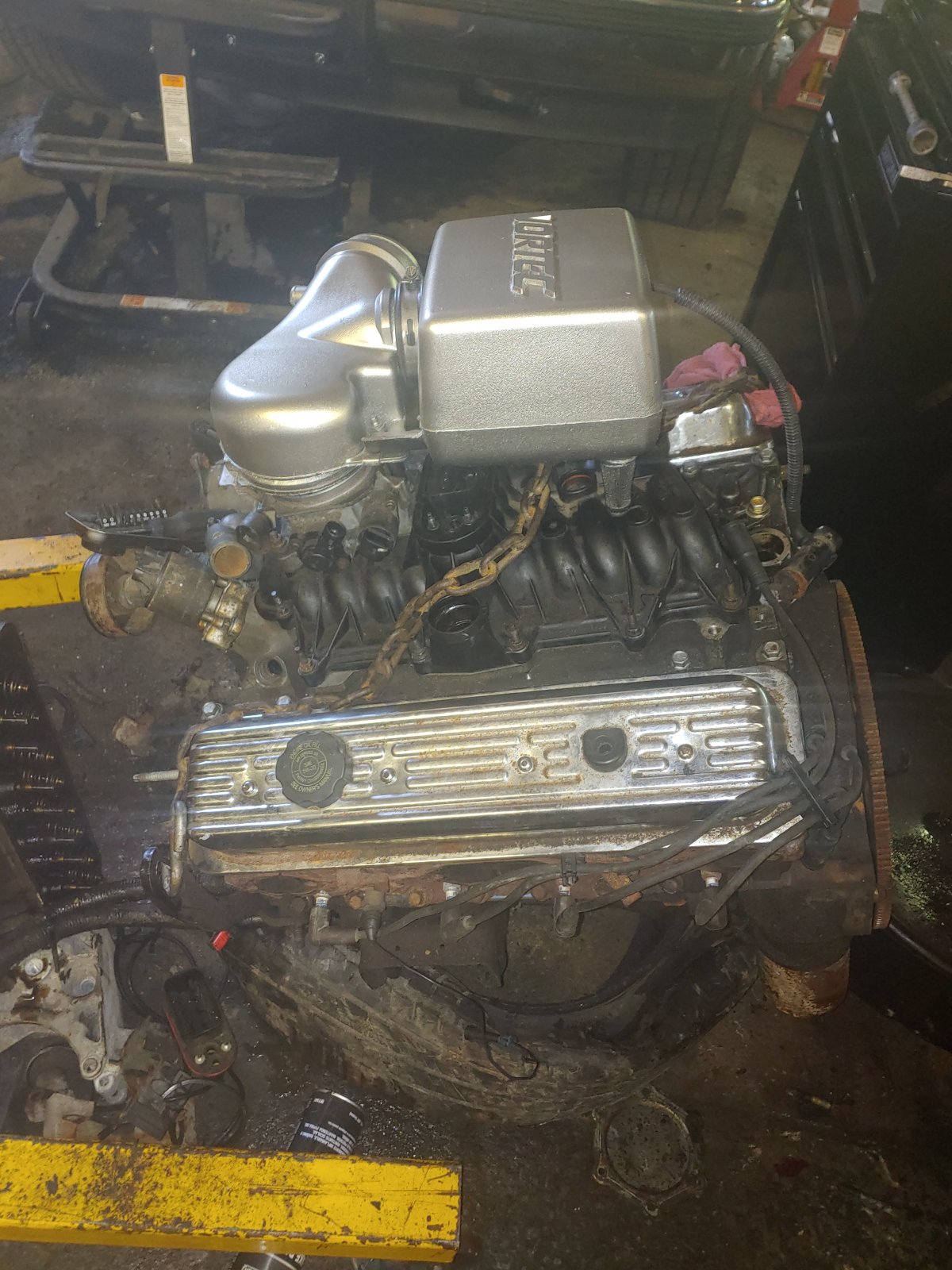

Before anybody asks, I had to help some family with some serious bills. So I had to go with a used motor for now. My step dad needed the money for some medical expenses, due to a recent diagnosis of cancer. So I gave them all the money for my engine. I scraped up some for a used engine with about 87,000 miles on her. I'll do a new one next year. But my family comes first...

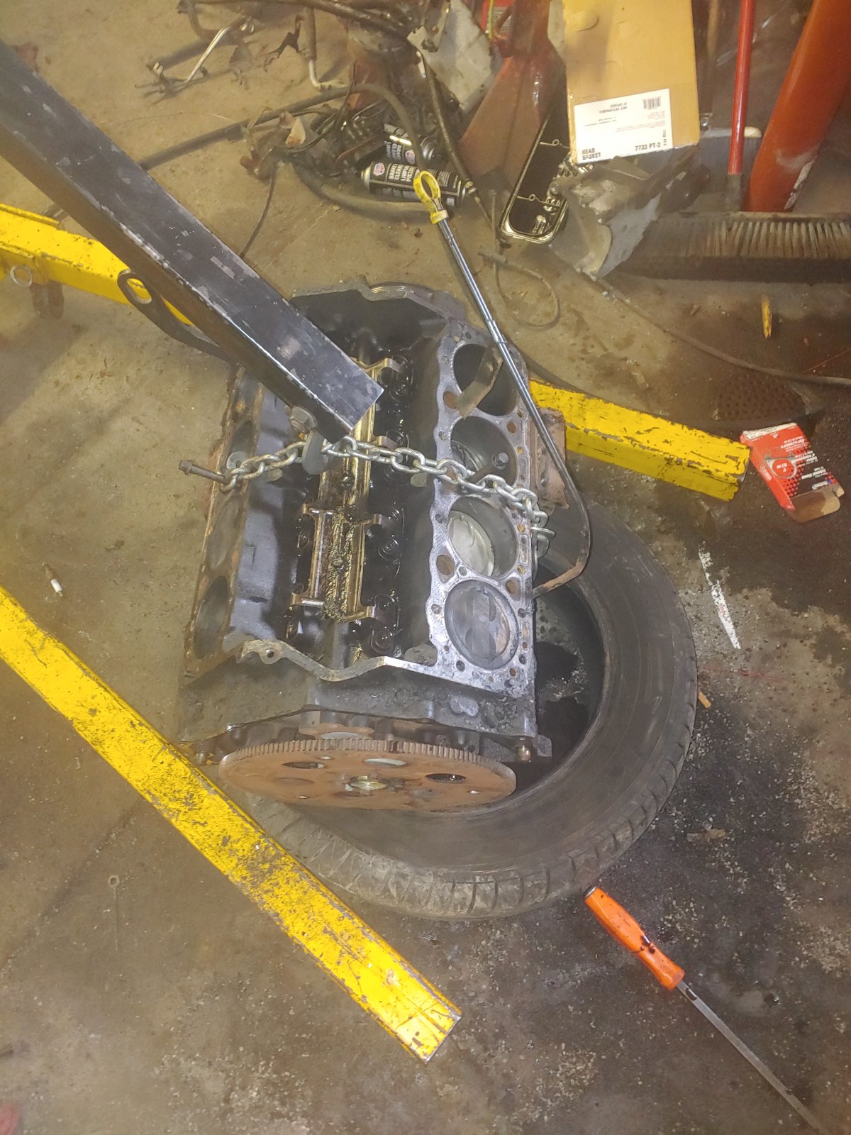

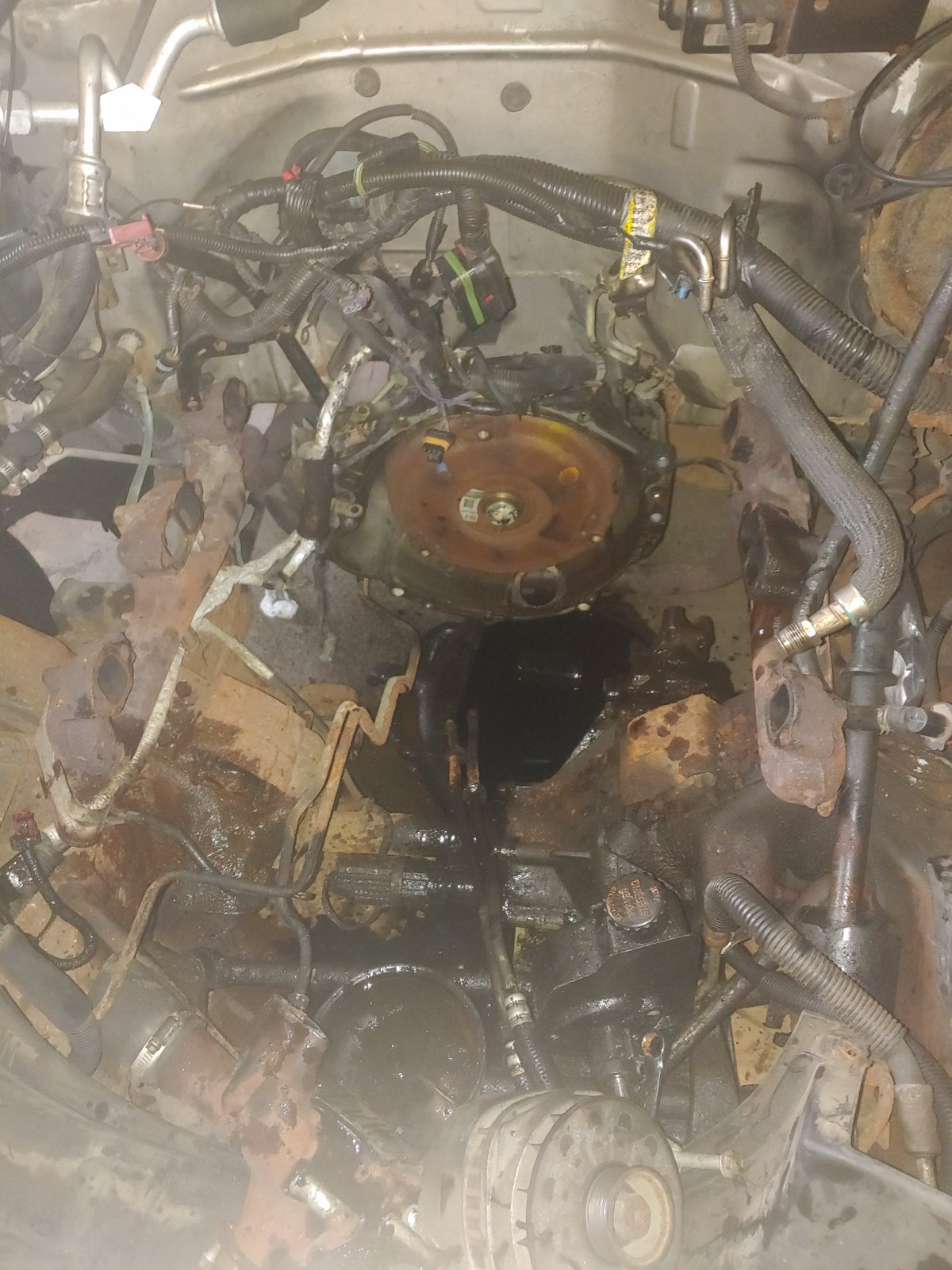

Well old one finally gave in and came out. Tomorrow the good one goes in....
