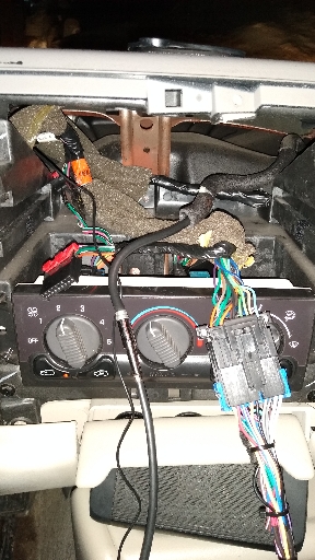

Help installing an aftermarket radio in a 2000 Suburban.
I bought a JVC Bluetooth CD player off of Crutchfield. I bought the adapter so I didn't have to solder any wires.
When I unhooked my factory radio there were 2 wire sets attached to the back. See picture.
I hooked up to the main harness and left the one on the left unhooked because I have nowhere to attach it.
Does anyone know what harness that is?
I cannot get any volume in my Suburban when I hooked up the new radio.

I think that there are 2 harness types for aftermarket head units. I do know that if you have rear controls, you can't just delete the separate harness for that; you won't have any rear speakers.
Look at my post here : https://www.tahoeyukonforum.com/thr...sing-any-functions.116416/page-3#post-1409628
...and my posts before this one. Although I kept my stock head unit when I removed the cassette deck and rear controls, it might help your situation.
I would first check w/ Crutchfield that you have the correct harness.

Where did you connect the blue remote wire to. When I did mine I connected it to one of the extra black plugs and got the speakers to work
