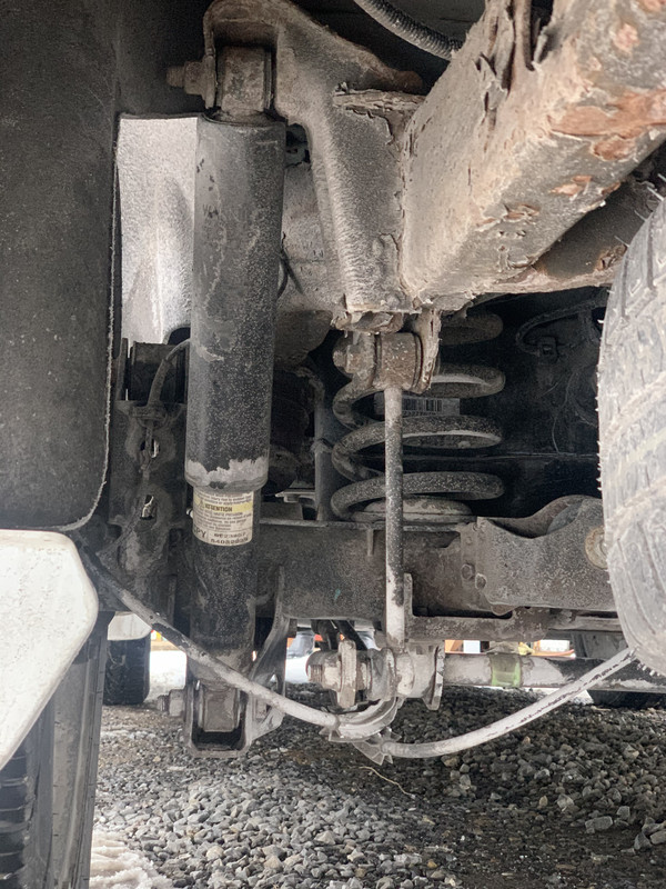

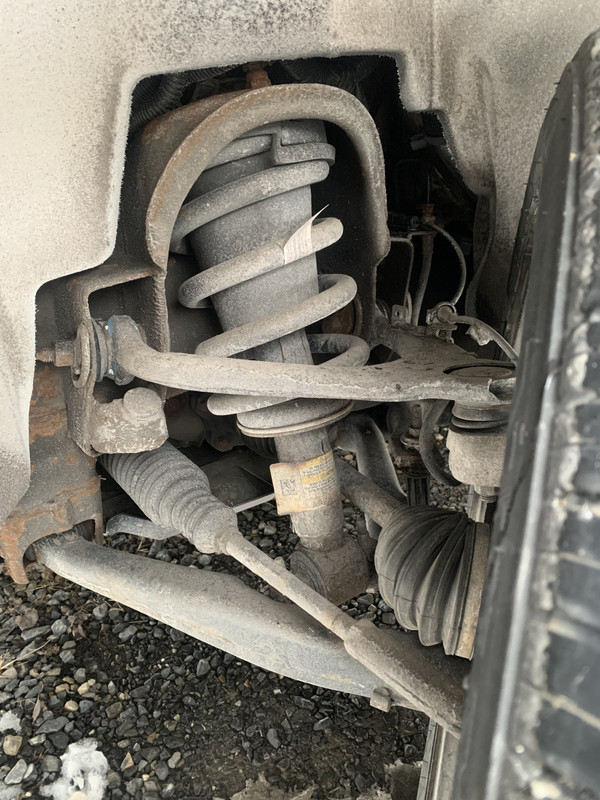

I have a 16 suburban LT 4x4 that I’m looking to level the front 2.5” and bring the rear up 1.5”. IFS is brand new to me as all my other trucks are solid axle. I’ve read about every thread there is on lifts and levels but still don’t know which way to go.
I don’t want to spend more then necessary but also don’t want something just because it’s cheap. I’d like to do things right and keep all the geometry correct as this is our family vehicle that can see long road trips. Any advice on which direction to go is appreciated. Pics below of my stock suspension, I assume this is the regular non magnetic or air assist suspension.

Correct. That is the standard rear suspension. I would look into suspension maxx, well built products made in the U.S.A.
They have the exact kit you are looking for. 2.5” front/1” or 1.75” rear.

small world... in general, as always...go jack up the front to the height you desire. look at the upper arm ball joint angle and distance to bump stop. at a minimum you need to trim the rubber stop if not remove all together...with almost all heights of a level kit.

Good info. Looking at the picture I posted above it looks like I have the stamped arms. Ready lift are the first arms I’ve seen for stamped factory arms. It doesn’t look like they sell them alone tho only with a 2.25” leveling kit.
Anyone know of arms you can buy by themselves that are meant to replace stamped arms and will work with a 2.5” level?

i would call them or a reputable dealer...the Truck arms are the same in most cases and they run 449$ i think

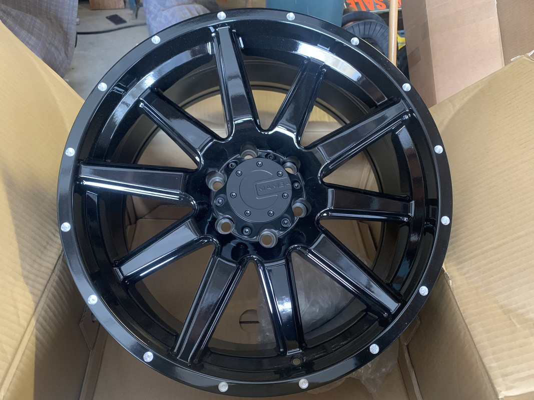

mambas in a 20x9

Nice choices, I ran the suspensionmaxx 2.5 and am running the readyLIFT UCA's now with their SST kit. With 1.5 rear you may want to consider shock extension brackets as well, can always add later though if you notice the shocks running out of travel. Those 20x9's are 0 offset? Cool design with the spokes alternating in and out, has to look wild from an angle.

I was thinking I should probably add shock extensions. They’re +12 offset so should be pretty close to flush with the fender. They’re definitely an interesting design, I gave my wife about 20 wheels to choose from and those are the ones she liked best. All she knew is she wanted black lol.

In case you didn't come across it yet, for the readylift UCA's they recommend 0mm offset to clear. At least that's what they list for the 4" SST lift, they don't seem to reference it on the listing for the UCA's only. @STORMIN08 was trying to figure out if they'd work with his stock offset 22" wheels, so may have more info for you. The +12mm may work, just wanted to give you a heads up in case there's another UCA that might make for a no-worry install with that offset.
Stormins actually the one that recommended those control arms lol. I had not read that as I didn’t look at the 4” kit but I guess I’ll find out. Hopefully it all works out. It’s hard to find replacement control arms in general for the factory stamped arms.

I hear you, when I was looking for a lift I was coming across the same challenges on the UCA's, I was also stamped.
Took another look, the UCA kit with level they sell for the Sierra's & Silverado's does list +12 for min offset. The suv and pick up front suspension are more or less the same, hate to make an assumption, but it seems you're going to be good to go! Sorry for the false alarm.

i have seen several statements...ready lifts site has 0, +6 and who only knows.
select a year and it differs. i would guess by looking at the parts and photos of installs, the larger diameter is less of an issue, as the barrel is closer to the wide part of the arm...where as an 18" with hefty tire tends to shove the tire into the control arm.
