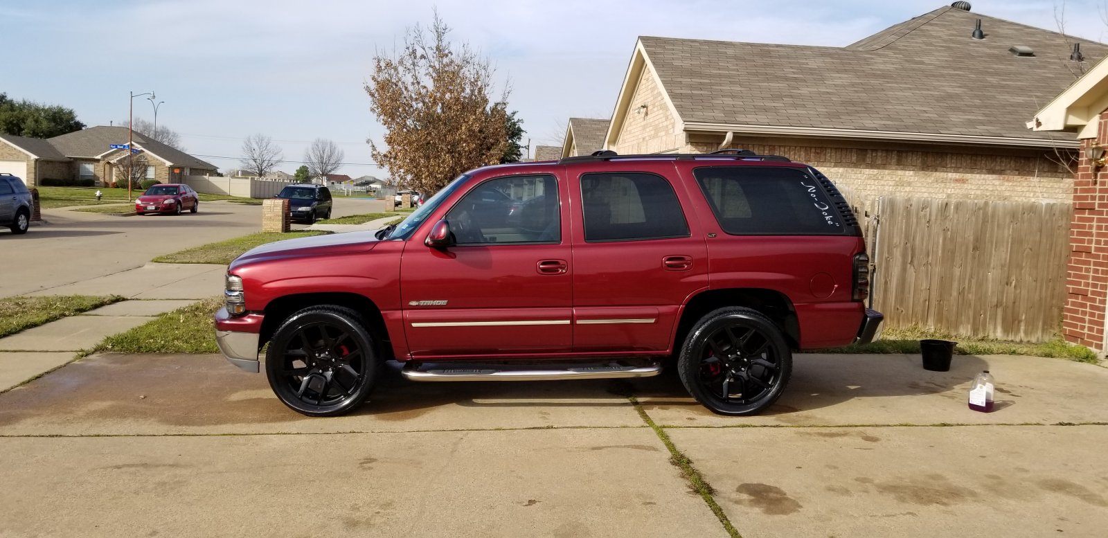

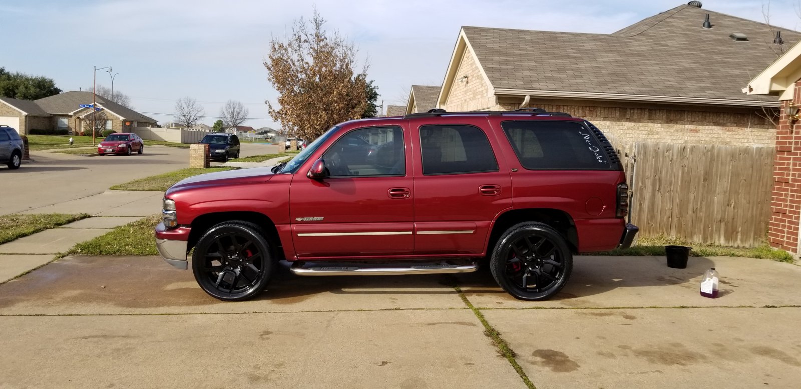

should I go with the 2/3 drop....on 22s.....also got rid of all the chrome blacked out

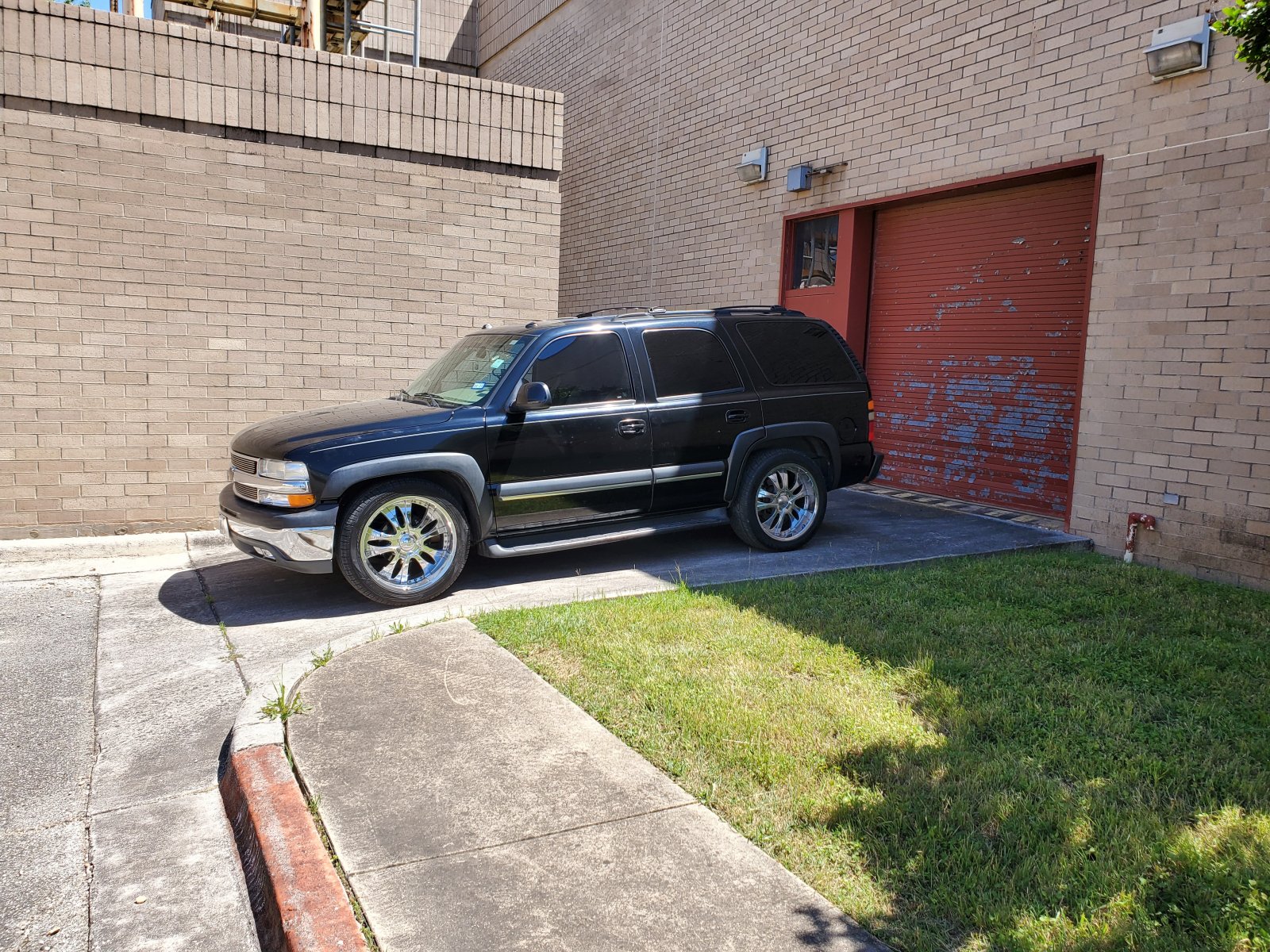

Now im torn between the 2/3-4 and the 0-4/5-6 Norcal kit on 24s with 305s.

No problem. If you’re gonna go 4/6 I’d suggest 295/30/24s. 2/4 would be okay with 305s. Maybe slight rub here or there. 3/5 will have a little more depending on the wheel offset
2/3 will look good and handle great with no rubbing. But imop I'd do a 3/4. I did a 2/3 a few months ago and I'm already itching to go lower. Only reason I don't is cuz it's my wife's DD and she already complains about the ride height now. But it's up to you brotha.
