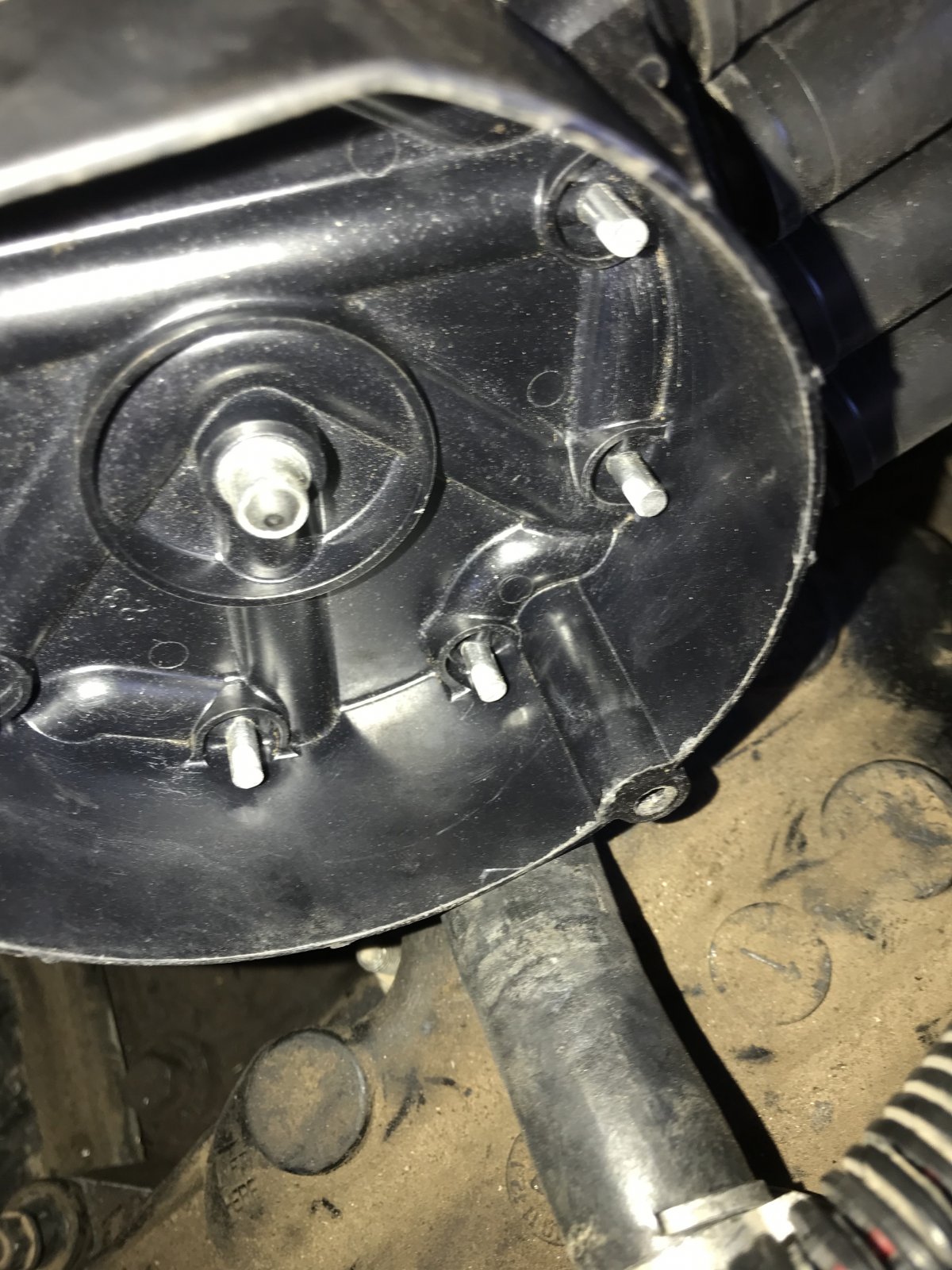

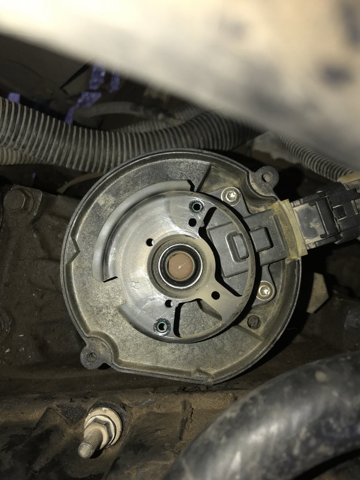

Cap and rotor off, Here's what the cap and the distributor and cap look like. This is a brand new cap too, Look at all that corrosion lol

That is the cam sensor in there and can unbolt and remove it when you turn the plate that the rotor attaches to and line that square cut slot up with the high spots of the cam sensor, for clearance. That square cut slot is 180 degrees across from the cam sensor high spots, in that pic. I have seen worse cap firing pins and I would not be that worried at this point about them, especially since runs fine at cold engine. If want to replace the cap and rotor, do so. If you look at that bottom plate area, at the 5 o'clock position, there is a black piece/plug that could be a vent for the distributor instead of the screen. The distributor used to have screens and may be redesigned now but it could also be designed now that there is no screen at this point and vents another way. I have no idea when and if the screen went away completely.
