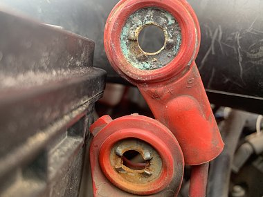

I suggest you remove the positive battery terminal, and separate it into (2) pieces like the photo below THEN clean all metal surfaces thoroughly with a wire brush, including the battery side post.
When this terminal is compromised with corrosion, it can still power your ignition but without cranking as you describe. My '96 had the same symptoms and this fixed it.

I hit mine with a mixture of baking soda and water, and a wire brush.

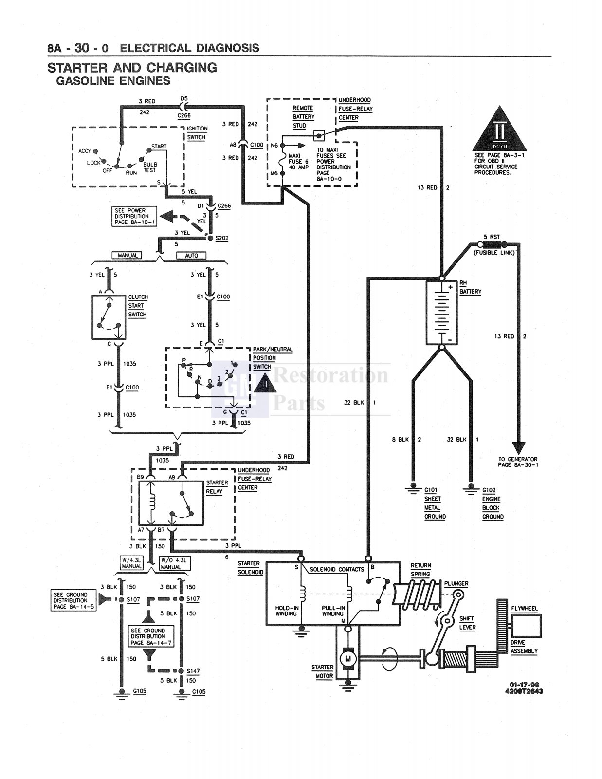

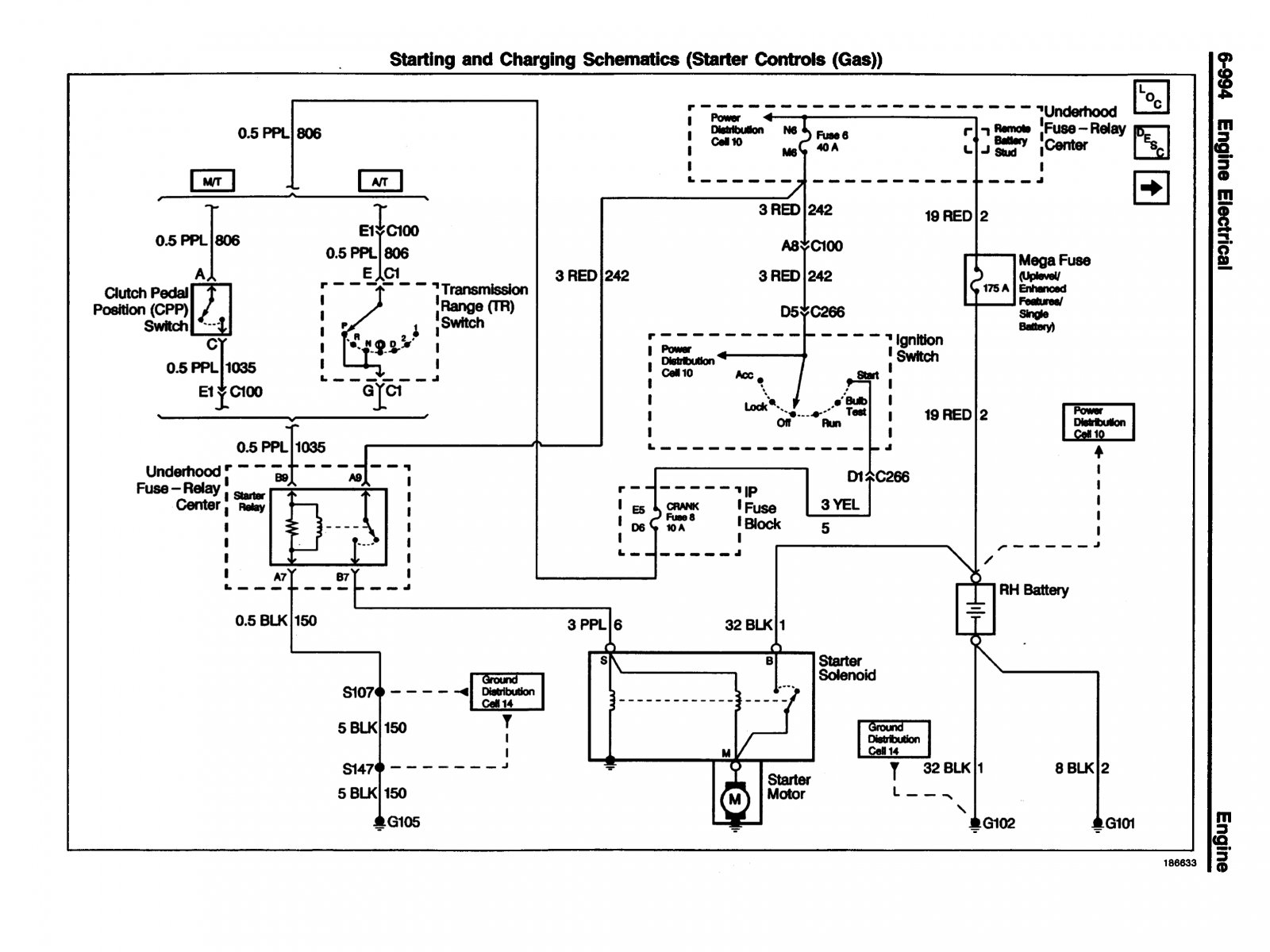

Here’s the wiring diagram from a 98 which shows the crank fuse. And here’s the diagram from 96 which doesn’t, so you might have to verify the wire colors.
Does it start in neutral? Are your gearshift lights solid (not flickering)?

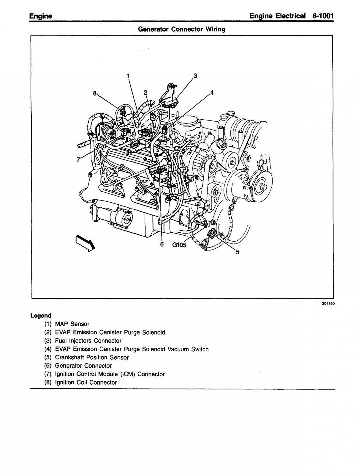

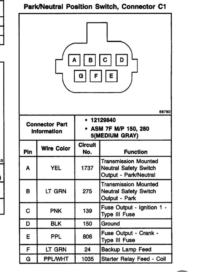

If you have voltage at the 10A crank fuse, see what you’re getting at the transmission range switch connector (and at B9 on the starter relay) while cranking. It all grounds at G105 near the harmonic balancer.
1998 diagrams:
1996 diagram:

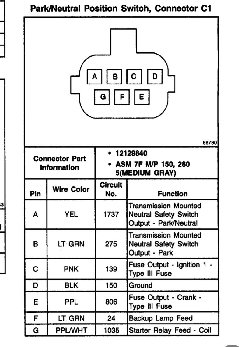

Thanks for the diagrams. I’ve checked the wiring. I don’t understand how I can turn the key to run and ground the 10 amp door panel crank fuse and the truck start.
