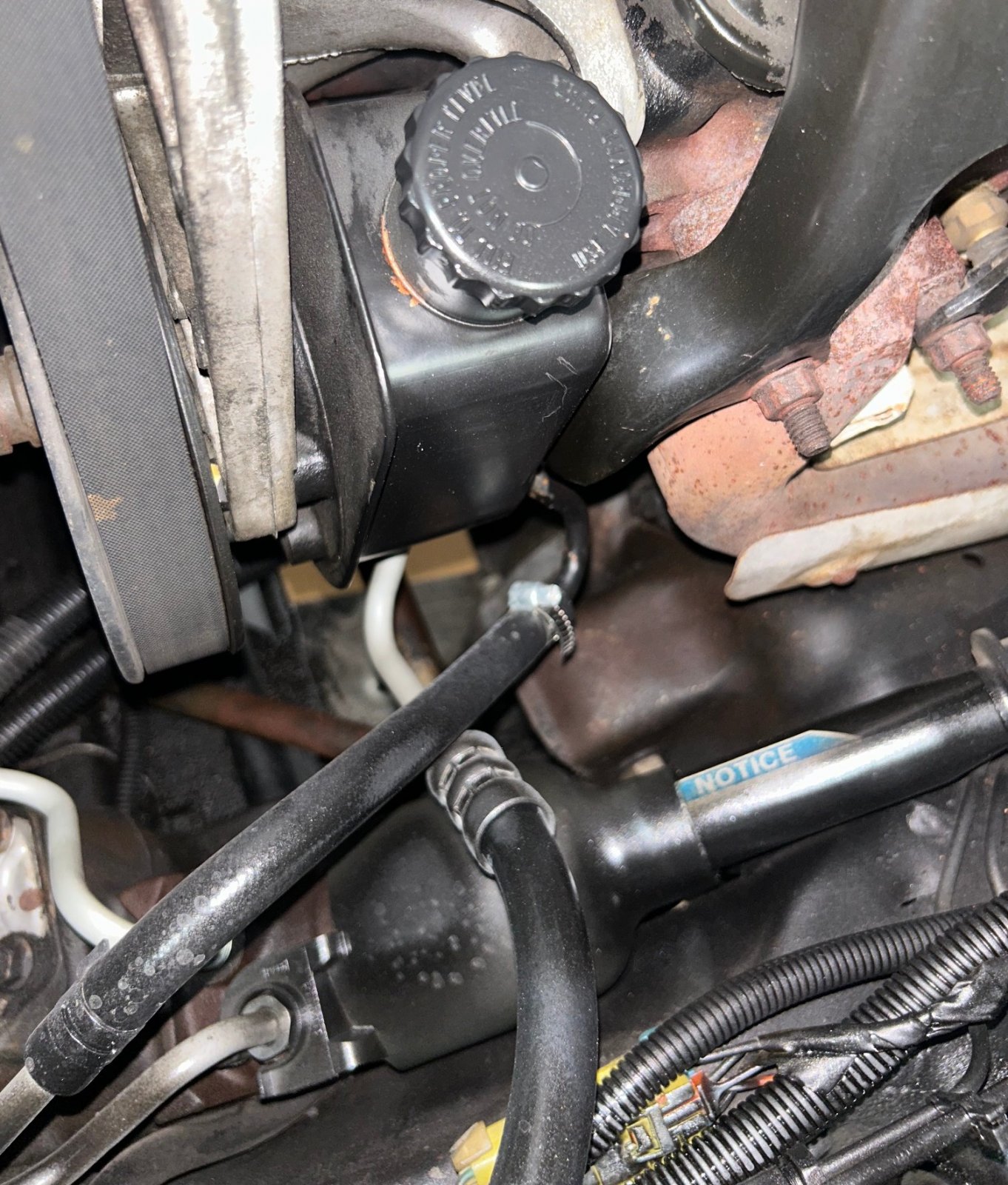

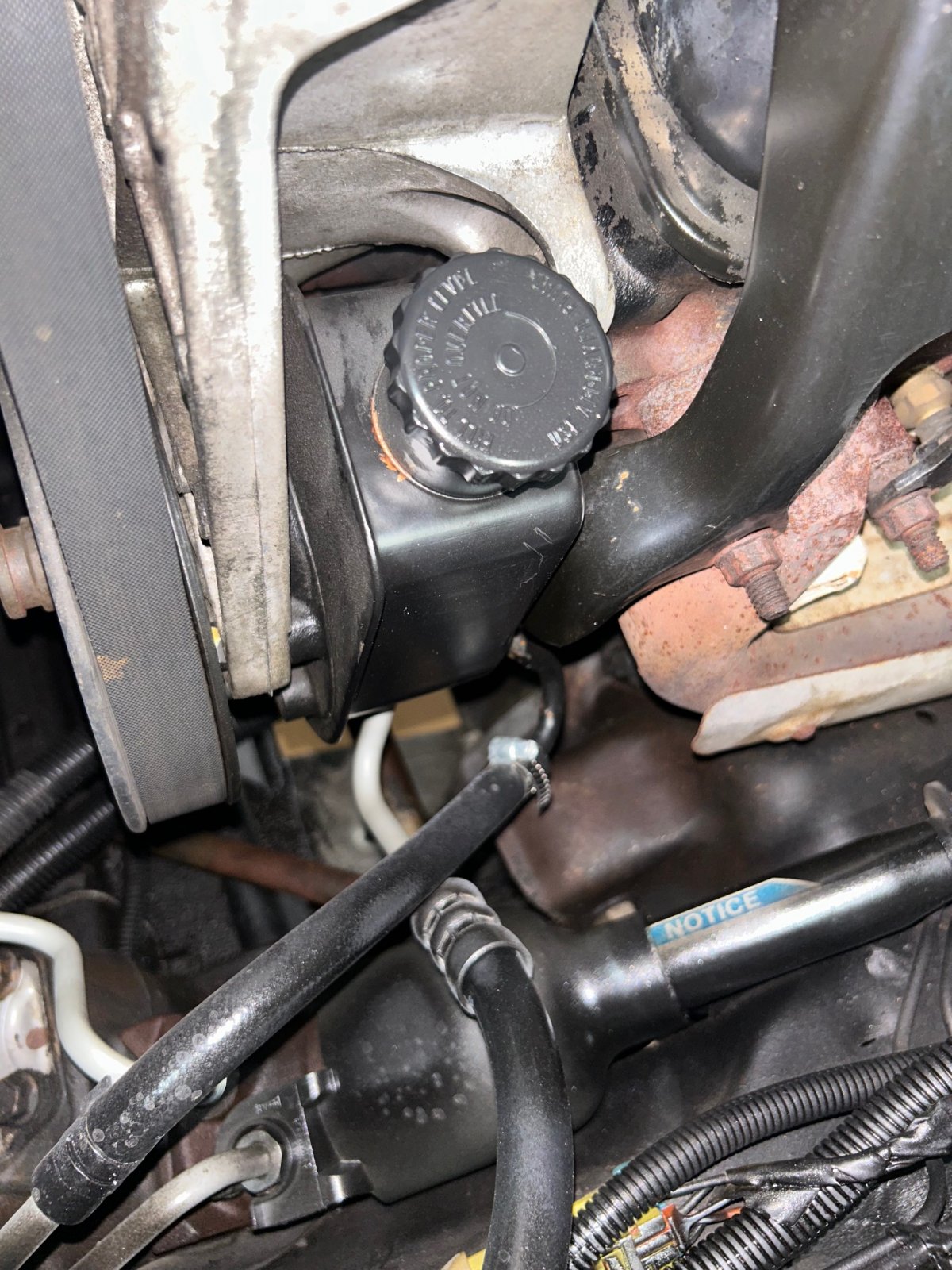

Yes if I turn the wheel to full lock right and left I can hear the pump. Don't think it has power asst? It's a 1995 2 door Tahoe with 4wd. But I don't know, is it in the RPO codes? Here's some pictures.

When I say power assist I mean does it steer the same with the truck off as when it's running. Power steering pumps are usually not a problem except for some leakage. If you hear the pump change at full lock it usually means it's working as designed, what you hear is the pump reach maximum pressure. Our 97 has what I think is too much power steering assist, I'd rather it was harder to turn.

Well, nothing‘s leaking. The front end is nice and tight, no bad tie rods or ball joints. I even changed the front tires and it steers the same so maybe that’s just the way it is? it doesn’t bother me. I just wanna make sure it’s correct.
