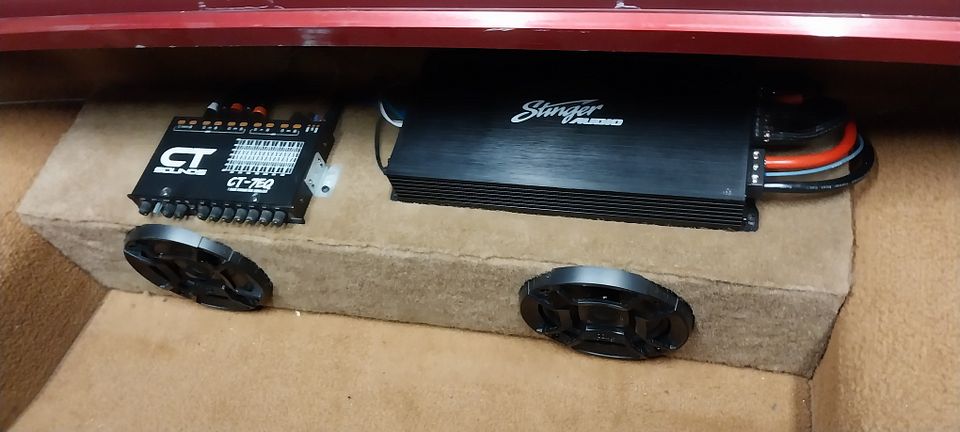

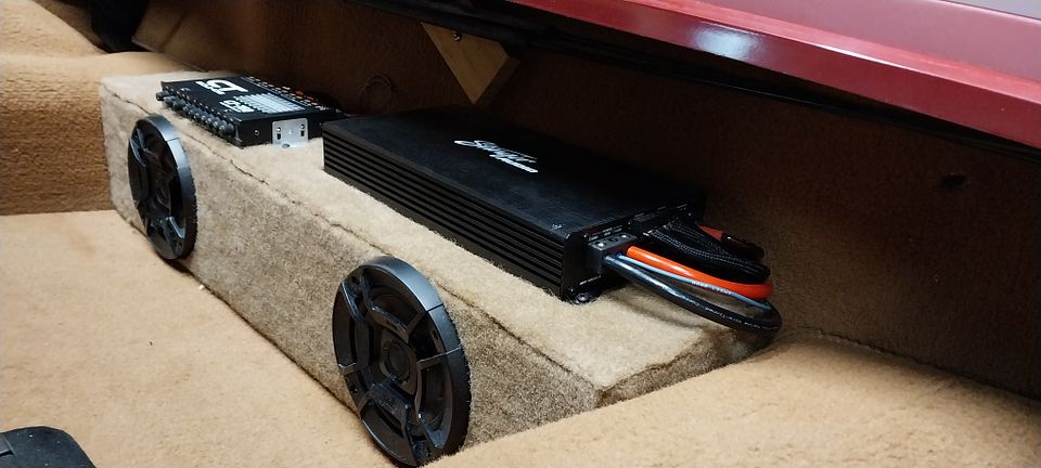

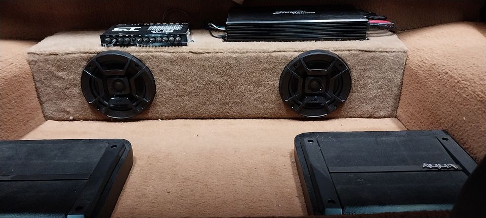

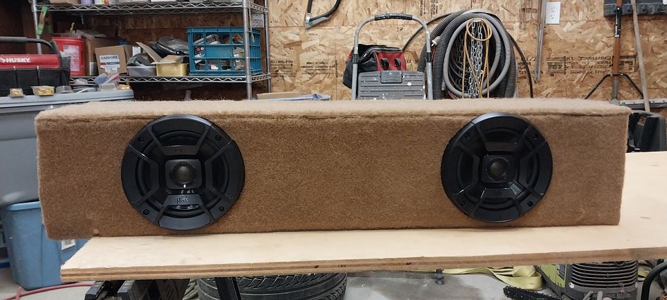

I did manage a little more work on the stereo, I picked up a pair of Polk DB522 5.25 marine co-ax drivers for the rear. I built a box for them as a test and while they sound fantastic in the way too large box, it was was a compromise between sound fidelity and space. In the end it was a failure, the sound is great for a 5.25" speaker but the space it took up was too large. The large(ish) enclosure allowed the mid bass to come through which it always tough for 5.25 drivers. I am going to cut it all way down on the next attempt, I have a design in mind that will give me back the space I lost but at the expense of most of the mid bass, it is a compromise I think I can live with that as the vocal region is what is mostly lacking at top down speed from just the front stage, the rear fills it in nicely and takes some pressure off the fronts.
Being built...carpeted with the original carpet on the massive box that was in it. I pretty much slapped this together and it shows.
Installed...in reality it did not cost more floor space than the canted old Rockford amp took up but the goal was to increase space, not keep it the same.

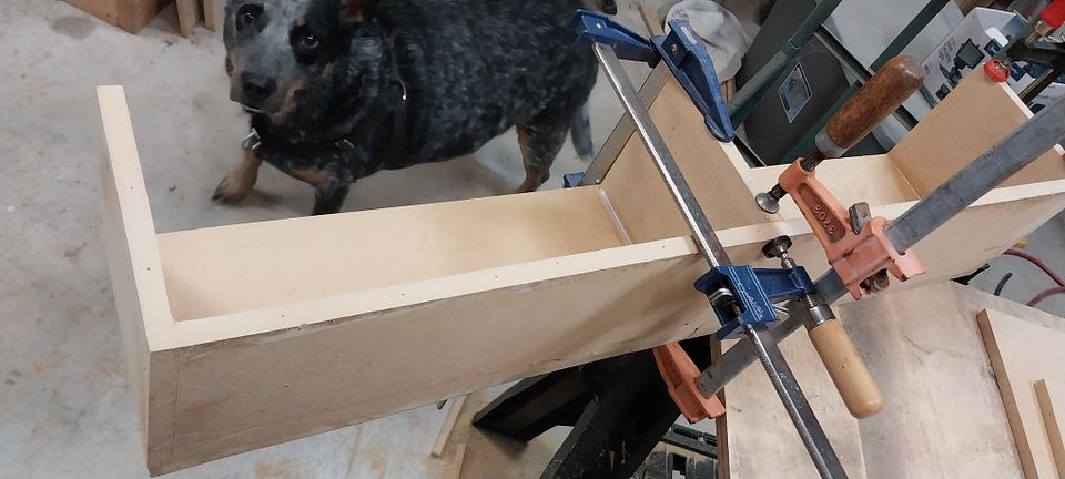

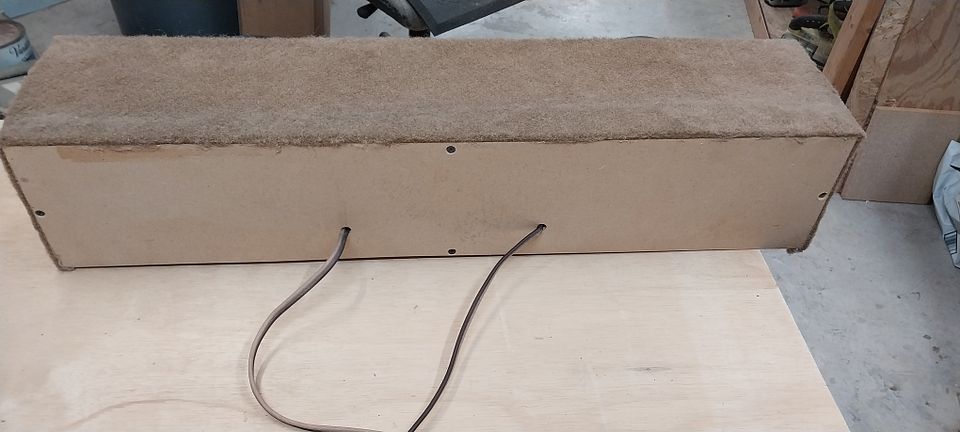

This will hopefully be the last iteration of the rear speaker box for a long time, while I have enjoyed the challenge of designing something that functions and doesn't take up a lot space, I believe this design will do what I want.
I rebuilt the rear speaker box, it sounded great but was still taking up more room than I wanted. I rebuilt the existing enclosure to have just two small cubes mounted to a back board with the amp upright between the cubes. I needed a way to get the 4 gauge wire to the amp and still allow the back board to fit as close to the rear wall as possible while not putting any sharp bends in the wire as this can cause the wire to come loose and a direct short is not a pretty thing to see. I mounted the cubes on 5/8" stand offs so I could pass the wires behind the cubes, giving a straight shot to the amp. I need to do the same routing on the input side but haven't had the time to do so yet. You may notice the EQ gone, no more blinding blue LED's. Before the design change I had 16" from the waterfall to the box for luggage, now I have 22" in the center section which is a huge improvement. Mid-bass did drop slightly but it is hardly noticeable.

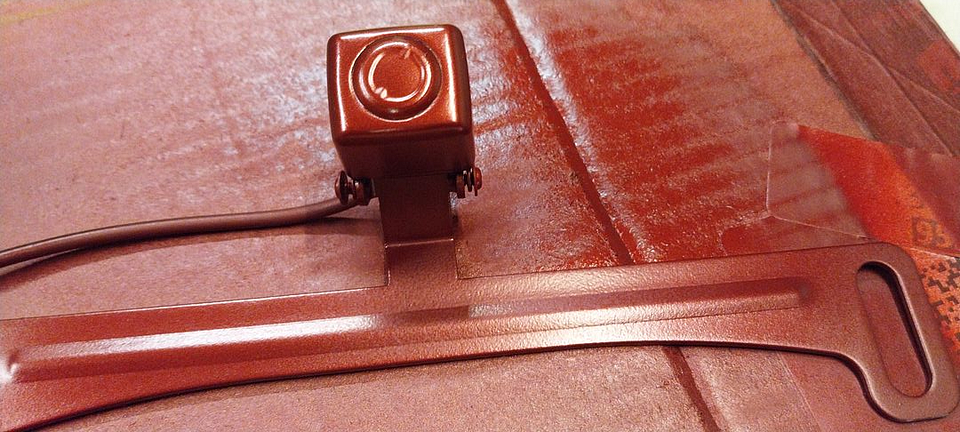

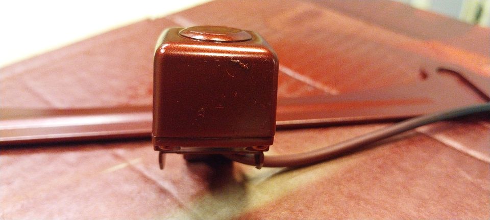

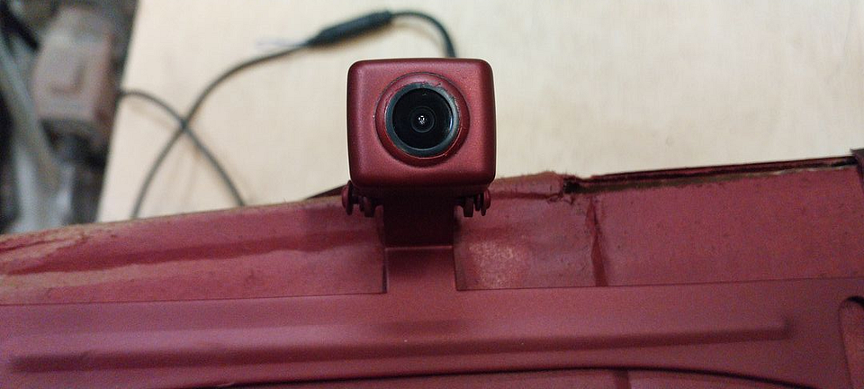

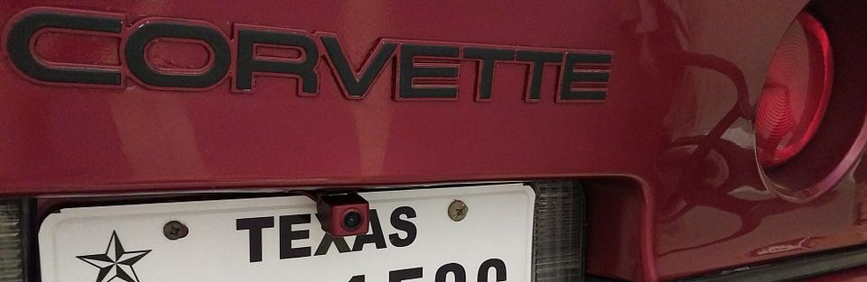

I would love to say I have been busy and got a lot done with the car but I have not. I tossed my back out moving the endless grass on our property a few weeks back and have been too sore and drugged up to worry with the car, or much of anything. If thi update is more out of sync and full of gibberish than normal, it is the Vicodin/Gabapentin doing the typing.
I did have to replace the backup camera, the AHD camera from the Android was not really compatible so I found a CMOS style that had the same hookups for the cam so I would not have to re-run any wiring. If I had to run wiring it would not happen as bending over or lifting is not something I cannot currently do, at least for a another week or so. After confirming the new camera was going to work I decided to body color it. It was a completely useless thing to do but I have been bored and it let me do something on the car.
Lightly sanded and paint going on. I left the clear plastic lens cover on while painting so I did not have to clean any paint off of the lens.
Painted and cleared. I used a flat clear as I wasn't to activate a can of 2K clear gloss to clear something so small.
All finished and mounted.
It doesn't really make the cam blend in except at a distance. You can still it is a backup camera but at least it isn't black and is easier to not notice. Completely useless but it kept me busy so I call it a win.
