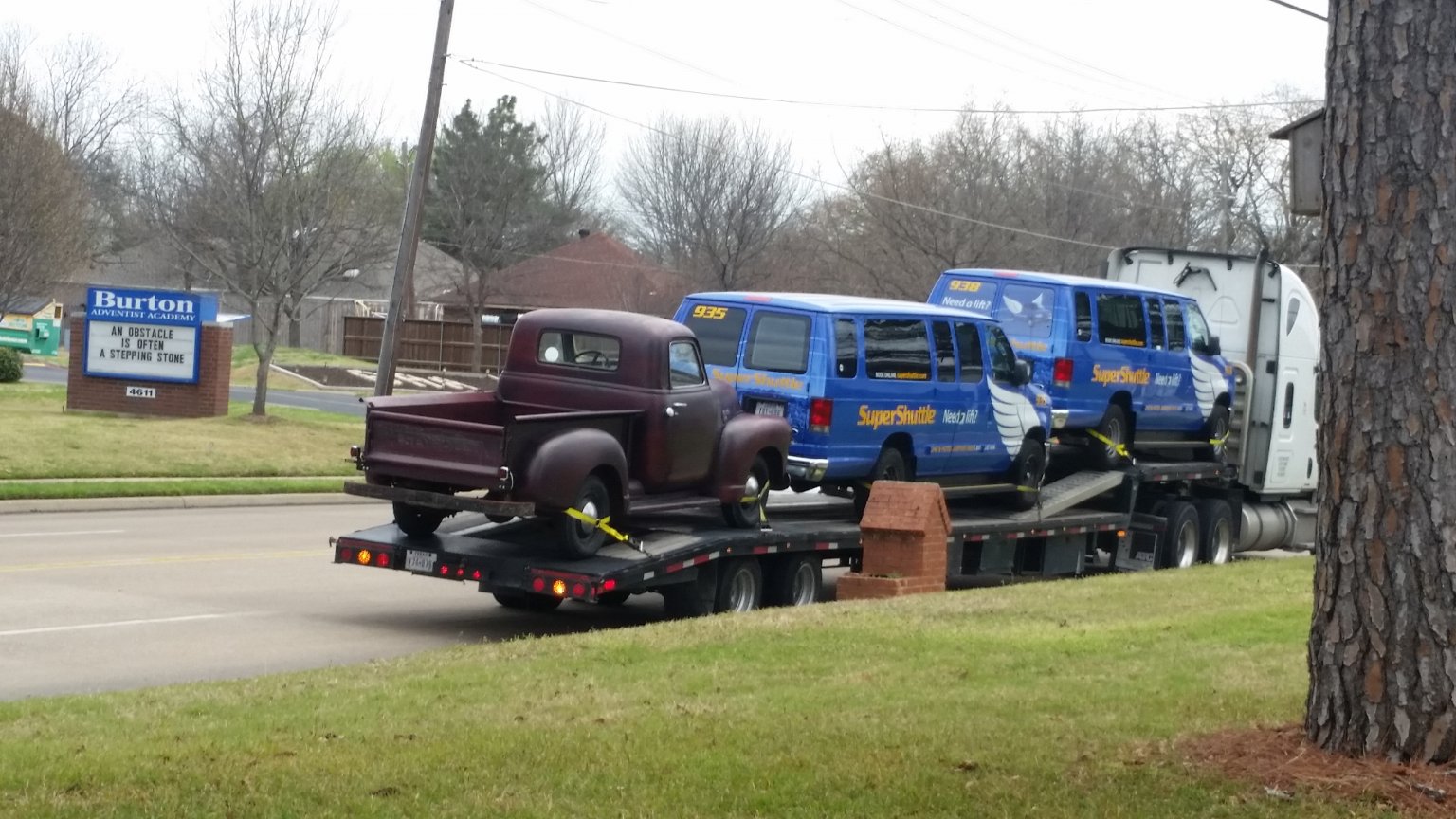

Bye bye... needed to free up some cash so I sold it. Was sold in less than 24 hours on Craigslist. A guy from Arizona bought it.
