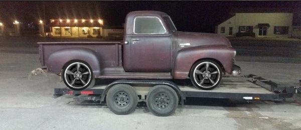

On the trailer heading home.
picture.php
