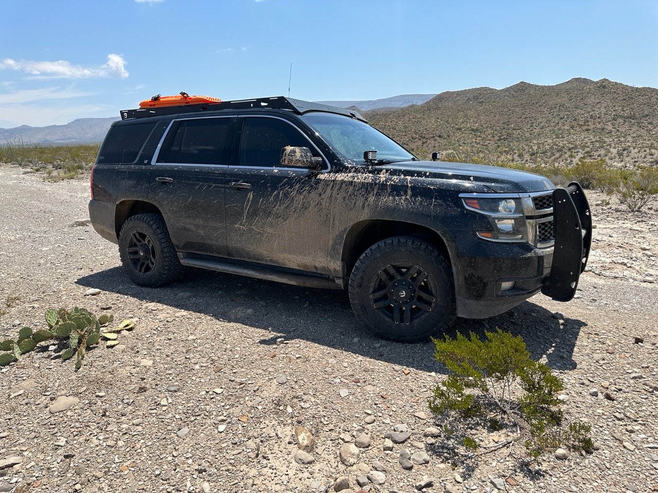

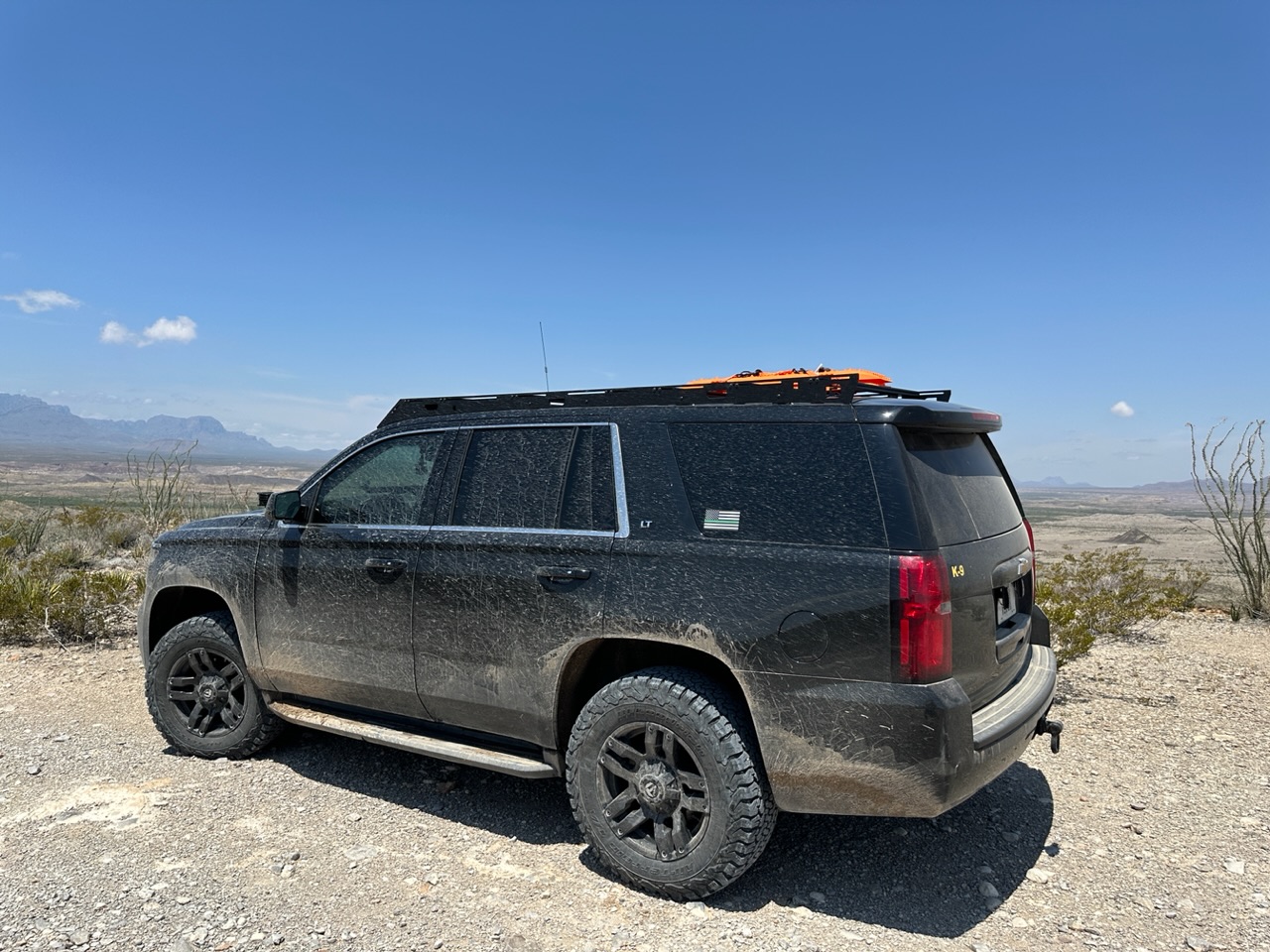

@Jimbowattz I have 18x9 on mine tire is 285/65/18, so roughly 33. It does have a small level to the front. I’d guess an inch, but I’m not sure because it was there when I bought the truck.
Big Bend pics for size and just for fun.

To close the loop for anyone that happens to come in behind me looking for similar answer....
17 inch wheel with 25mm offset fits the 18 Tahoe just fine. I'm going to add a 1/4 inch spacer to bring it even with the fenders as they aren't quite flush. But they clear the calipers just fine. So 0mm offset isn't required unless you want them out farther.
