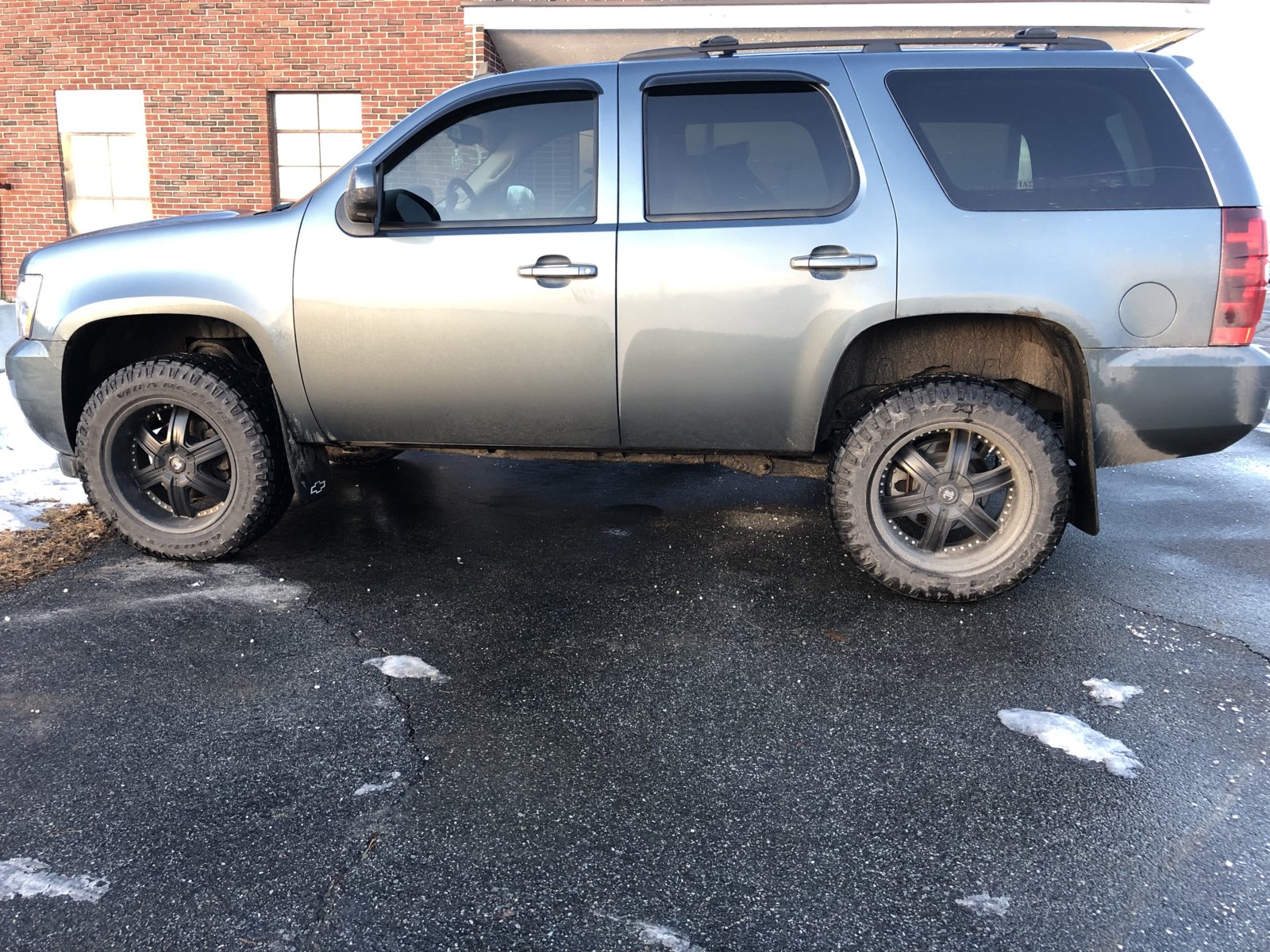

I have a 2.5/1.5 and it looks great. The rear is 1”ish higher only because i have new springs and shocks back there. Working on getting the fronts done to bring it back to about a .5” difference
As you can see haha
