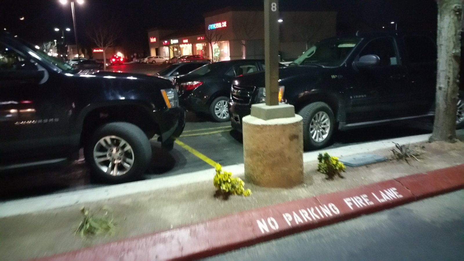

Yes the ride height is much lower= lower center of gravity= better control
you can see the ride height compared to a suburban ...
it has like a 3" drop

That Burb on the left looks like it has a leveling kit installed on the front end.
It definitely looks higher than a stock 2wd.
