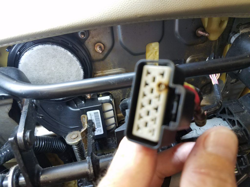

I found a post that talked about a burned pin on the heated seat controller under the front passenger seat. I took a look and sure enough it's burned on mine. I'm in the process of fixing that now.
This is someone's repair on the wires to that connector.
This next picture is the connector too.
