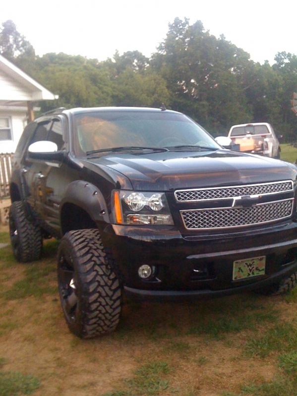

Heres a couple pics of the 08 Tahoe LTZ i built for a guy. 4" Rancho, 35x12.50 Toyo Open Country MT on 22x12 Rockstars.

Good work but IMO those wheels stick out to far. Was the increase in track width due to the lift (just for the fronts) or are they all wheel spacers?

i think i ordered the flares from summit racing. they are bushwacker pocket style flares. the track width is due to the lift, and it looks alot larger due to the width of the wheels and offset of them. i had to do some inner fender trimming to get them to fit when it turned lock to lock, but overall it turned out good. i had to get the autoride shock relocation kit from Rancho, to go with the lift. truck rides just as good, if not better then stock. and he drives back and forth about 200 miles to school one way. thanks for the comments.

Nice work! The look is not my thing at all but I can appreciate the work involved. :waytogo:
It is a Z71 not an LTZ, so no AutoRide.
Has LTZ badges on it and LTZ grill so did the owner try creating an LTZ clone??

No its an LTZ or at least one of the LT series trucks. You can tell those are aftermarket flares and even though easily replaceable the front bumper set up is for the LT series trucks.
