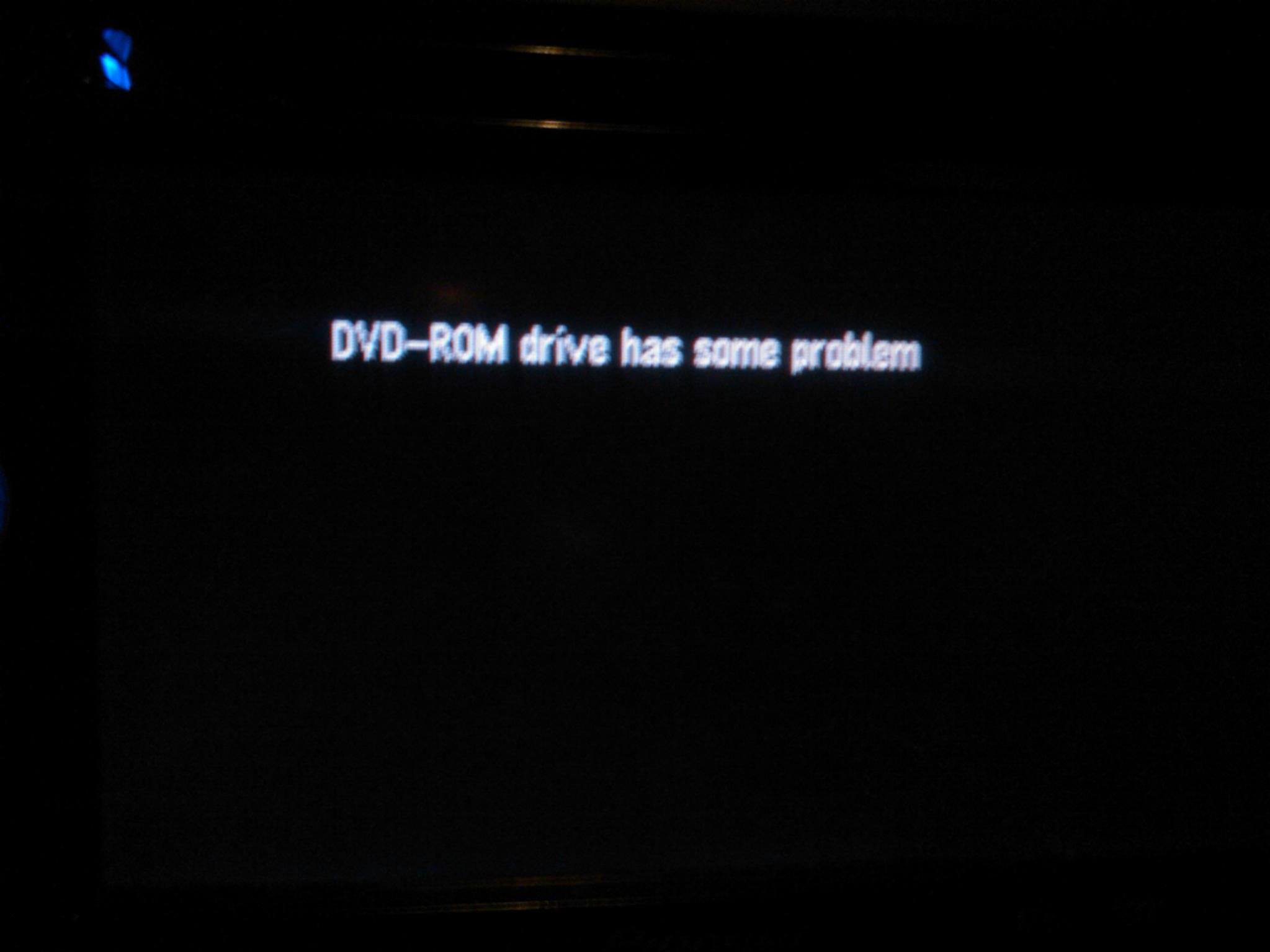

I have an '08 Suburban and have had the same problem. To add to it, if I start the car with the AC on, this horrible grinding/rattling noise comes from under the hood. I have to start the car and get moving to avoid this problem, and sometimes it still occurs. Took it to the dealership and they couldn't find/replicate the problem.
Additionally I've had the same electrical gremlin when my audio/DVD system shuts off and restarts. Sometimes it comes right back on, sometimes it continues playing audio, and sometimes it delivers a written message saying "DVD-ROM drive has some problem." I kid you not.

Is the audio/DVD system stock?

Louis, thanks, I'll do that. I figured the folks who looked at it at the dealership were certified and knew their stuff, but I'll take it back and make sure I get someone who is certified to work on the truck. My audio system is actually a Pioneer Avic D3, so I believe it's not stock, but I bought the truck used so I'm not sure. Wherever the problem lies with that, it also controls my backup camera, which no longer functions either.
