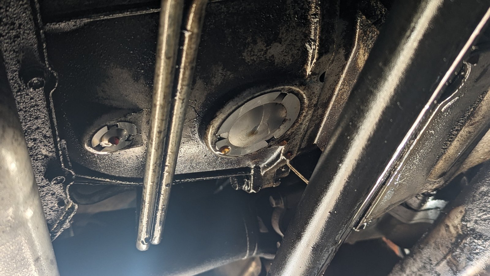

I noticed on the bell housing there is a few inspection covers. Looks like they are leaking a tad. Not horrible but would like this nipped in the bud. Does anyone know what the part number is? I can add a pic later but I'm sure someone here will know. I don't want aftermarket if possible.

The inspection covers themselves don't have seals. The question is, where is the leak actually coming from? There are a ton of threads here on common oil leaks on these trucks. But if you post a photo here of where you're seeing the leaks, we'll be able to guide you better.

Here is a pic of the covers. You can actually see a tad a drop on each of the covers. It's red so assuming tranny fluid

Those covers are just inspection covers and don't seal anything in. You can use a screwdriver and pop them off and use a flashlight and look inside for oil residue on the flywheel or rear engine cover.
Most of the time, that drip you see on that cover, is just residue from the outside, maybe from that oil filter conundrum, collecting at the lowest point.

I see 2 fluids there: a drop of transmission fluid and a drop of oil. You have a good explanation for the oil, but I'd also be keeping an eye on that transmission fluid. The input shaft seal can leak also.
The most common oil leak I see on these engines is where the oil cooler lines go into the oil pan above the oil filter. Whether you have lines or a block-off plate there doesn't matter; eventually that gasket will start to leak. If you have cooler lines then there is also an o-ring around the plug on the backside of it that can leak.

I assume that the OP has not yet taken off those covers and inspected the inside caverns with a good flashlight or visual scope for traces of fluid. To me, that would be the next step.
As indicated above, those covers represent a gravity low point, and fluids outside the engine/transmission will most likely find their way to these covers, before dripping to the ground.
