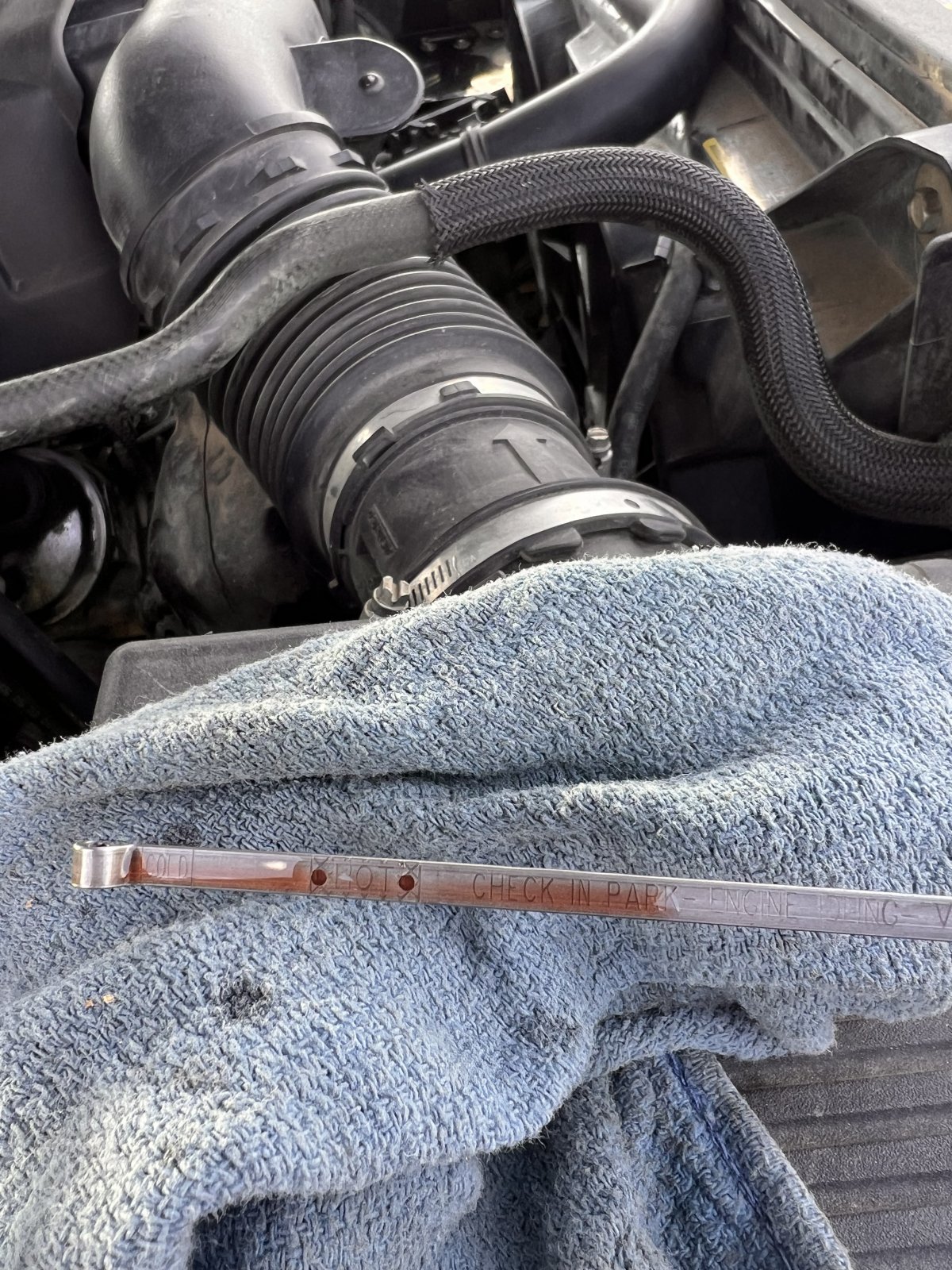

07 transmission overfilled?
YukonGold12
Aug 1, 2024
68
114

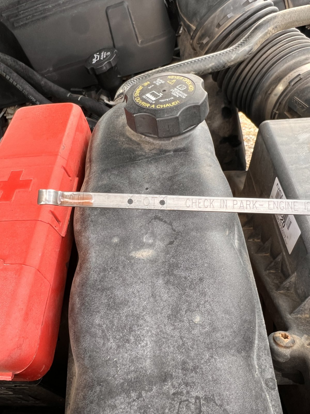

Done! It looks low now.
This is in park. Idling after warmed to temp and I shifted through all the gears.
The ATF temp is supposed to be something like 140°-160°F before you check. It takes a bit of driving to get it that hot, much longer than getting the coolant up to temp.
Cycle through the dash info display to Transmission Temperature before checking the fluid level.

Def need to add some at least a pint.

When I recently installed a new torque converter, and the ATF was up to temp, that low on the dipstick was closer to almost 2qts. low. (6L80)
Or, 4 pints.
