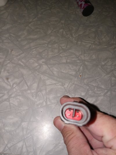

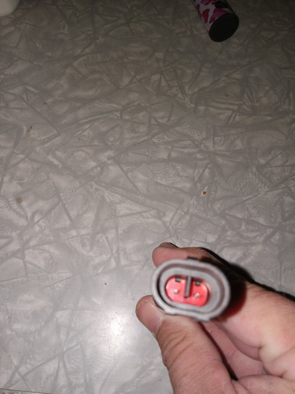

OK so I got these today

Plug and play on the front not so much rear? Any ideas? Thanks
10,267
14,870
Very slick adapter.
For the rear wires, don't cut the connector off, if you want to keep the autoride option open for the future. Simply shave some insulation off each individual wire and solder the resistor across those two bare wire sections. You've preserved your OEM connector, but you've still killed the dashboard warning light.

I am not a fun of cutting factory wire if possible. Does anyone know of a pigtail that connects to the rear sensors, definitely different than the front. If I could get a pigtail I could just solder to that. I did get the 25w 3.9 ohm resistors and the front is done, this is for the rear only.
Thanks
