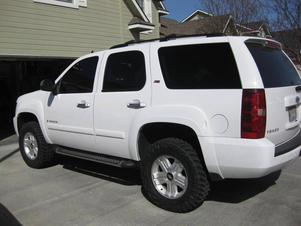

There are some guys running 285/65R18s on NNBS trucks, but it requires at least a 2" level and some trimming of the front fender mount. 2" spacers can be installed under the shock without much trouble. I did it when I had a 1500, it took about an hour and a half with a helper. If you want to go to 2.5, the installation is different since the spacer must be installed above the shock. I've never done that type of kit but plenty of guys here have.
Here is an idea of how they look on a Z71 Tahoe, from my saved pictures. I'm pretty sure the owner of this Tahoe is/was a member here.
