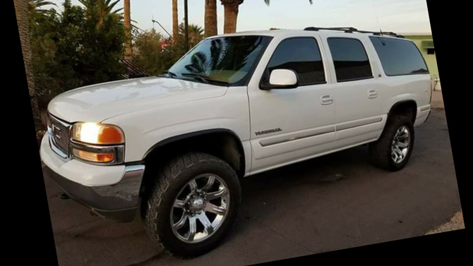

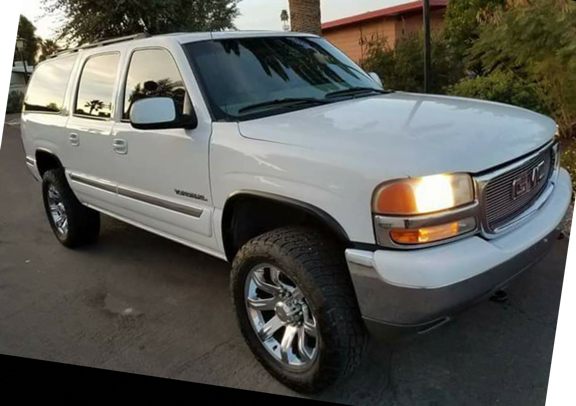

I spent a few months researching 2001-06 Subs and Yukon XL's. I've lurked and searched here as well as other sites then BOOM, there it was, pretty much exactly the look I was after, then ****, it was sold. The dealer had no idea what the details were. And, I had not really been looking at 2500's.
The dealer had this listed as a 2001 Yukon XL 2500. Lifted.
  1. Guesses how much, if any, lift/level this 2500 has
  2. How much stock difference between a stock 2500, z71, and other suspension codes. Links?
  3. Guesses on these Nitto Terra Grappers
  4. Help identifying those rims, I've looked at multiple sites, can't find them.
  5. Guess on size/offset of rims?
**images are wonky because the guy had them angled. I straightened them quickly.
Thanks for any help. I really want to replicate this look and ride height.

Looks to be a level kit, maybe 2-2.5", probably with an add-a-leaf in the rear (I believe the 2500's still used leaf springs). Tires are probably 305/55/20's, or about a 33x12x20, just slightly narrower than a 33x12.50x20. Doesn't look like there's been any trimming of metal or bumper/valance.

I think the pre 2003 2500s were offered with leaf springs, but I know I've seen some of the 2003-2006 2500 burbs and xls with autoride setup. So that will be something to consider when leveling/lifting and what products you will need to achieve that.
