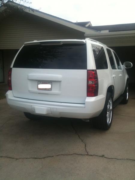

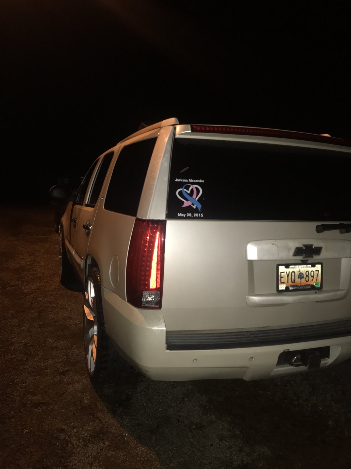

So I’ve got the older nnbs bumper and it doesn’t have the cool hitch cover. Did gm make an oem cover for the bumpers like mine? I’ve found a few pictures online and I’m not sure if it is factory or not. I’ve seen the street scene ones and I’m not super fond of them. Pictures of my bumper and the one I seen online

the problem is that my bumper doesnt have the dip in it to allow that style cover. mine has a smaller "finished" opening

So does mine.
The cover I posted is for the '07-'08 style bumpers like ours.
'09+ uses this style...
These will not fit our trucks.

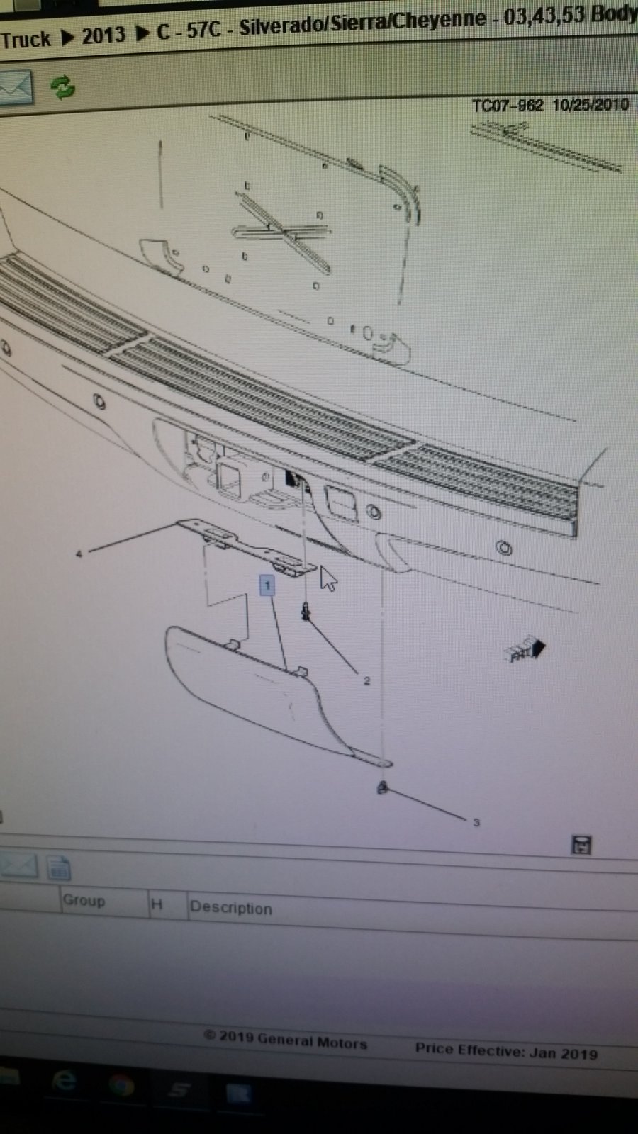

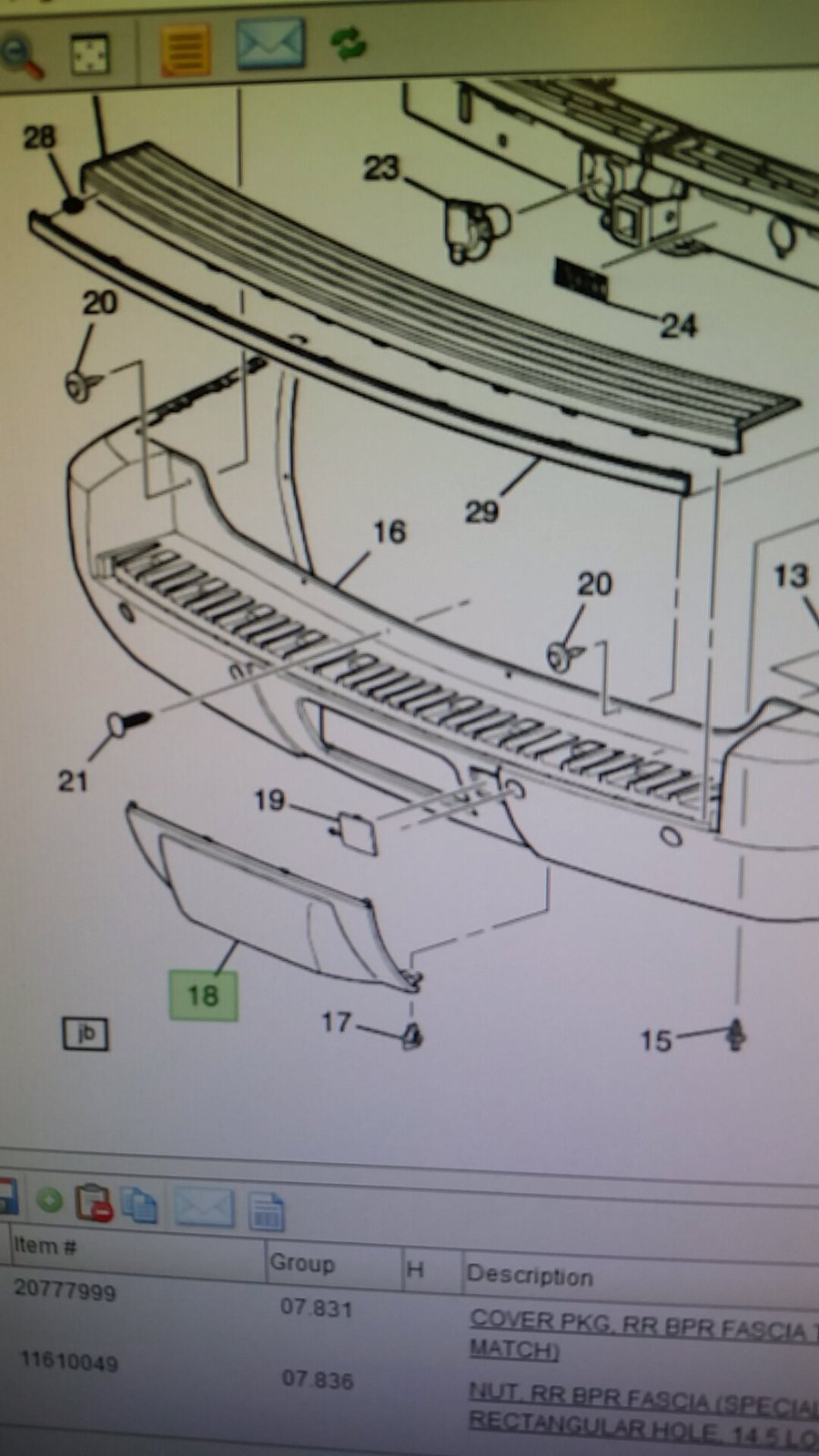

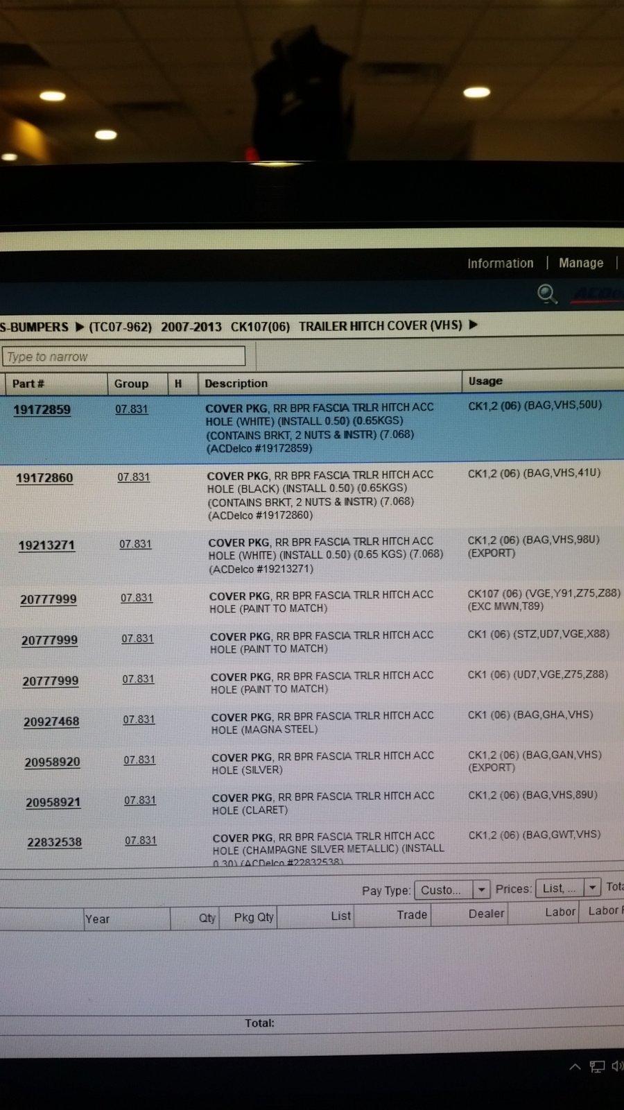

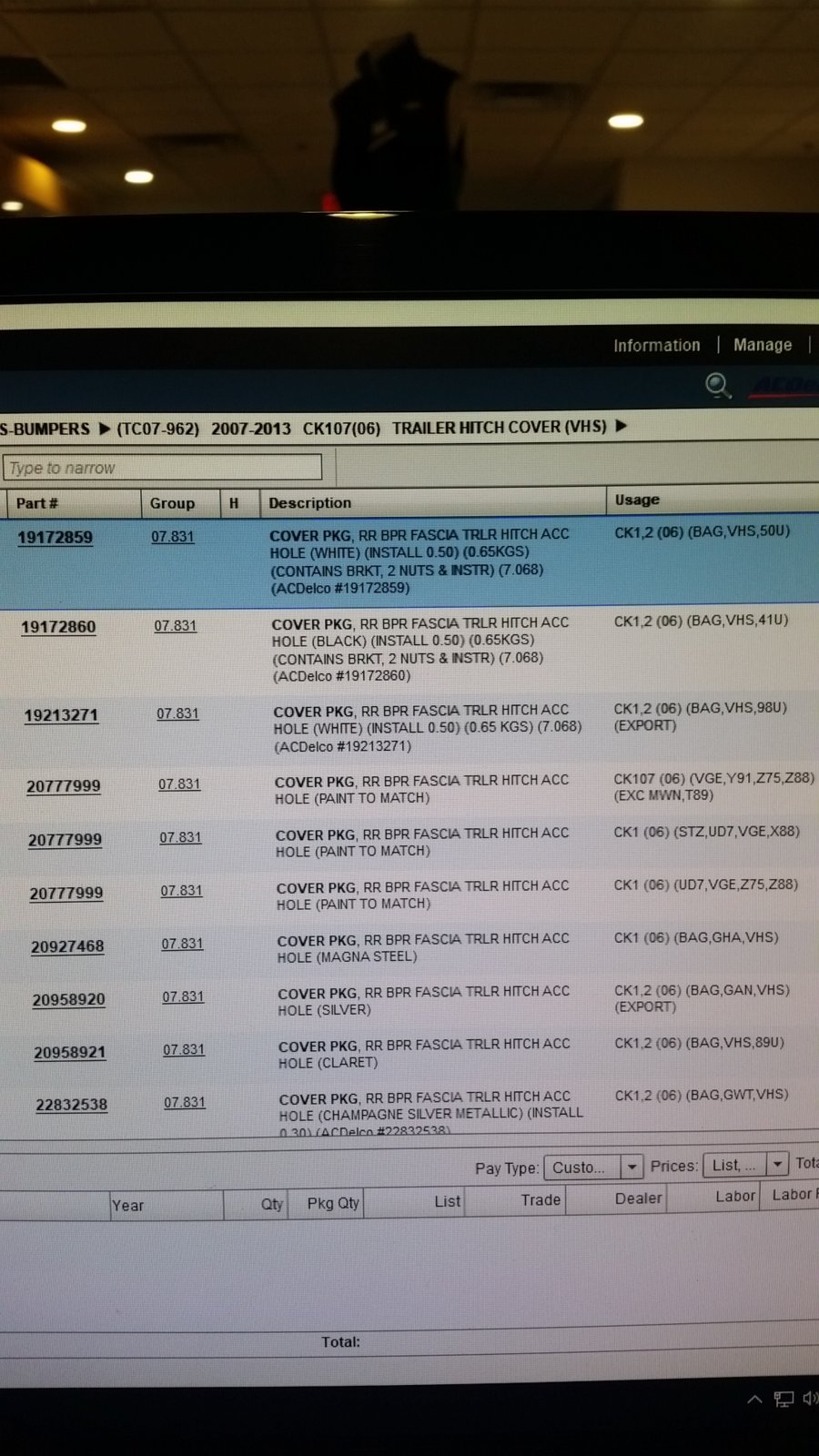

GM# 20777999 cover pkg (paint to match)
GM# 11610049 bolt x2
this is the only one i see from 07-13

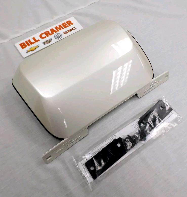

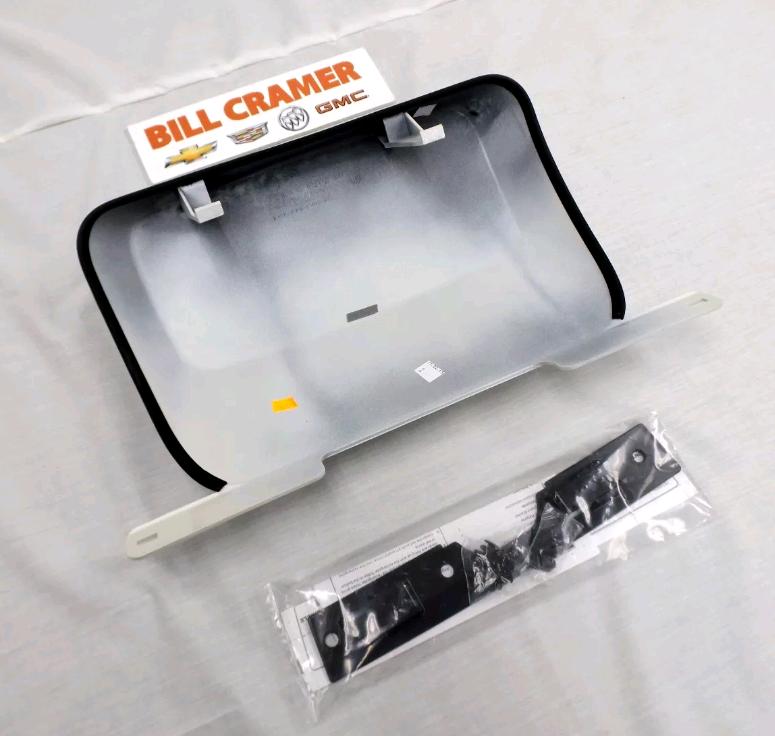

i found this one as well, these are covers that are pre-painted to the truck.
gm#'s are provided, hope this helps
View attachment 214100 View attachment 214101

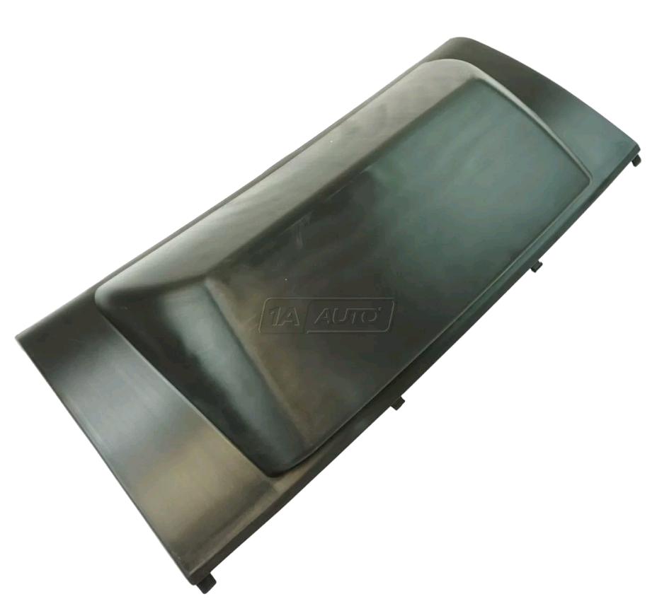

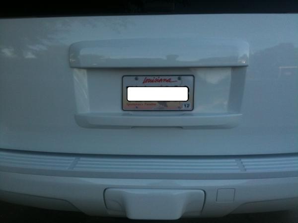

This is the same one I posted first and is for the '07-'08 style bumpers.
The other one you posted is for the '09+ style bumper.
'07-'08 has no chrome strip on the bumper pad.
'09+ has the chrome strip on the bumper pad and the ends of the bumper by the wheel well is shaped slightly differently.
The obvious difference is the centers of both bumpers around the hitch.
This is all in reference to the LTZ bumpers.
