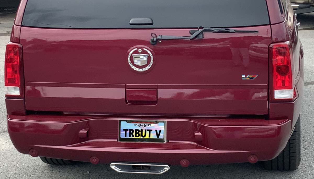

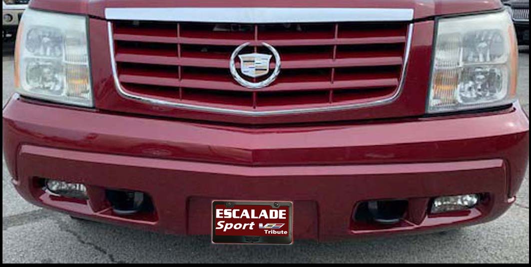

Got the 'Clade registered today with a vanity plate. Won't be here for a few weeks; but this is how it will look. Since MS doesn't issue front plates I got one that's personalized off ebay.

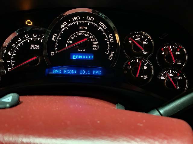

On very pleasant surprise is we are getting amazing mpg. I reset the ave. mpg when we filled up before starting home. On the trip home from N. AL we averaged 21.7. I was so shocked by the number at first I thought maybe the tuner had not recalibrated for higher volume injectors. So, I did a manual calculation of miles driven divided by gallons to fill-up and came up with the 21.7mpg for the all highway miles tank of gas. Since then we've filled up twice and have done about 20% highway and the rest very stop-and-go town traffic as this week is "Cruising the Coast" here and we've been out cruisin' everyday. Below shows we are averaging 18.1 for mostly town driving. I know its hard to believe. But the fuel economy of this LS364/450 engine as setup and tuned is pleasantly amazing! Couldn't be happier. And ........ its faster than a scalded dog!

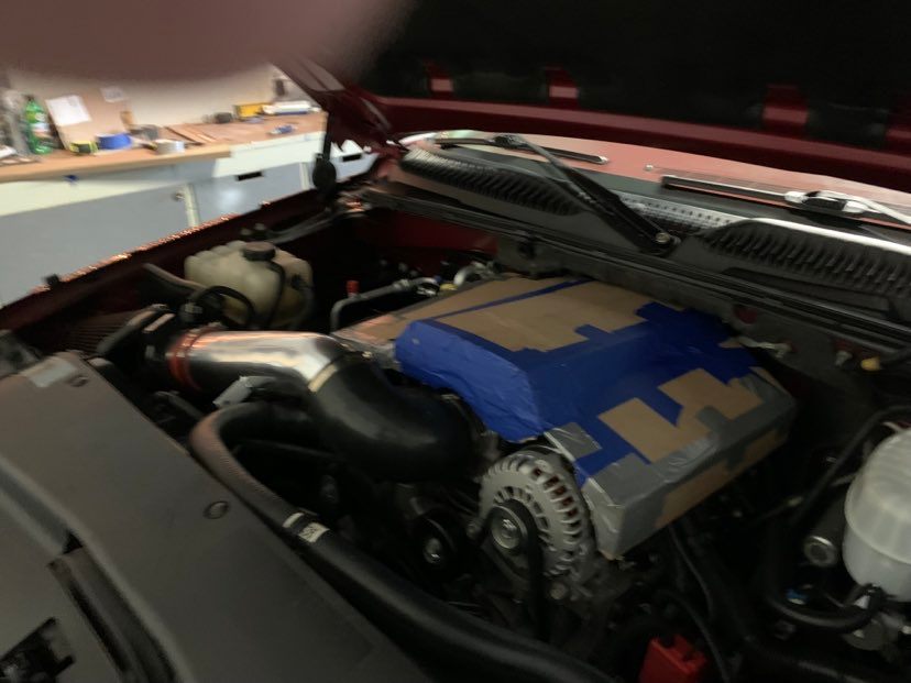

It's been a few weeks since we got the Escalade back from the builder. It needed a few tweaks. HVAC was being weird so I changed the cabin air and ambient air temp sensors, which fixed it. Replaced the 18" magnaflow with a 24", which almost completely eliminated drone. Had the suspension tweaked and shorter bump stops installed up front. Upgraded the security sytem and had the radio reinstalled (even I could tell the first insall was not done well.)

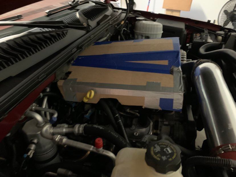

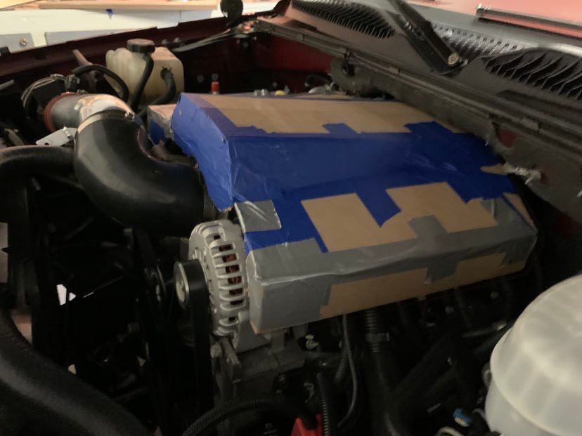

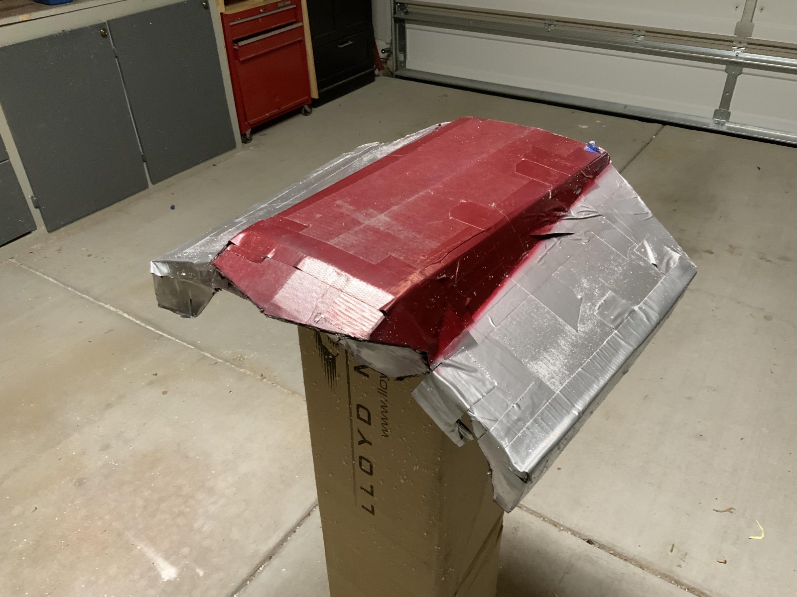

So now I'm moving on to some fun stuff. I've never cared for the engine cover that came on Gen2 Escalades. Its curvy styling doesn't match the linear lines of Gen 2s. Nor do I like the bland engine covers on the Gen3. They are just too utilitarian. So, I'm going to try designing and making one. My idea to to make on that is linear and which hints big block and scoop. Below are photos of my first try at a cardboard mockup. Once I finalize the design I plan to make one with fiberglass and if I like it I'll do a second in carbon fiber.

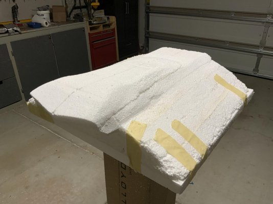

The work continues on a new engine cover. Here are photos of the mock-up and plug. I made the mock-up for style design and to assure fit. It is also the model for the styrofoam plug, which will be used as a mold for fiberglassing. I still need to cover the plug with drywall mud or bondo for final design style and finish, then paint it, and then add several coats of wax before its ready for fiberglass.

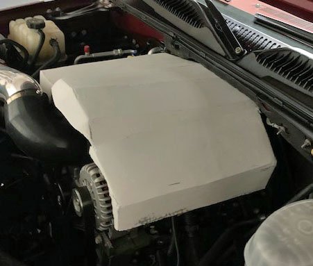

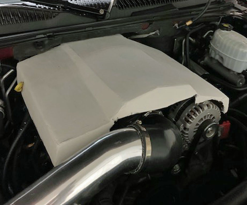

Work continues on the engine cover. This is the rough finish mold on the engine to confirm general fit. I'll need to do some trimming for hoses and cables and add openings for the oil fill and transmission dip stick. I'll do all that on the actual cover. Next, comes bondo, primer, gelcoat and wax. Then I'll be ready to do some fiberglassing to make the final mold.

45,012
I like the incorporation of the angles with how they fit the body lines. That front mimics the grille.

MS Gulf
Thanks for noticing. That's the look I'm after. The Gen2 bodies have great angular lines that remind me of the sharp angles on the stealth bomber. I tried to incorporate similar lines into this design.
Finished the plug used to make the fiberglass mold for the new engine cover.

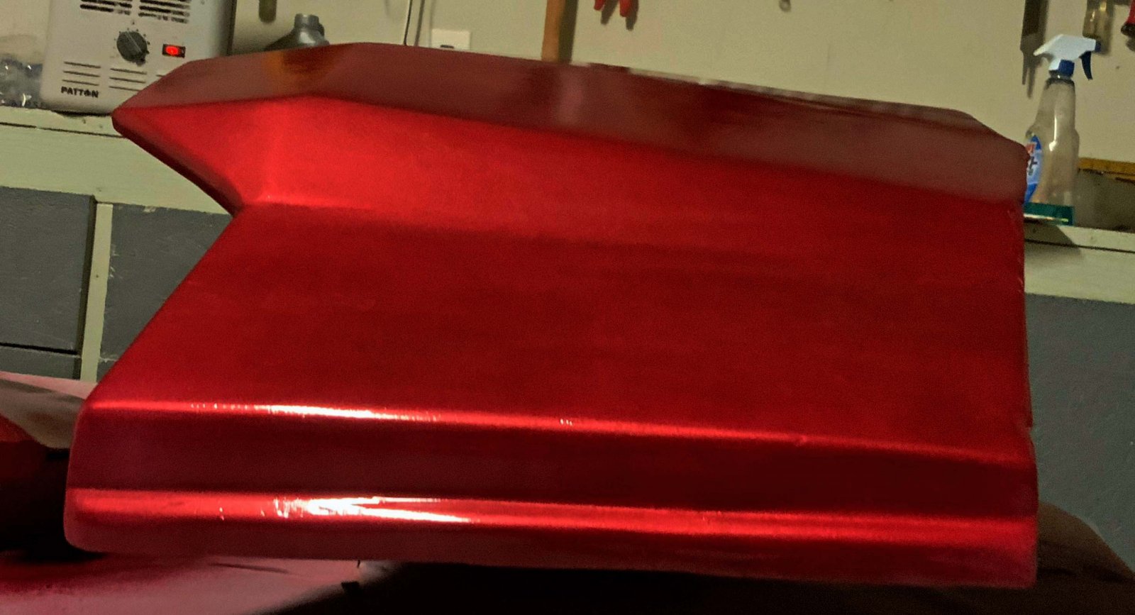

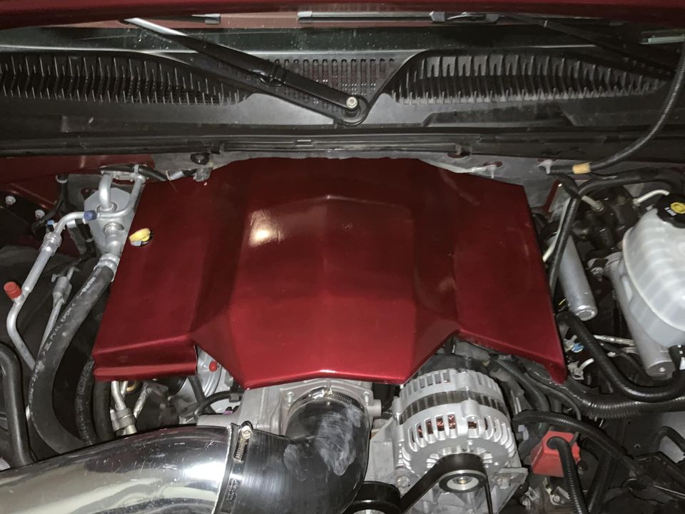

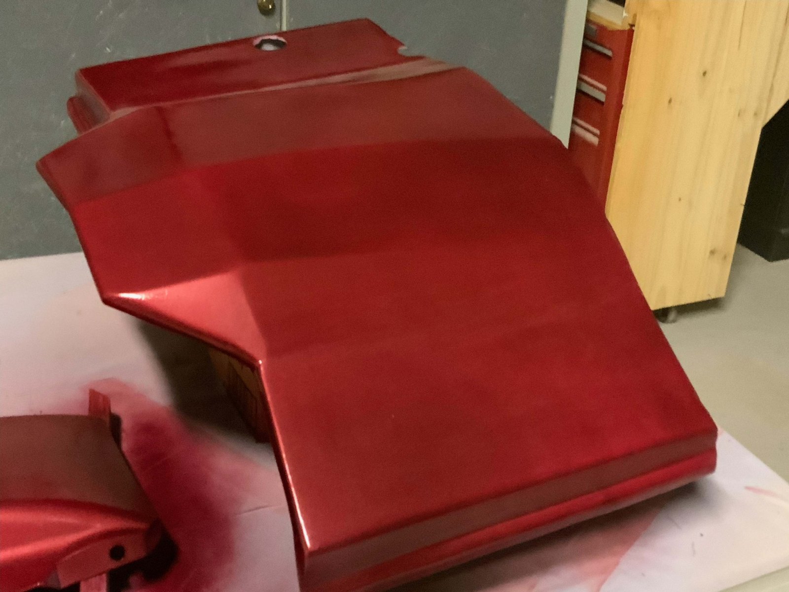

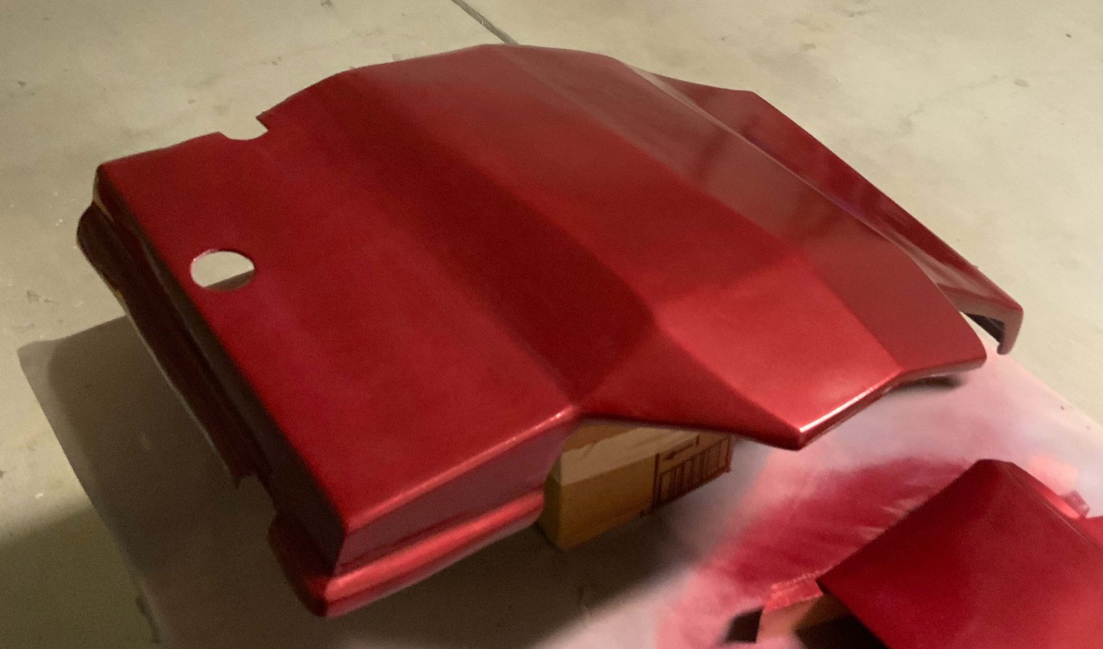

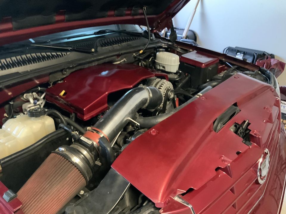

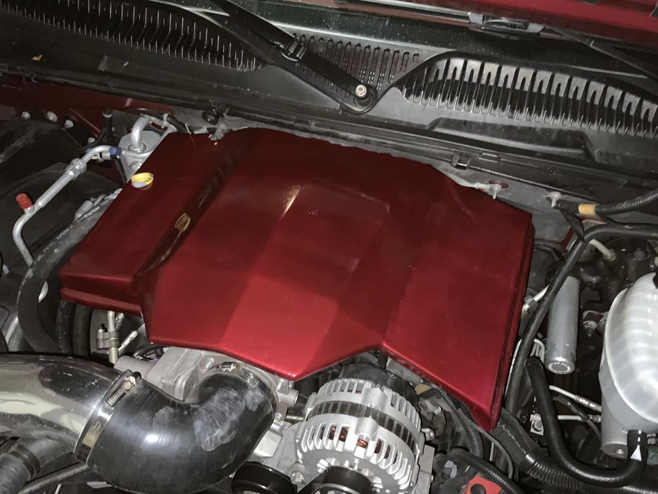

After some mistakes and start overs, I finally managed to fabricate a new engine cover. Just finished painting it. Here are photos

Engine cover looks really good.
