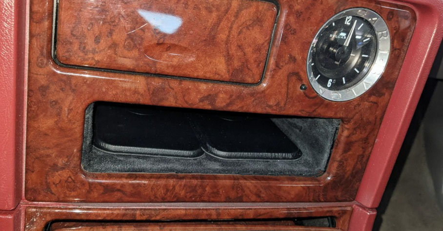

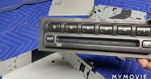

Losing CD changer/gaining wireless charging station
Next upgrade is converting 6cd changer space into a dash pocket as shown in the video (shown below). Interior dimensions are 7"w x 7.5"d x 2"h. The dash pocket will be used as a cell phone wireless charging station. To do this we will install two USB ports and two 15W JADA Qi-certified fast charging pads. Dimensions of the charging pads are: 6.22 x 3.23 x 0.2 inches. Will post photos when completed.
youtube.com
Converting/Eliminating 5 CD changer 04 Denali into a storage POCKET /TRAY.

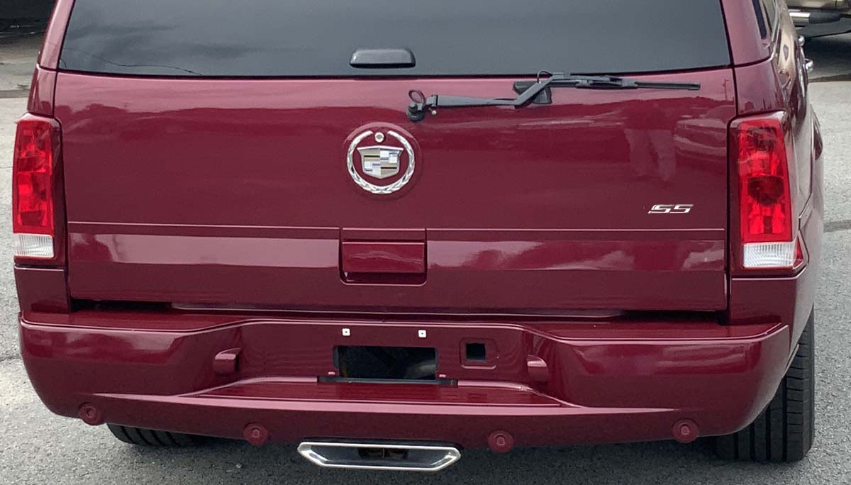

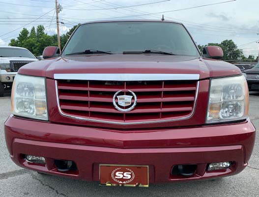

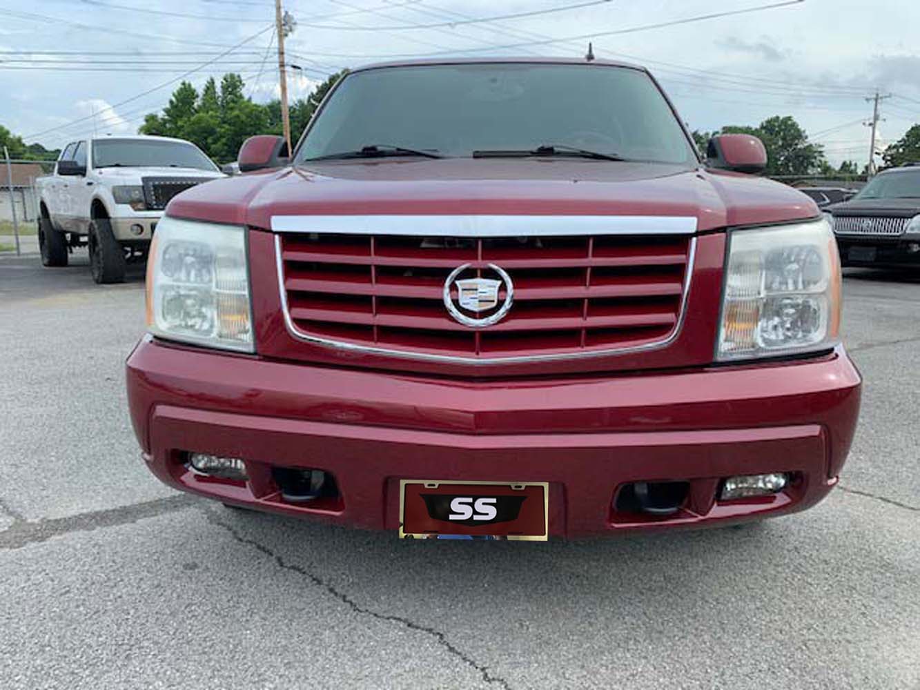

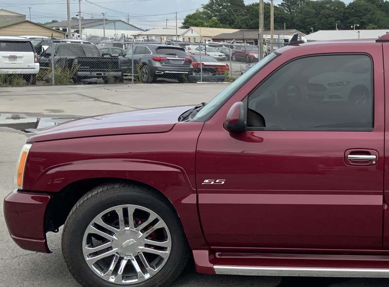

I have debadged all the Escalade emblems on my '06 and am toying with the idea of replacing them with SS badges. I know some of y'all prefer a completely debadged look. I do not. But neither am I fond of the Escalade badges. So, I'm thinking of adding SS badges to signify the upgrades and modifications we've done. I thought of using V series badges but decided not to after I read the specs and saw the performance videos of the "23 Seclade V Series. Frankly, my build is not up to that level; and, I don't want the grief that I'd expect to get from putting V-Series badges a non-supercharged, lower horsepower Escalade. However, the GM Performance Engine and many upgrades we've done are in-line with engine and handling upgrades GM Performance adds to make stock models into SS models. So I figure, why not? If people ask why the SS badges, I'll tell them this is my idea of what GM Performance could have done back in '06 had Cadillac decided to make an Escalade SS model. My photoshop skills are pretty poor, so the the scale is not correct; but here are some photoshopped images of how it will look. BTW I made the front license plate fillers using photoshop. Can't decide which I prefer. Which do ya'll like?
I don't think it looks bad. Maybe just 1 rear emblem instead of the ones on the fenders. It's your ride, so who cares if someone will complain that it isn't a real SS. It's a 1 of 1--Custom build.

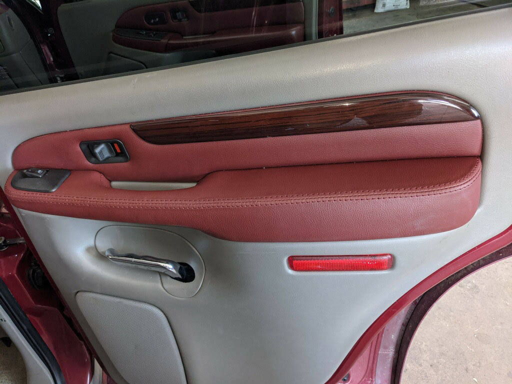

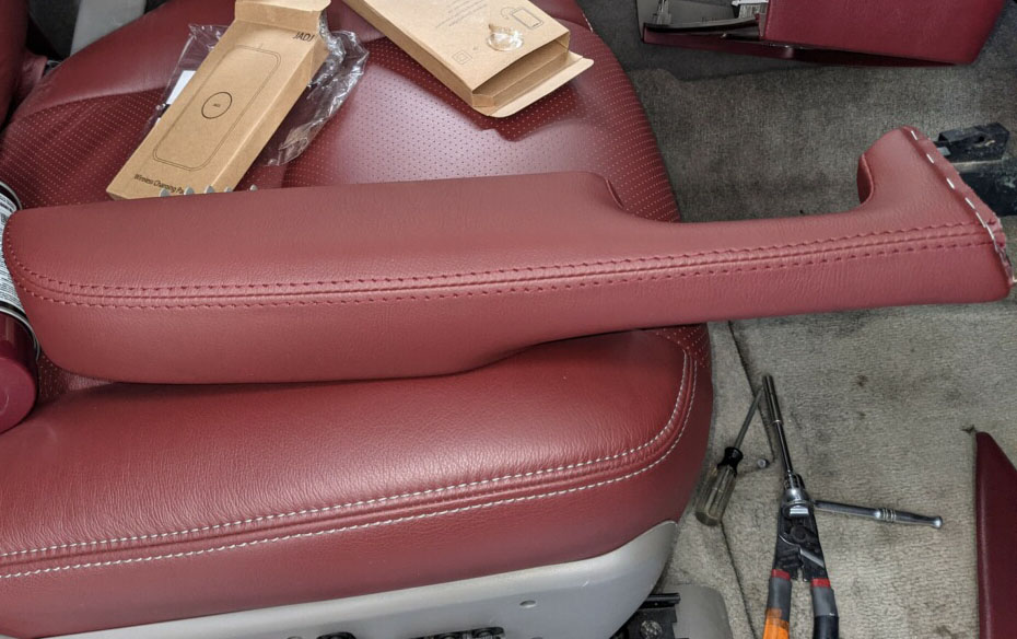

When the armrests were dyed the color shade didn't exactly match the leather upholstery. So we decided to go ahead and have them covered with the same material as the seats even though the shape and of the grab handle made doing so a bit complicated. But, I think the result is amazing!
BTW the two flat boxes on the seat contained cell phone charging pads. We removed the 6cd player and are converting the space to a two cell phone charge station. I will post photos when its done.
BTW the two flat boxes on the seat contained cell phone charging pads. We removed the 6cd player and are converting the space to a two cell phone charge station. I post photos when its done.
They did a great job on the armrests, like the rest of the upholstery work. Must be costing you a small fortune!

You can fit a standard single DIN pocket in place of the CD changer. I removed the brackets off the changer, installed them on the pocket, and reinstalled the pocket. Worked out slick.
Yeah, I looked into that. My concern was the din pocket I found was more shallow than the CD Player holder. I wanted the pocket as deep as possible to be sure my present phone and future phones would fit in all the way. Probably isn't an issue, but I just wanted the little bit of extra depth.

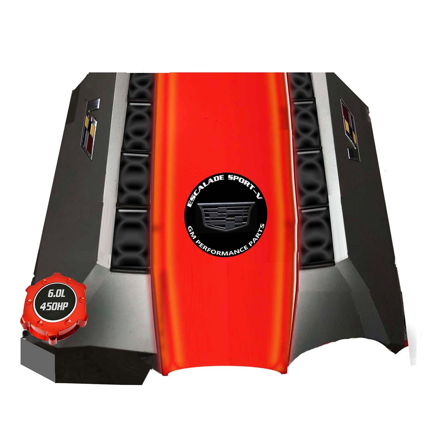

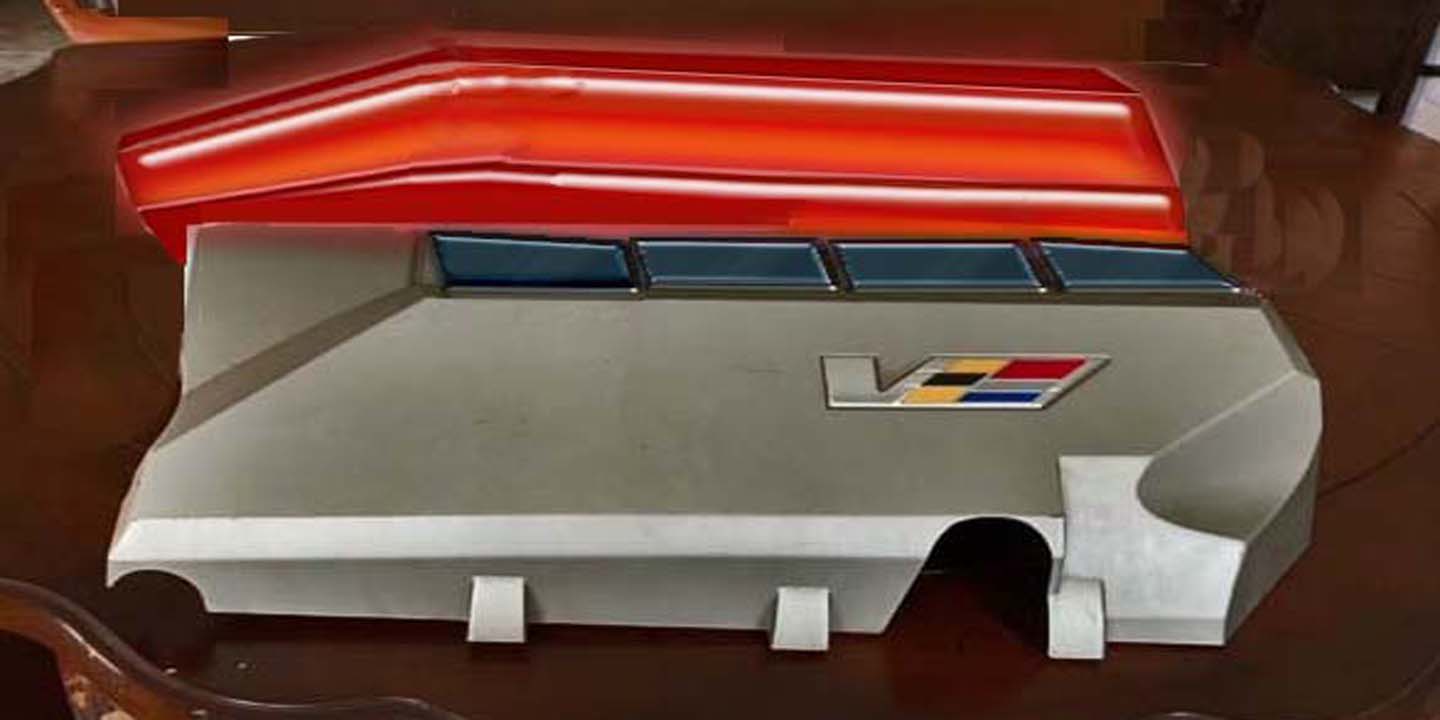

For me the little things, the last 2%, makes the difference. Case in point is the truck style engine cover that now covers the truck manifold (but not the coil packs) on my 06 Escalade. Wasn't really happy with its style even after some paint and decals. It doesn't cover the coil covers. Not a fan of the OE 3 piece covers either, even though they do a good job of hiding engine clutter. IMO, their curvy style doesn't match the linear angles of Gen 2 Escalades. For a while I've been checking Ebay for a CTSV engine cover at a decent price. One finally came up and I snatched it. Here is a photoshop mockup of how I think it will look once I modify it to fit the truck manifold and do repaint and hydro-dipping.
