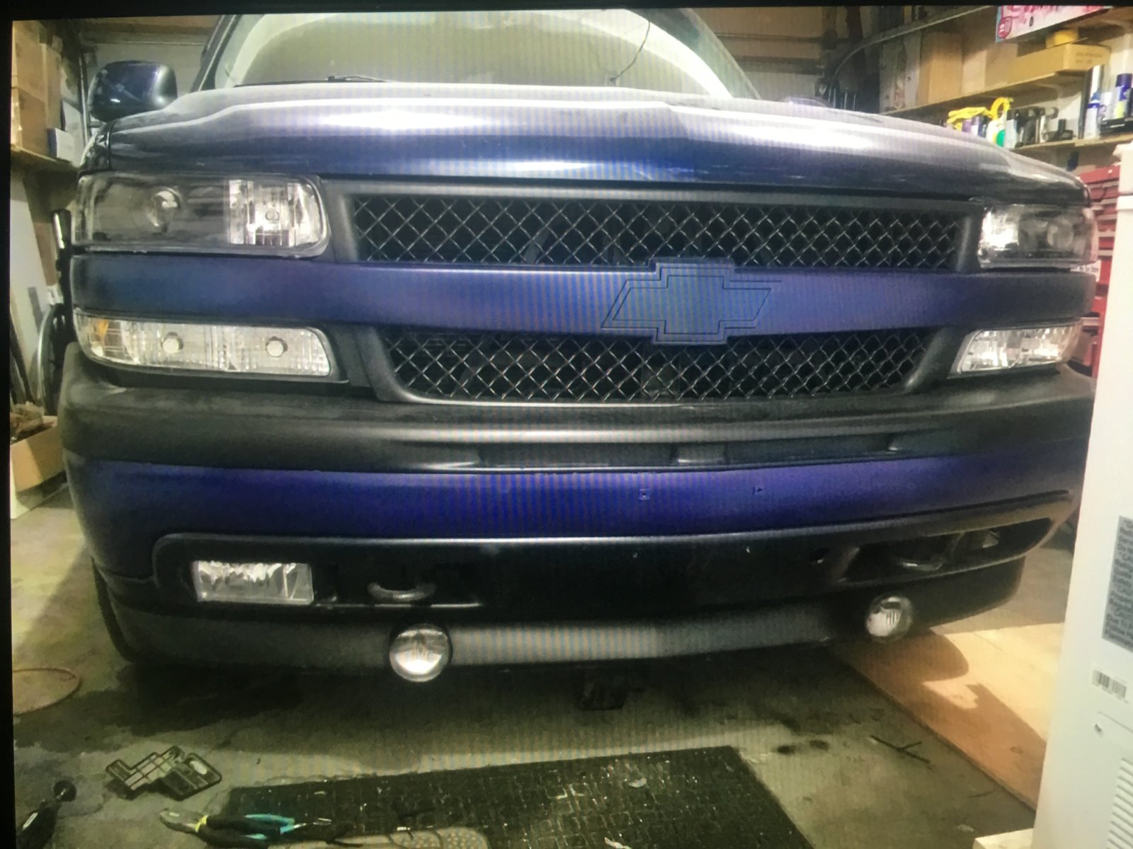

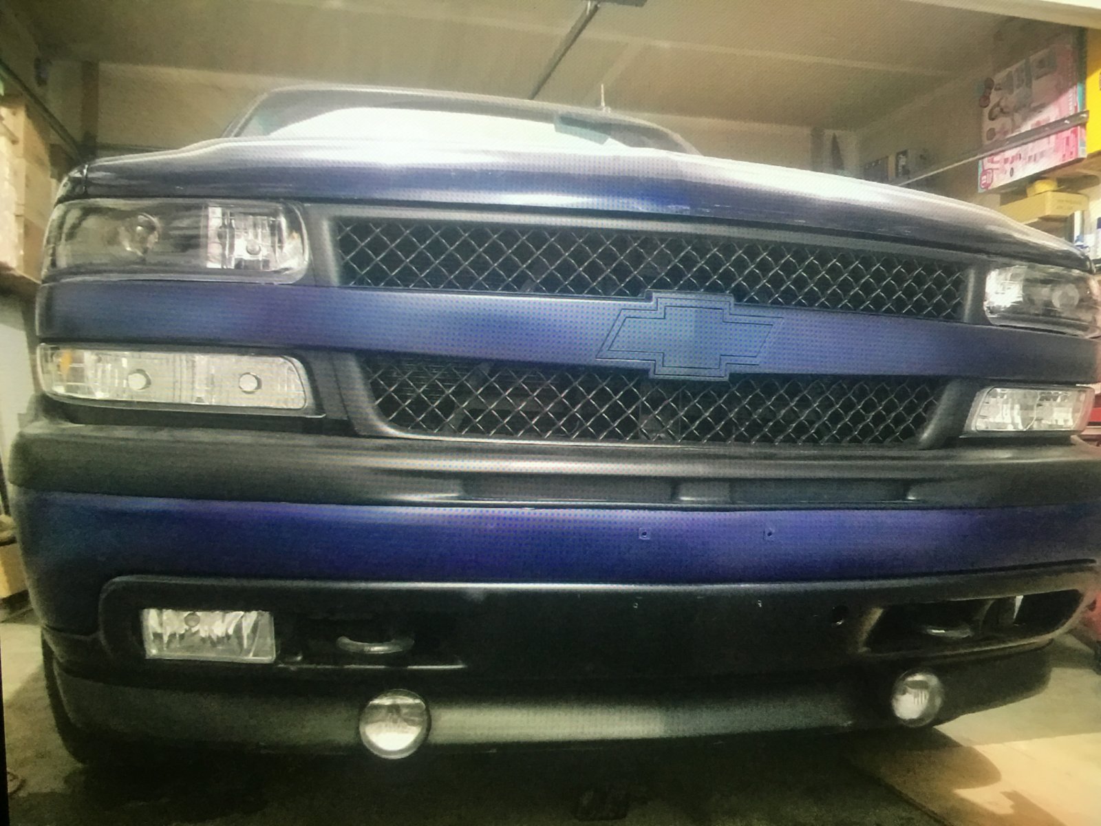

03+ silvy fogs mock up. Not feelin it
Nnbs Tahoe fogs mock up. Not feelin it either.
I come to the conclusion that although with the right execution this idea would work and flow with the front I decided against it.
Don't mind the temporary z71 fogs that I rolled with for few months.

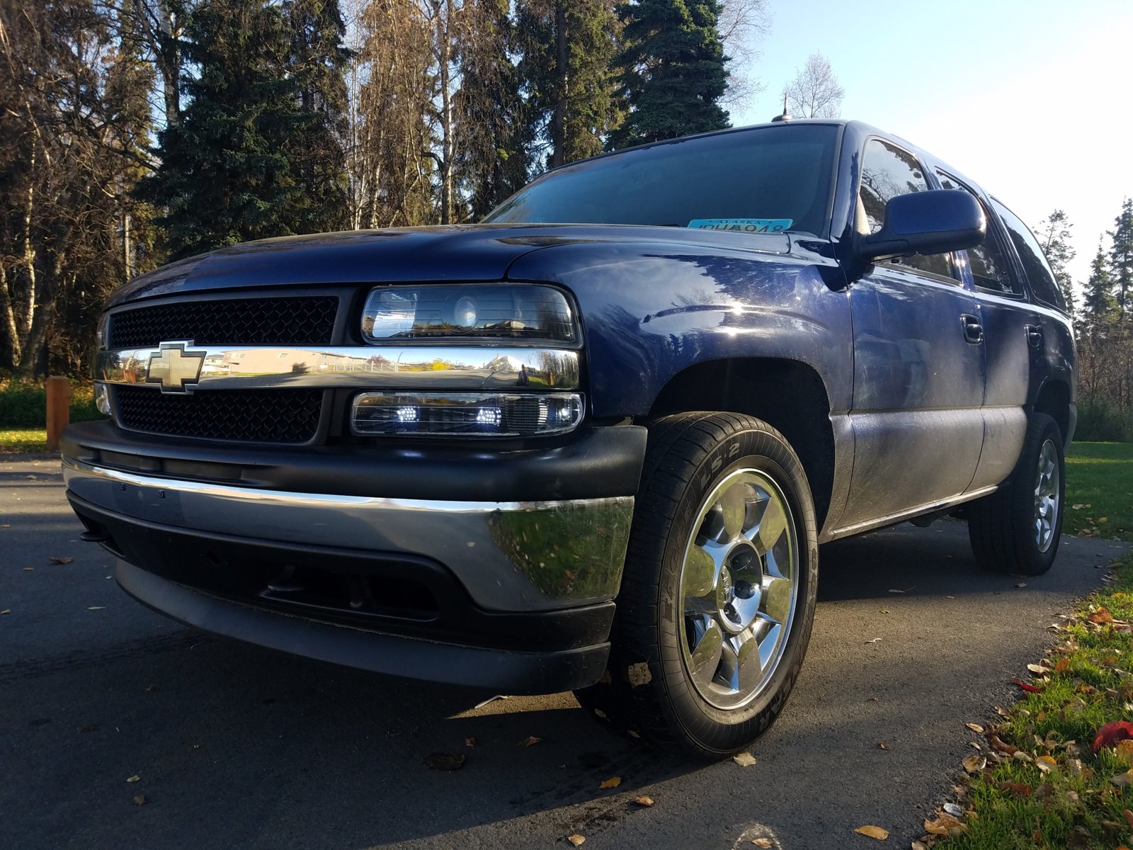

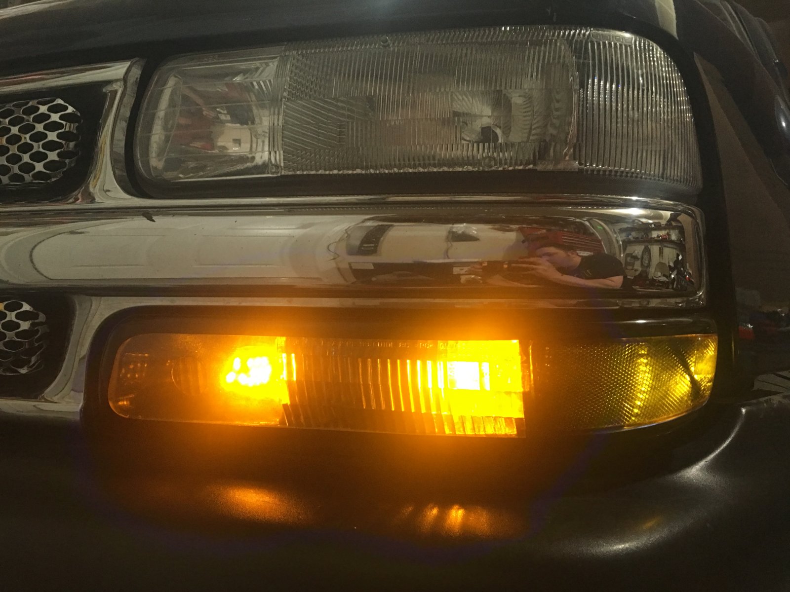

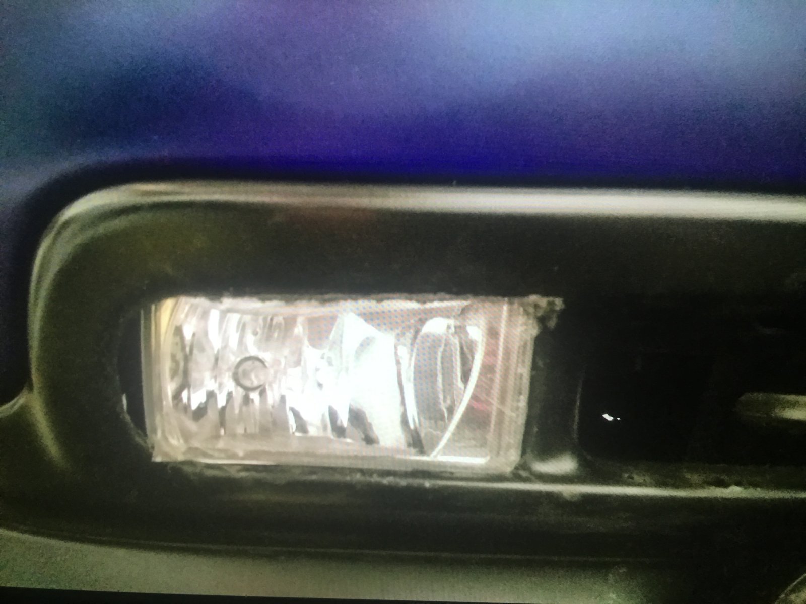

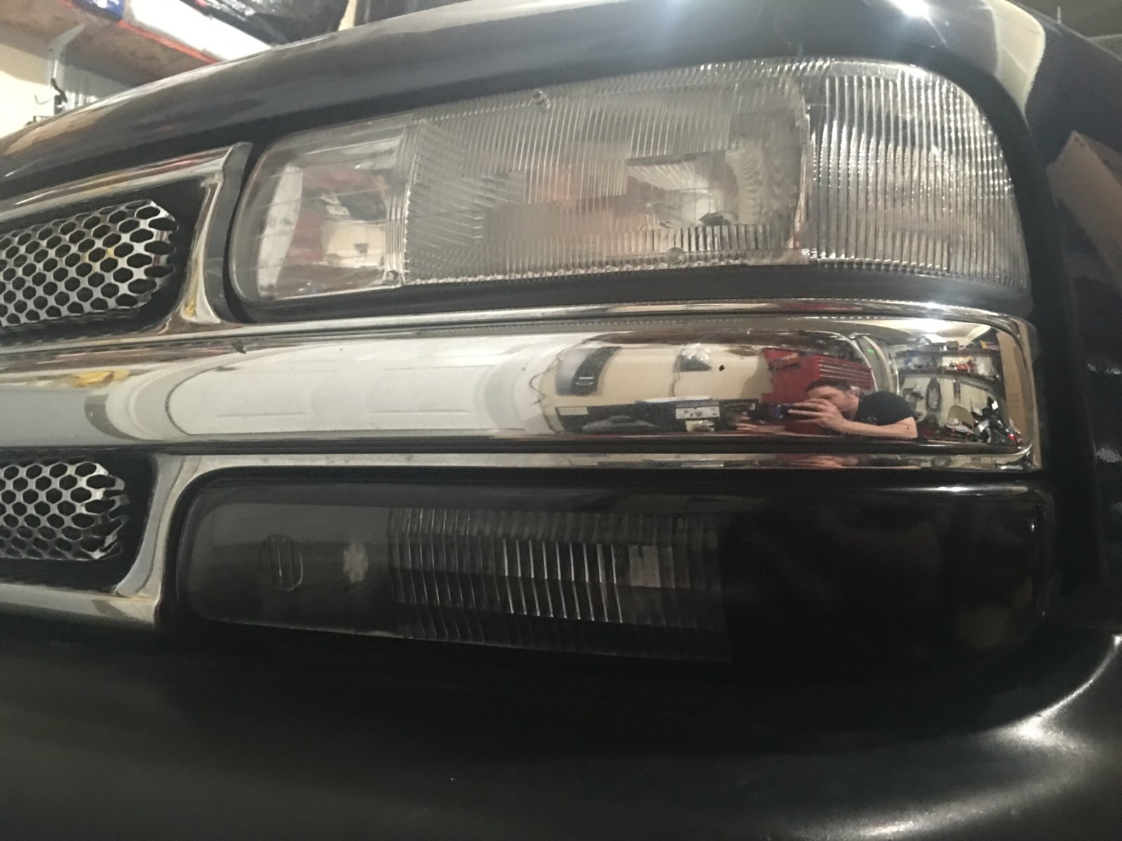

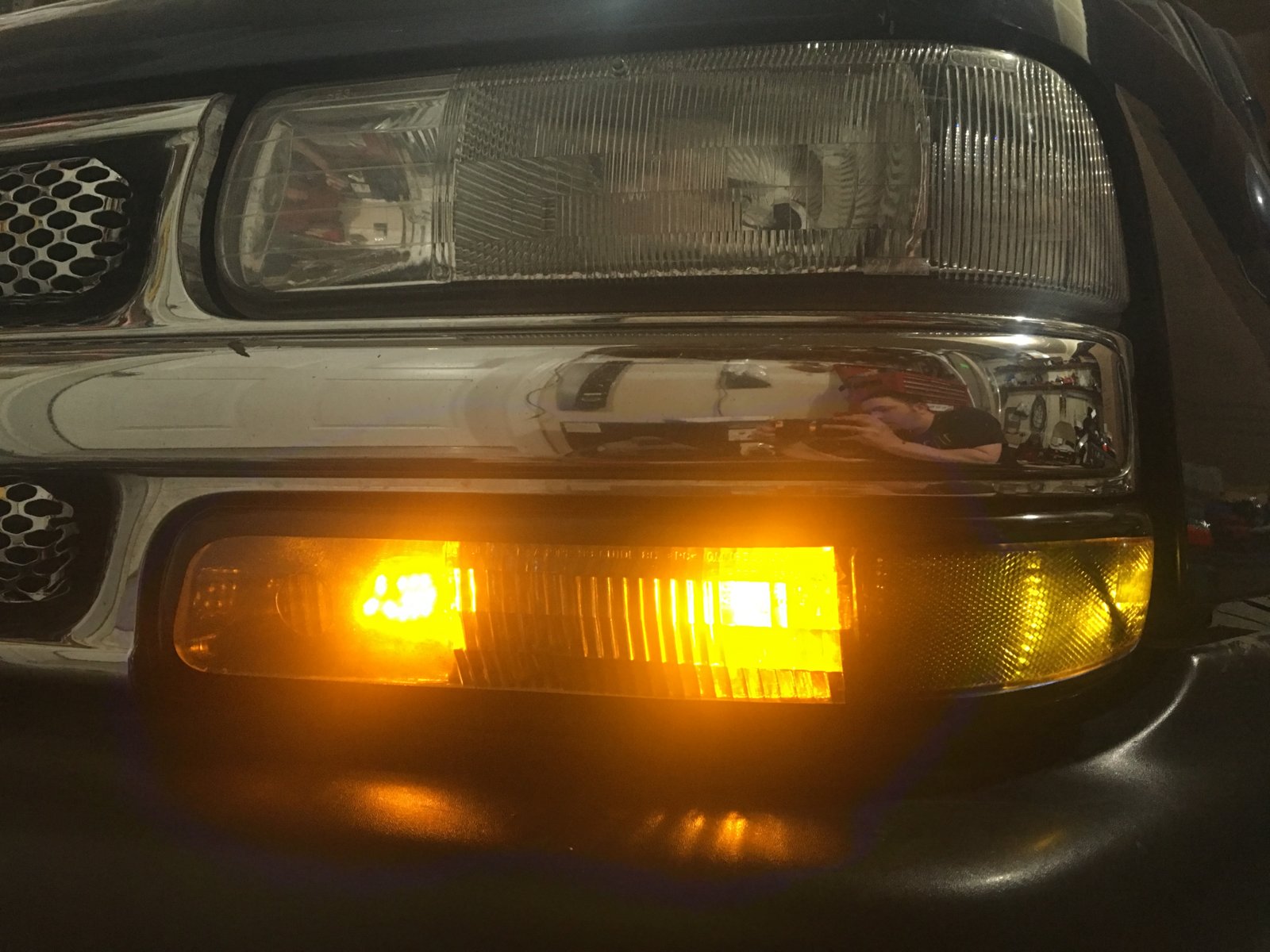

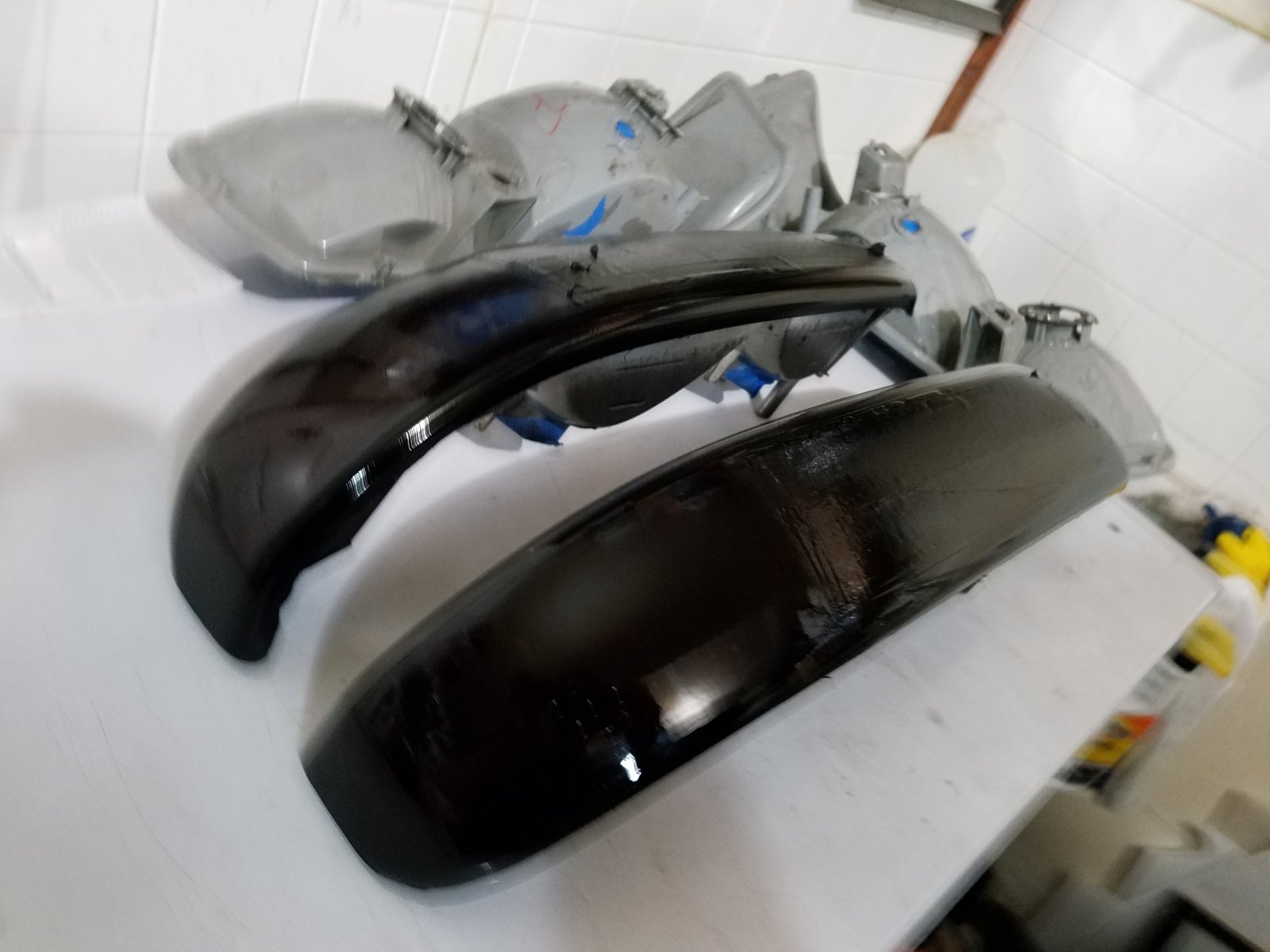

So I played around with the stock parking light housings.
Fyi I tried using some butyl that I got from home depot. Comes in a roll for $6. Didnt think about how visible it would be against the black housing lol. All good as I planned to paint the border anyway.
Border just duplicolor gloss black. Then tinted the amber reflector with VHT niteshades. Then followed with a gloss on top of everything.
.View attachment 199007
Wait a minute...you painted the reflectors black AND tinted the lenses? Looks cool but do they still work good.

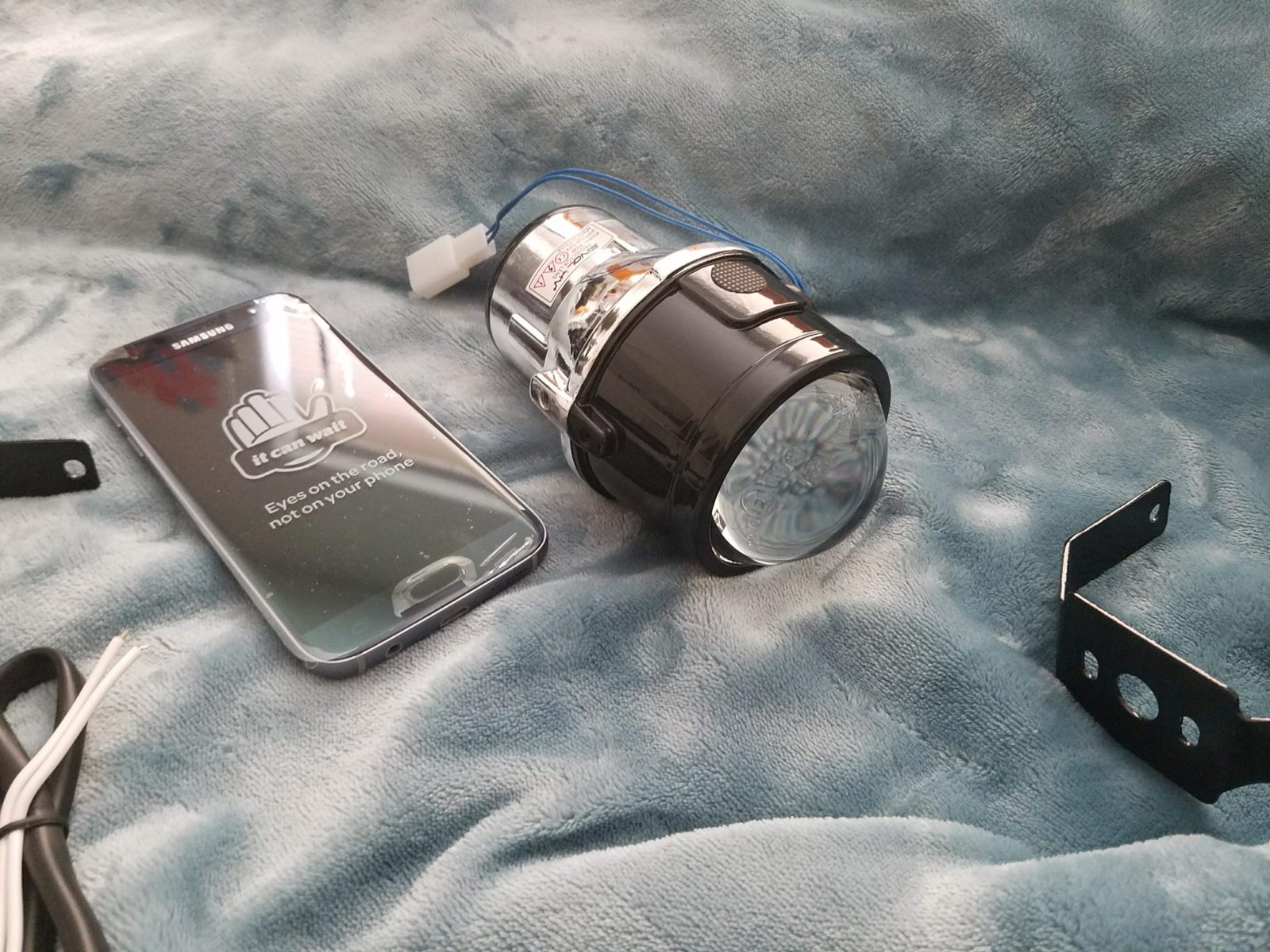

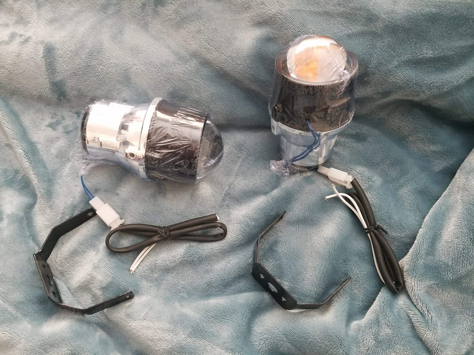

So after more thought both these fogs look good and are bright , but I decided I was over the outdated halogen style housing fogs and got these instead
Bi-xenon hid compatible projector fogs for a more modern look. That's right , high and low beam :smoke2:
Now I know it's around peg going in a square hole but I don't think they'll stick out like a sore thumb with both the projectors and valance being black.

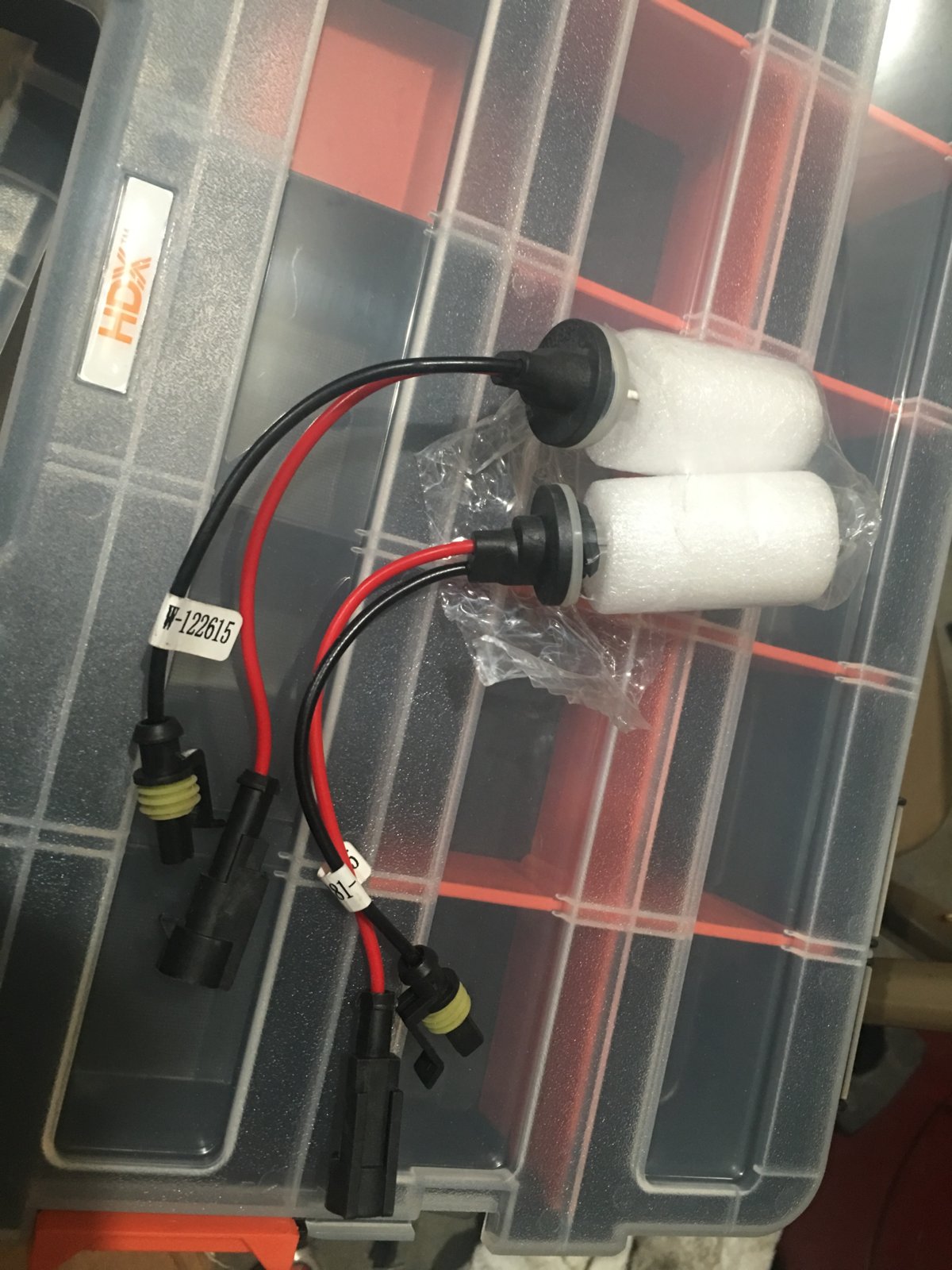

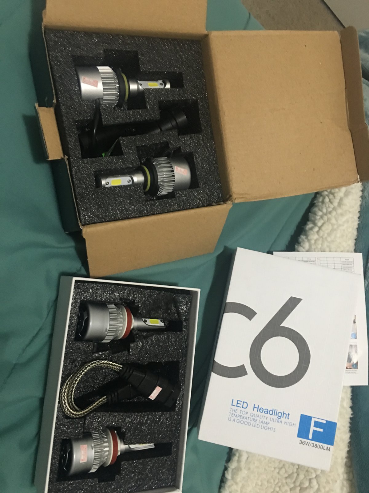

Got new H11 hid bulbs (5000k) and a set of LEDs too (H11 and 9006). I know leds are not ideal for projectors but they were a good deal and I'll eventually throw them in the wife's car anyway .

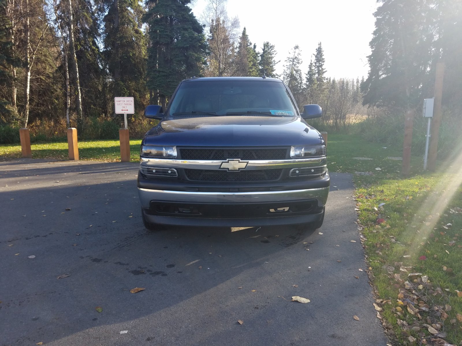

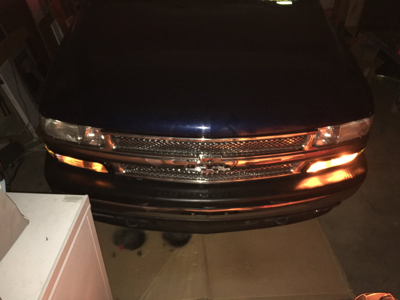

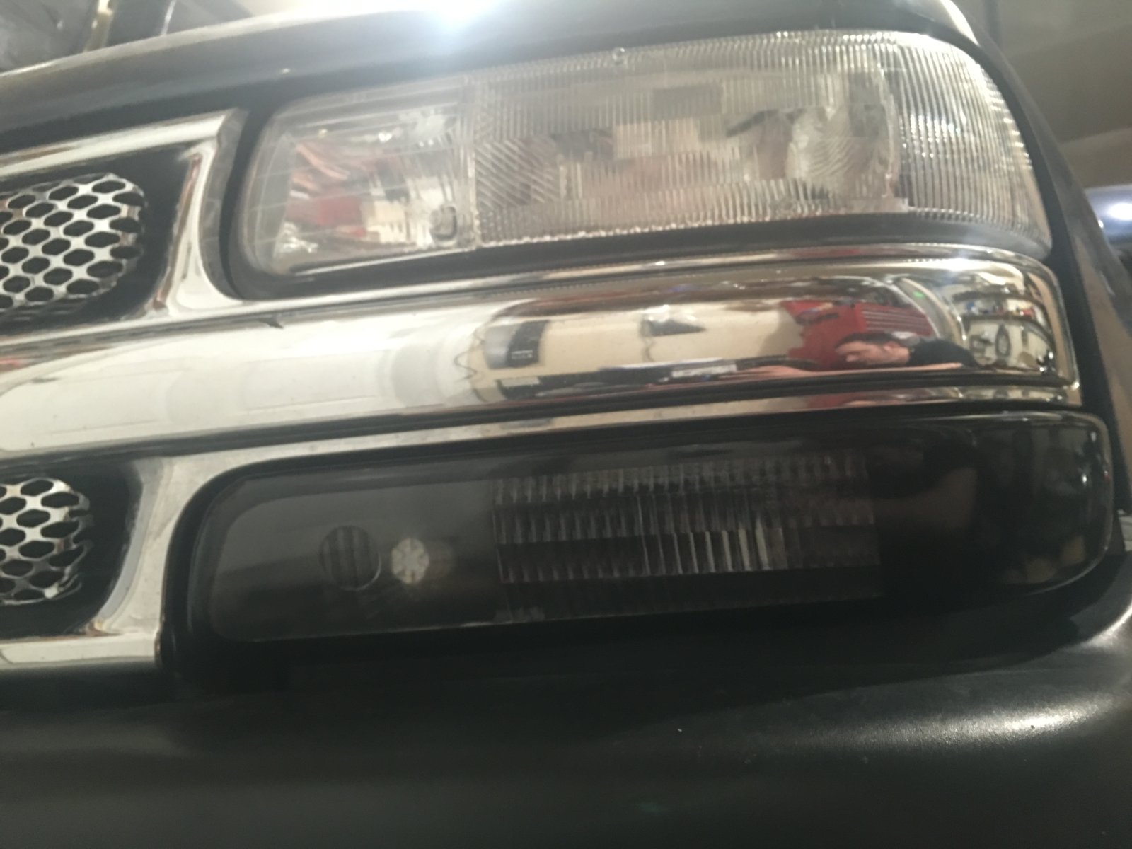

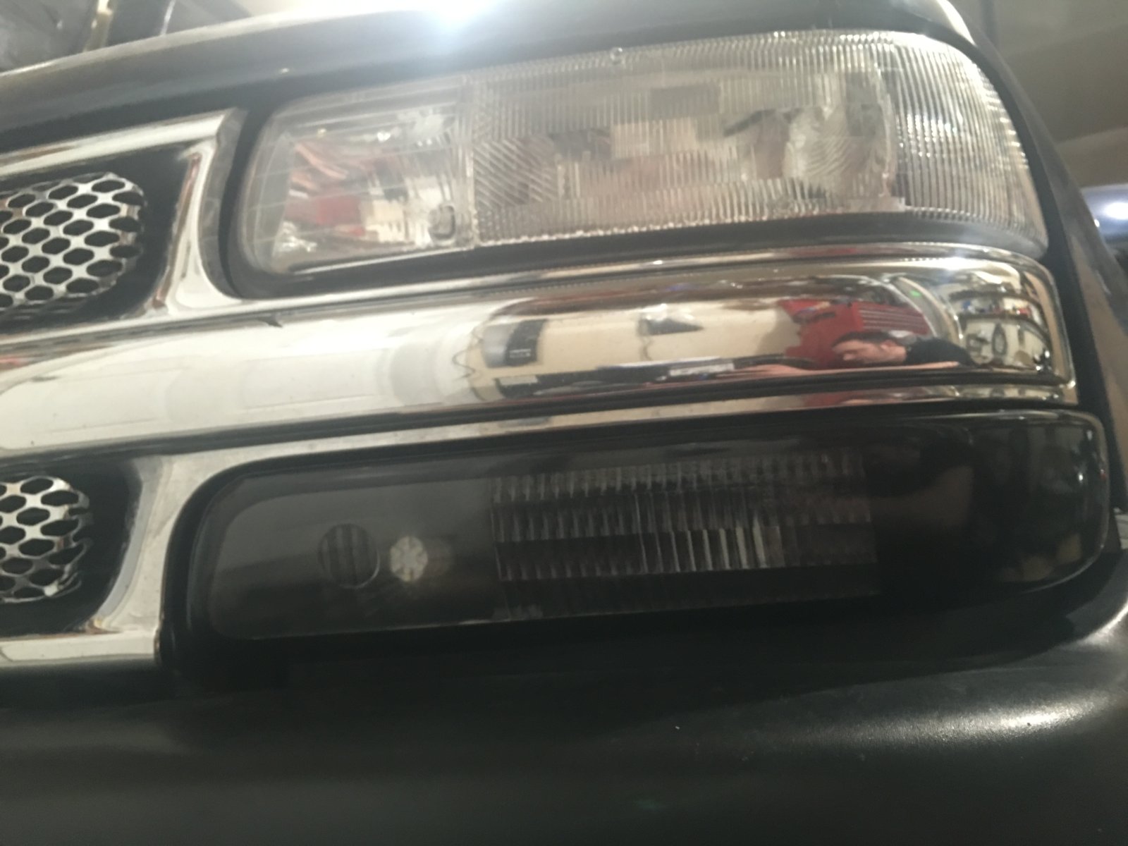

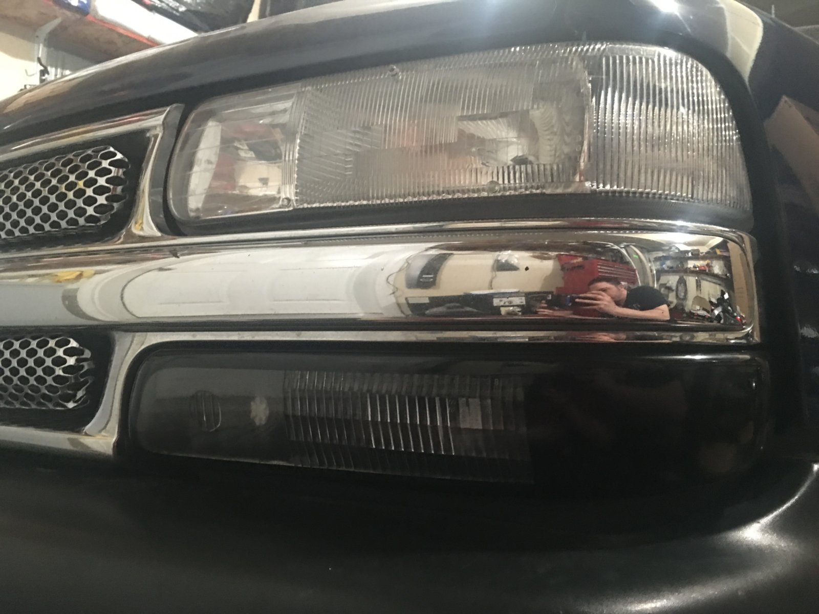

Housings oven cleaner trick turned to black ,lens border painted black, lens clear , Amber reflector tinted
Also wired up the corner marker light to light up with the turn signal and not the parking lights.
Also these are another temporary mod till I figure out what I want to do with the turns...I have another set already baked open. I sold my last clear turns I had in before.
52,956
View attachment 199034 View attachment 199035 View attachment 199036 View attachment 199037
They actually look like they work OK, I just thought the actual reflector parts were supposed to stay chrome. Lots of lighting mods happening here!

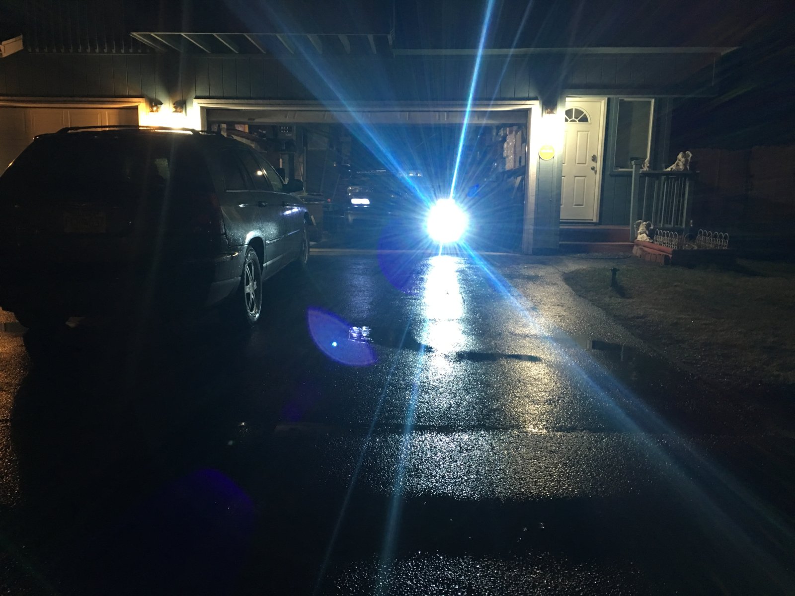

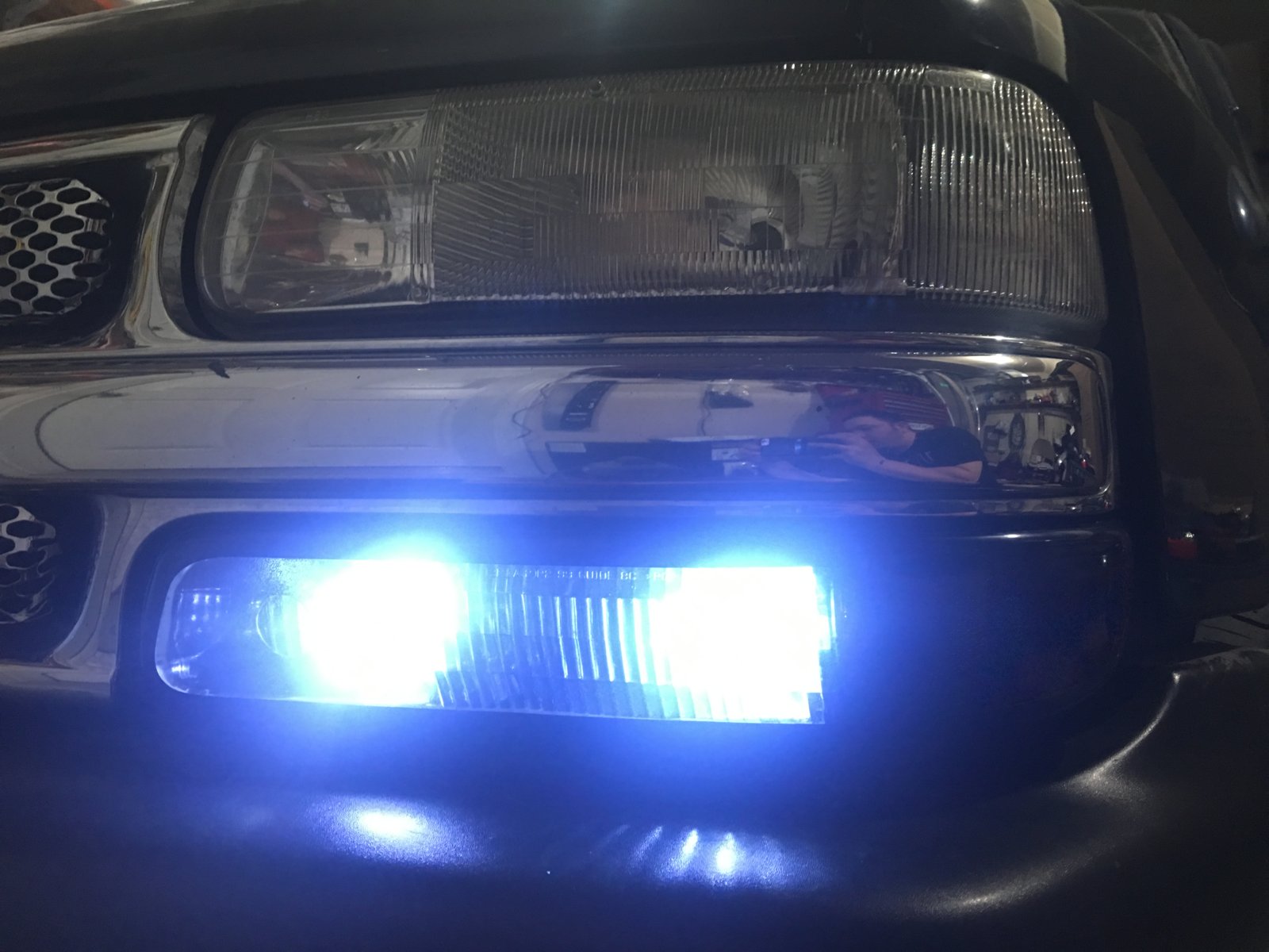

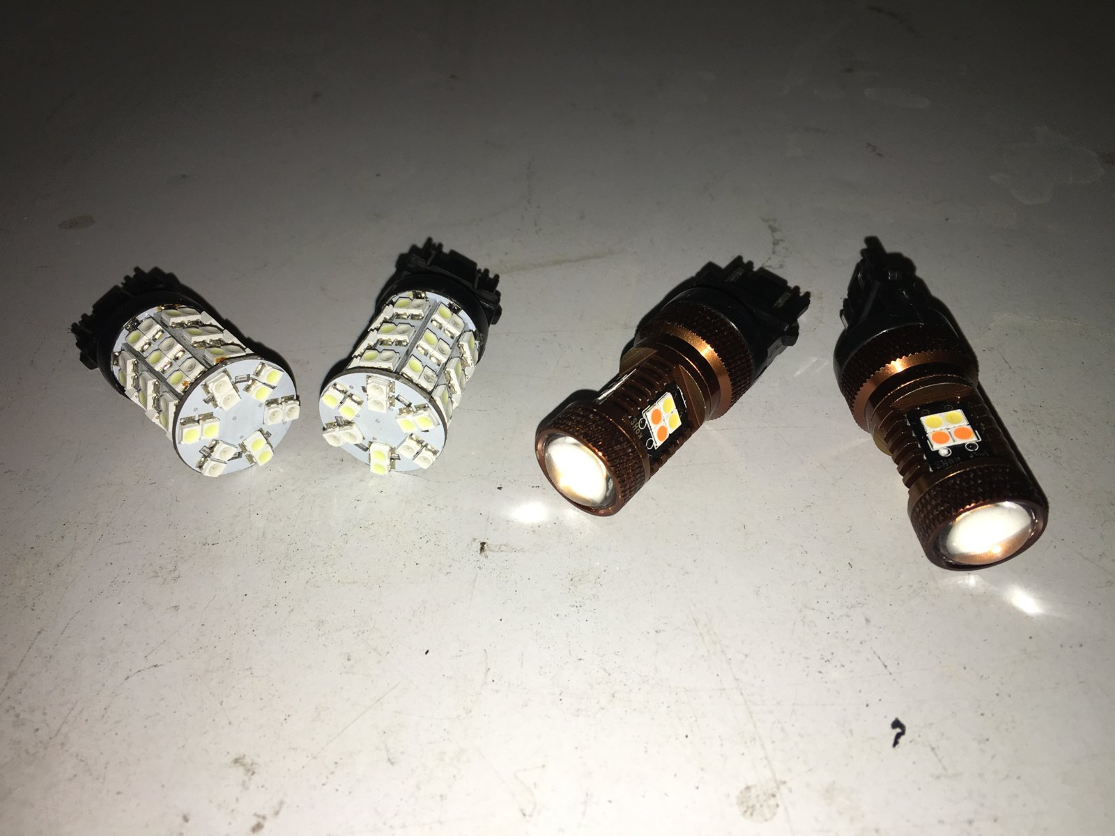

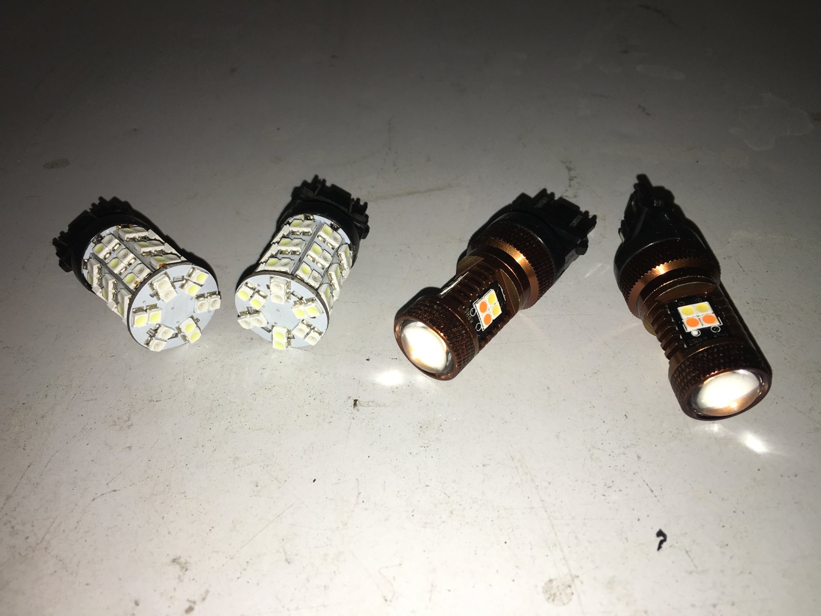

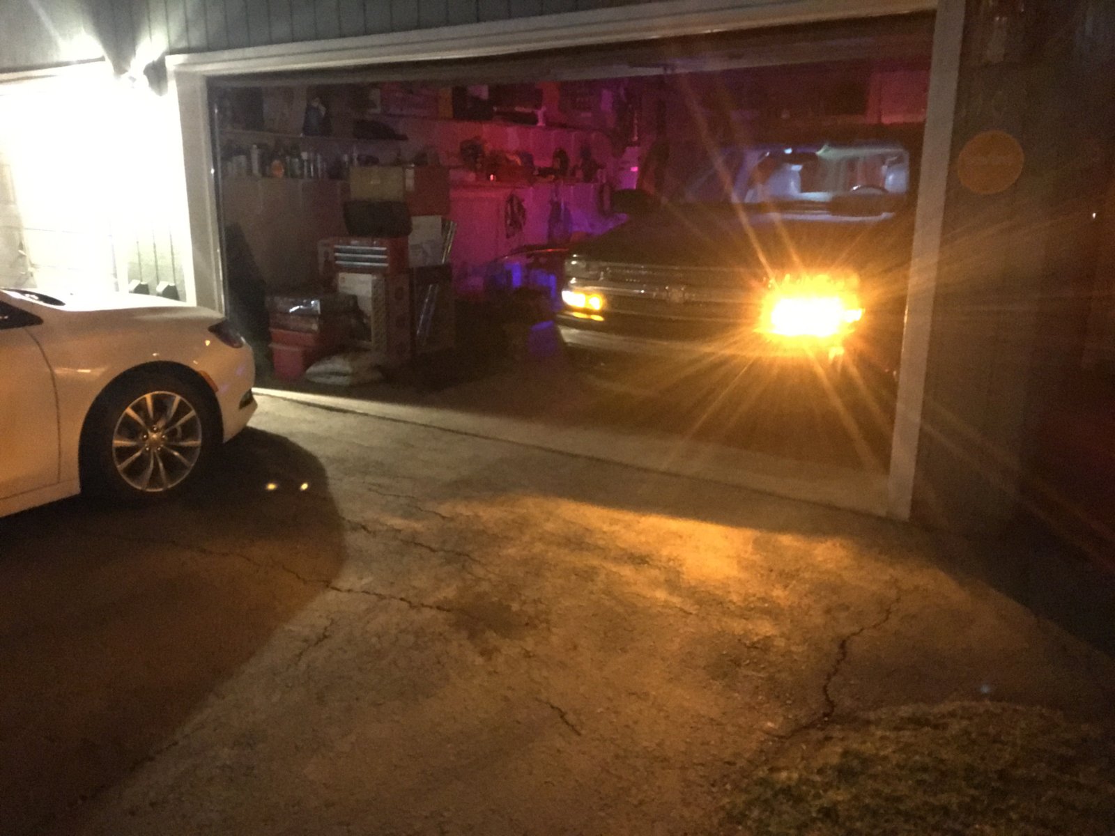

Tried out my cousins Jdm Astars switchbacks. These are insane, I'm sold. Will be ordering 2 sets soon. And these are even in the black housings. Yes the camera exaggerates glare but You can still see difference.
Mine on left 60smd generic switchbacks. Cousins on right. His were black but overtime turned bronze, guess it's a common issue , has no effect on performance of course.
its the exact same style turns on your nali lmao
Mine on left 60smd generic switchbacks. Cousins on right. His were black but overtime turned bronze, guess it's a common issue , has no effect on performance of course.View attachment 199038View attachment 199039View attachment 199040View attachment 199041View attachment 199042
Don't need no stinkin' reflectors with those! I used Morimoto switchbacks in my CC's turns- bright as hell too but they're hella expensive. How much are the JDM's?
The reflectors themselves are still chrome on them, the area around the reflector bowls are black. Not that it makes much of a difference. We just buy the brightest lights we can find!
$30 a pair
As far as reflector , they ugly and I hate them so yea they don't work very well reflecting lol

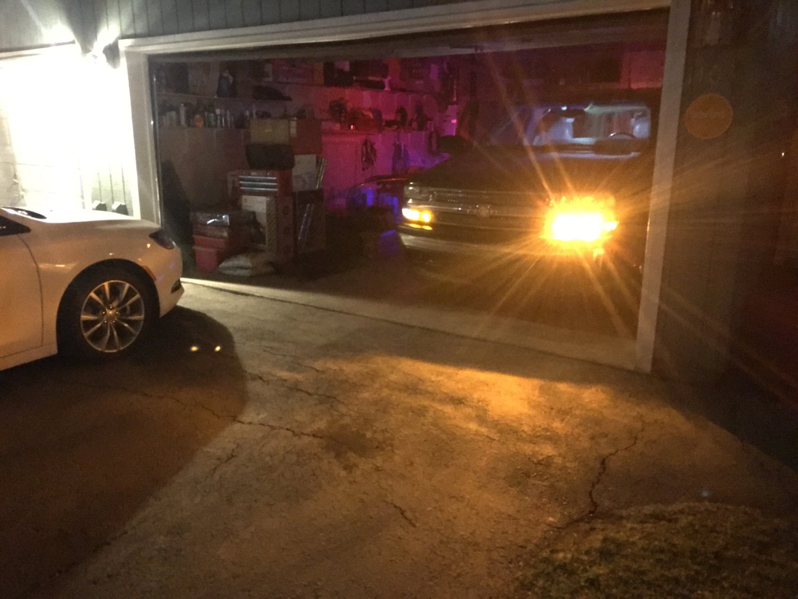

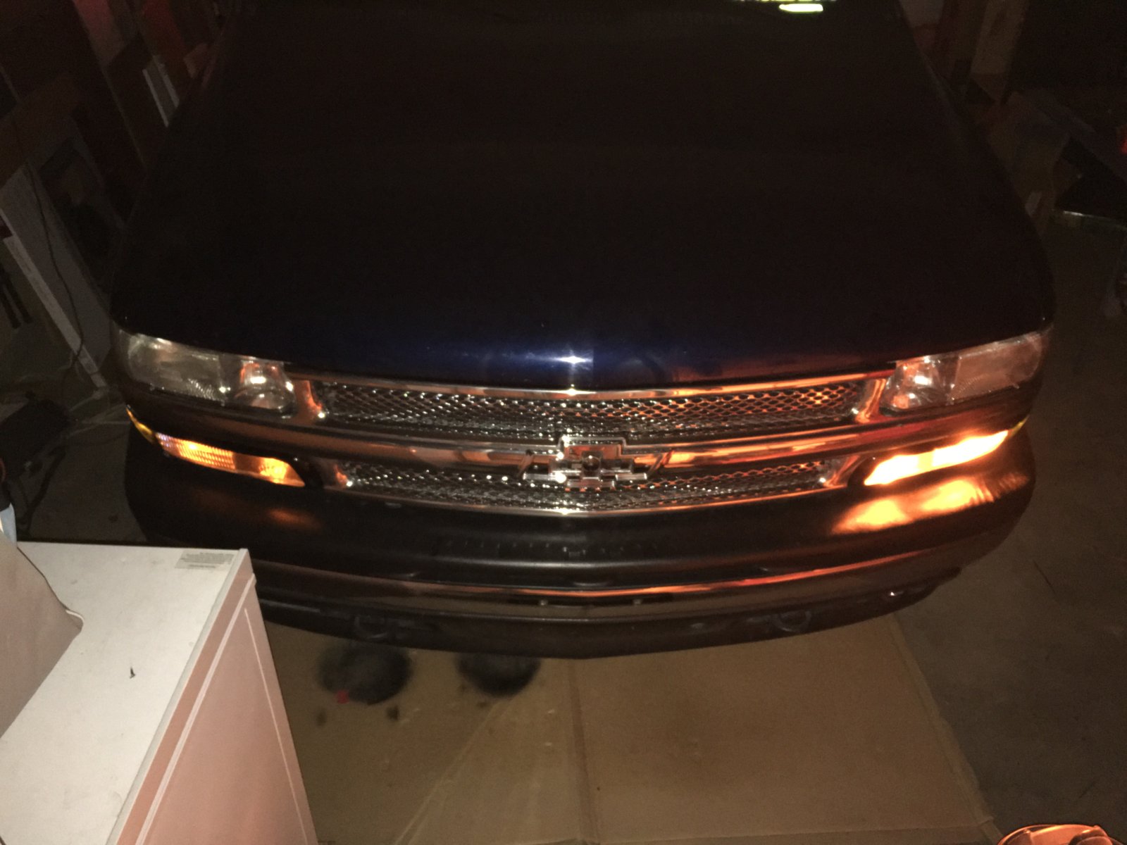

I have those same JDM Astar switchbacks and I put their matching led in the DRL. I had to take my 6low mod out because with switchback, drl, and low beam I got flashed by every other car I passed.
They are so bright that it made it look like I had 3 low beams. I love them even though the other people on the road probably hate me.
Toss those drls and wire in another set of those switchbacks like I did:waytogo:

At first I wanted to do that so it was just like one big light on the bottom but too many people flashed their highs at me when I would run both bottom lights at night.
Theyre gonna flash anyway now that you're lifted lol. What's an extra set of switchbacks lol

You do have a good point, the other night in the span of 10 mins of driving country roads I had 3 cars in a row leave their brights on as we passed each other.

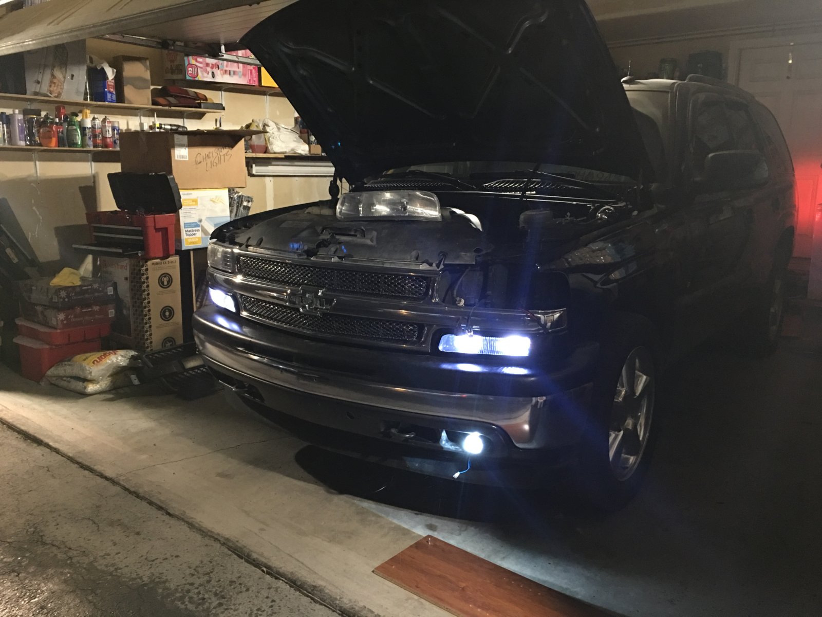

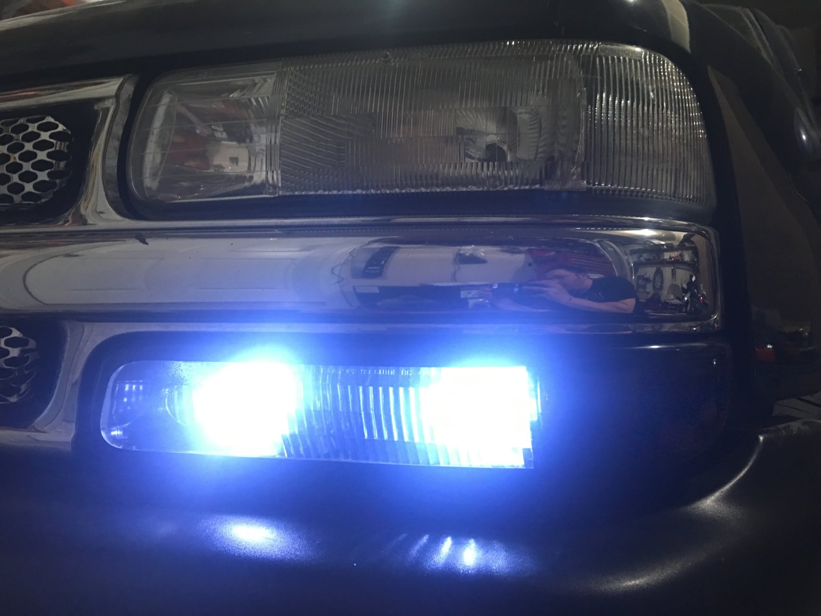

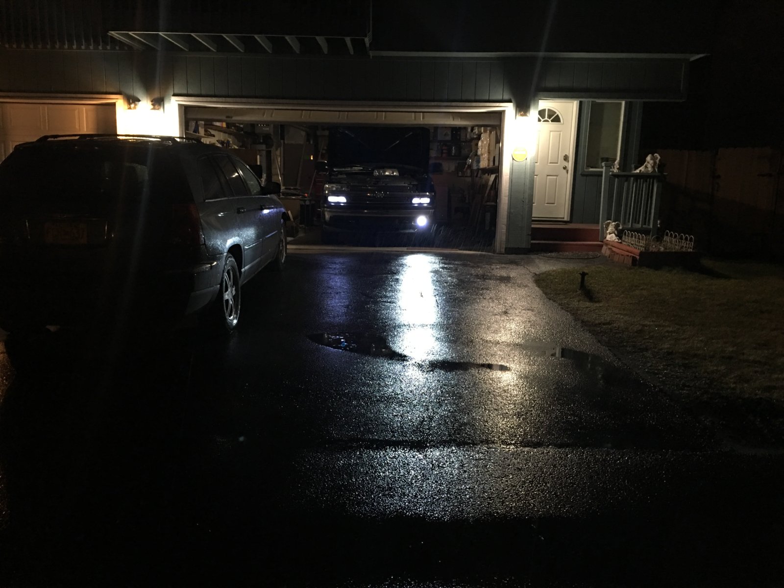

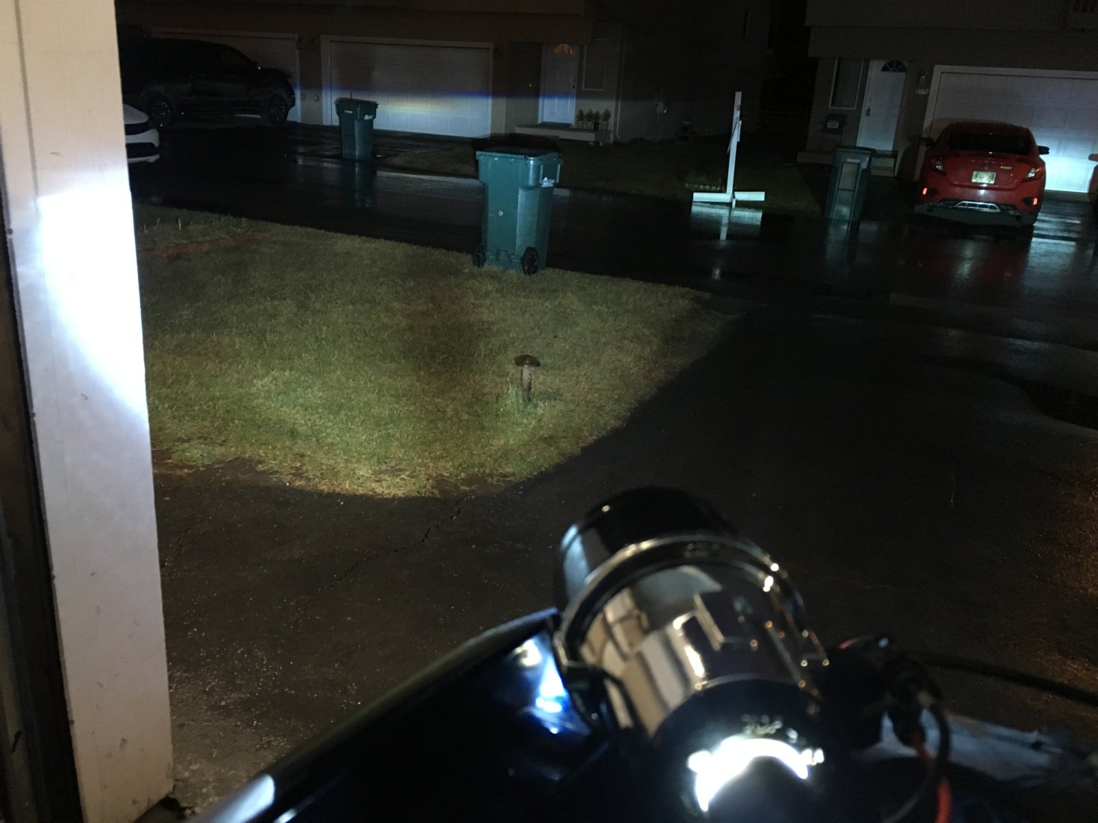

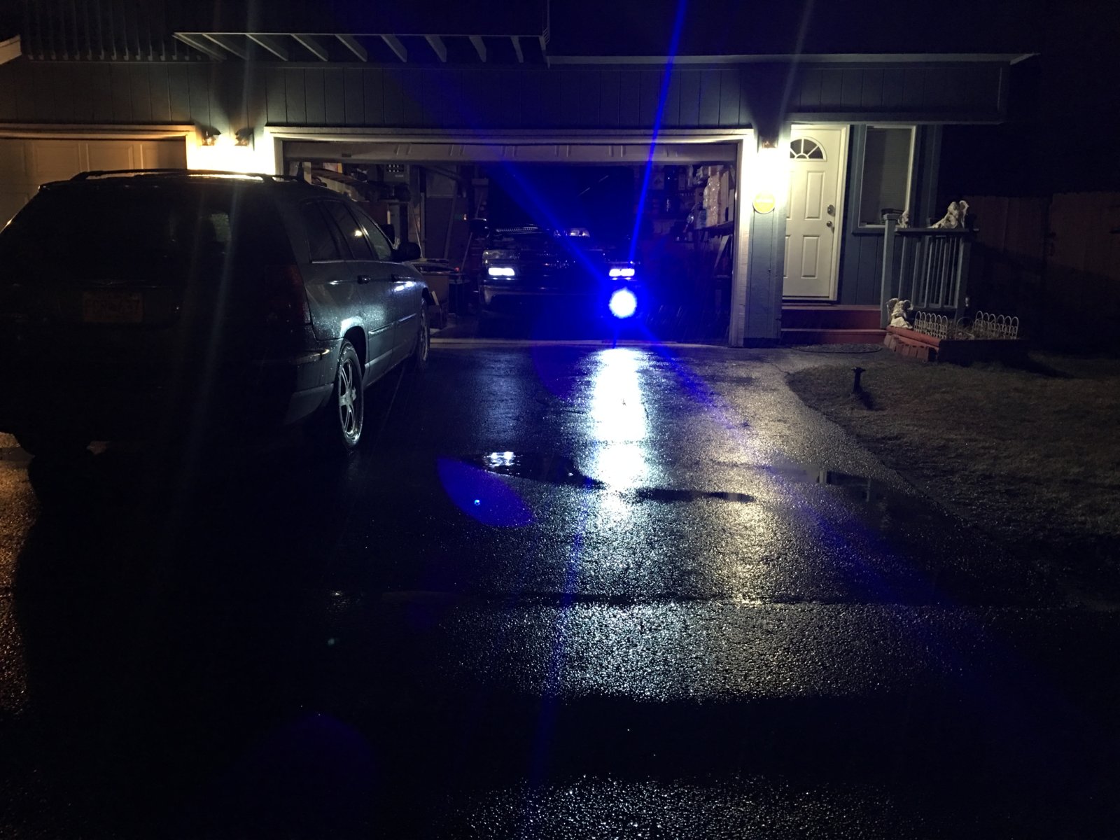

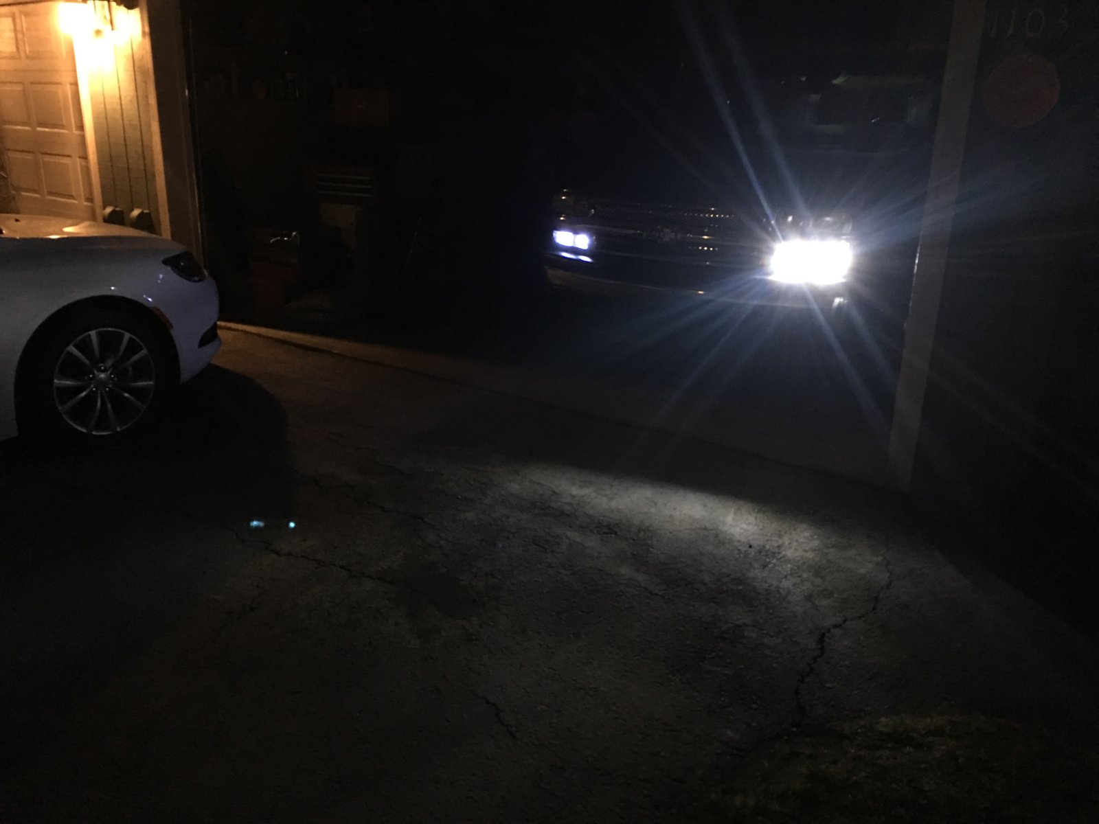

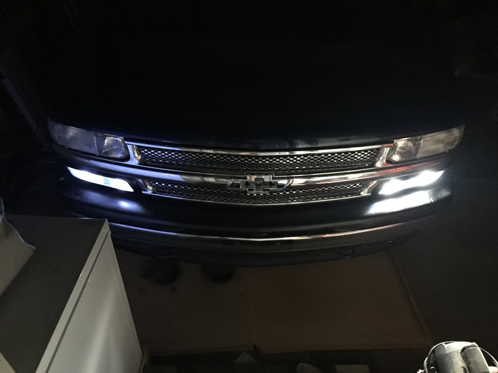

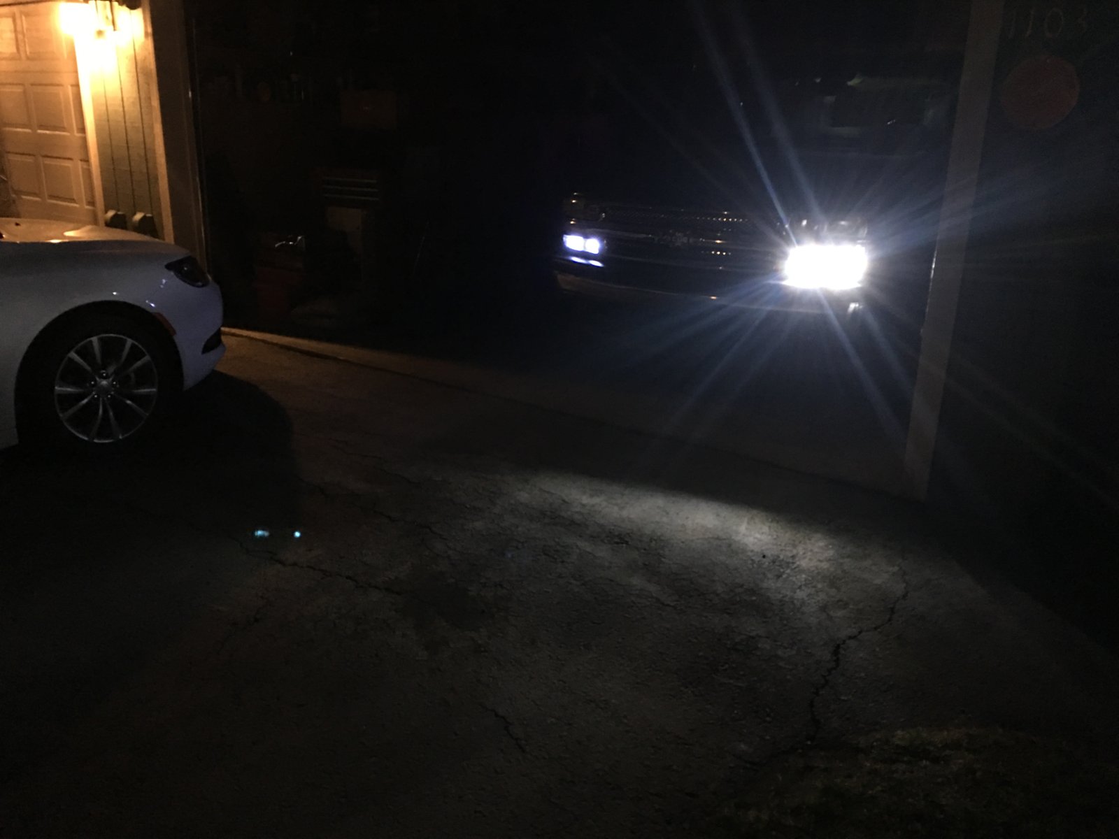

Speaking of projectors. Tested the new fogs out . Could easily use these as actual headlights lol
This is with a 6000k hid 880 bulb while waiting on new xentec 5000k H11 bulbs, broke the tabs on the ones I had before because of the design of the bulb. New bulbs I'll have to shave and the base and add a washer.
(Garage is a disaster right now)
Dat color flicker tho:drool:
Output is amazing :Whoa:
