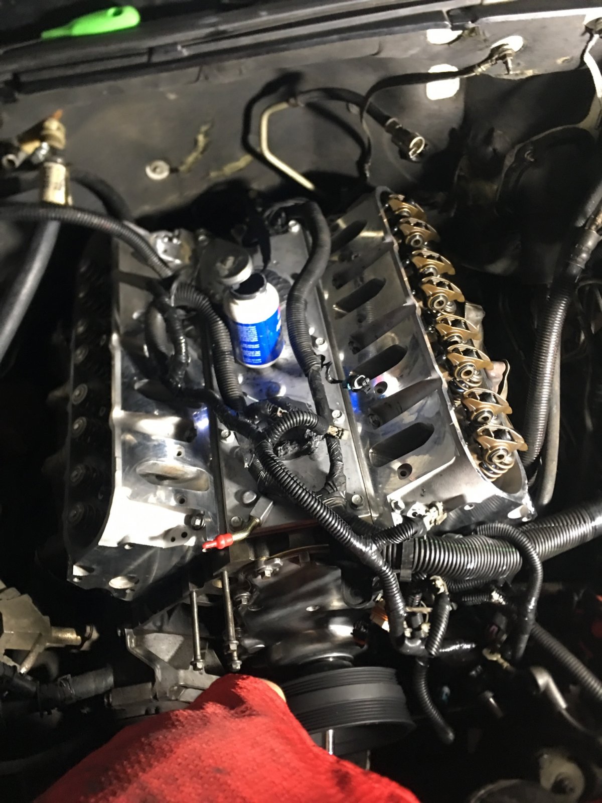

Also look up the recommended sealing of the knock sensors with gasket maker. It’s hard to see in the photo above, but I sealed the entire top of that knock sensor grommet/hole. Water gets down into those holes and corrode the knock sensors due to poor or old grommets. Replace both sensors while you’re in there.
Also, if the corrosion is bad enough, you may need to replace the knock sensor harness, so keep that in mind.
