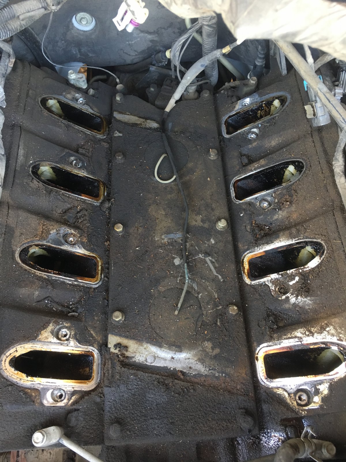

Hello, I’m new to the site and hope I can get some help on this issue i have been dealing with for a few months.
So I have an 04 suburban with 223k miles. Only mods done are long tube headers and cold air intake. Due to the amount of miles I have changed o2 sensors, spark plugs, spark plug wires and coil packs. I have cleaned the throttle body and maf sensor. I have done all this with no luck. Now the issue I am having only happens on hard acceleration. The truck seems to go into limp mode or is misfiring on every cylinder. During this issue I have tried unplugging one coil pack at a time to see if it’s a specific cylinder but doing that I have no change in idle which leads me to believe every cylinder is misfiring. Now I am currently in the middle of changing the intake manifold gaskets and knock sensors hoping this will finally resolve my issue. The gaskets seem to be the upgraded replacements but wasn’t sure if they had ever been replaced since I’ve owned it since 130k miles. And other ideas what this problem could be?

I will look into that. I did notice yesterday the chrome top plate on the cone filter came off. Can that possibly be the cause?
