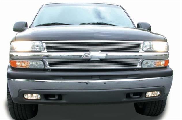

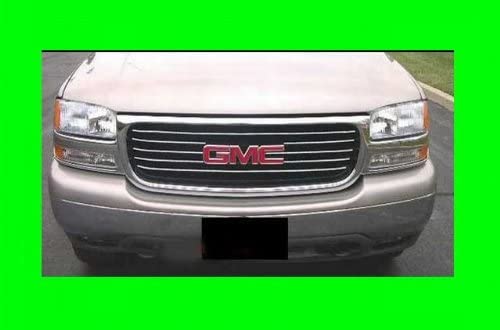

Isn't the shape of the Yukon hood different on the front edge, where it sits above the headlights?
I thought the Yukon headlights, grille and hood had that dip in them for the GMC headlights. I was under the impression that to use GMC grille and lights on a Chevy, that would need to use the hood that went with the GMC too.
