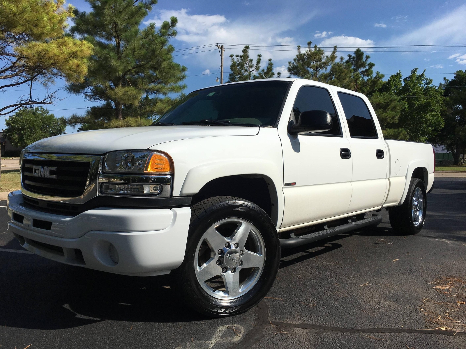

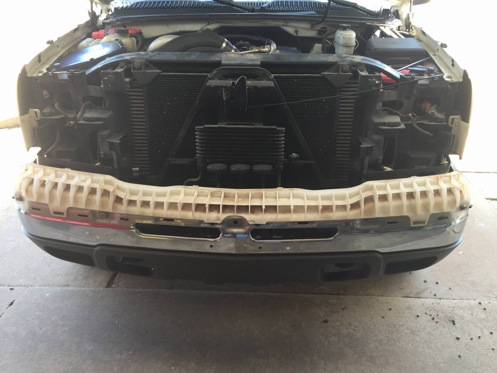

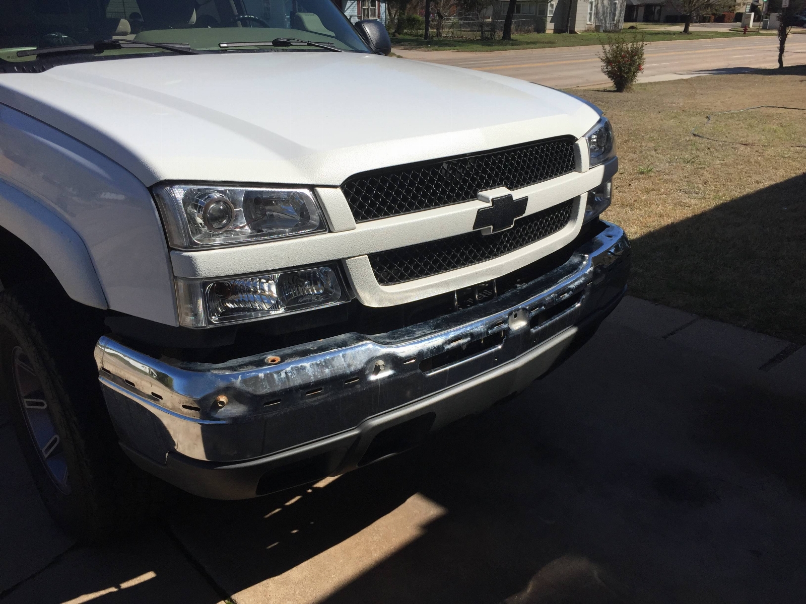

The GMC 2500 bumper isn't any different I believe it's the grill that differs as it has a lower black valence that differentiates it from the 1500 grill. On the Chevy 2500s however the bumper cap has a spacer underneath that gives it the extra height and either way they all mount up the same it's the body that was raised to accomodate the Allison under the transmission tunnel and the Chevy hood that was changed to accommodate the cooling stack. Lots of 2500 guys raise the front bumper using washers and other bits and eliminate the black valence spacer on the bottom of the GMC grill to get the 1500 look.
Source = I have a '03 Silverado 2500HD that I did a front end swap to a Sierra. I used a 2004 Yukon Denali XL 1500 fender for the driver side, a regular 2002 Yukon 1500 for the passenger side and a hood off of a 1999 1500 regular cab Sierra. The grill and bumper were from a 2005 3500HD however I got those parts because the 3500HD had a Denali-swapped front end and the bumper bolted up perfectly.
You can see the bumper cap spacer here on my Silverado front end before I had it paint-matched:
The blank spot where it should be when I was testing my retrofit before I completely changed the headlights:
Here you can see the black valence under the chrome on my Sierra front end:

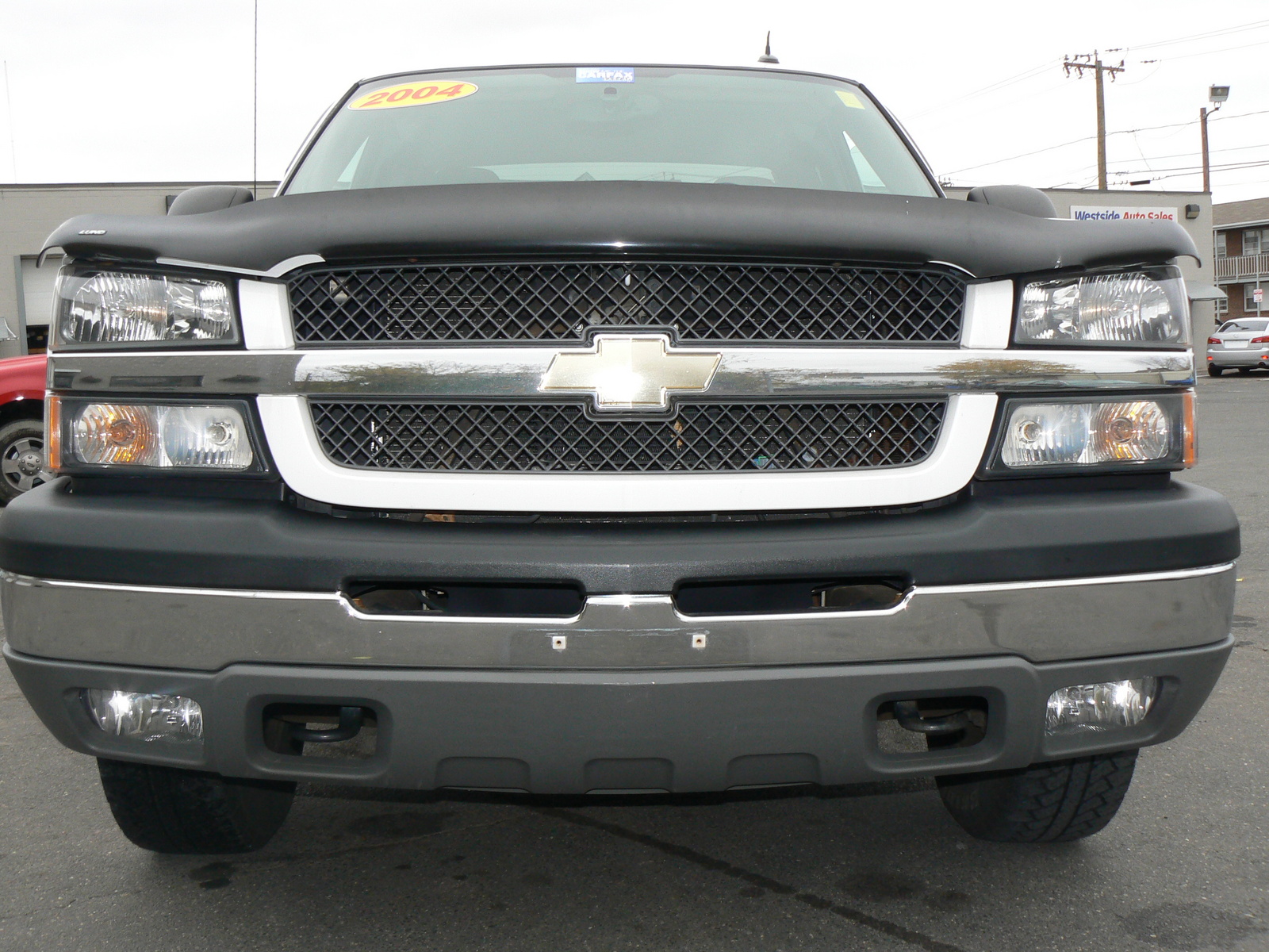

Also the bumper cap (black plastic piece) is different from the 1500 and 2500, not just the support underneath it. Look at the distance from the two oval trans cooler holes to the top of the cap.
1500
2500HD/3500
That accounts for the extra body lift that the HD trucks have.

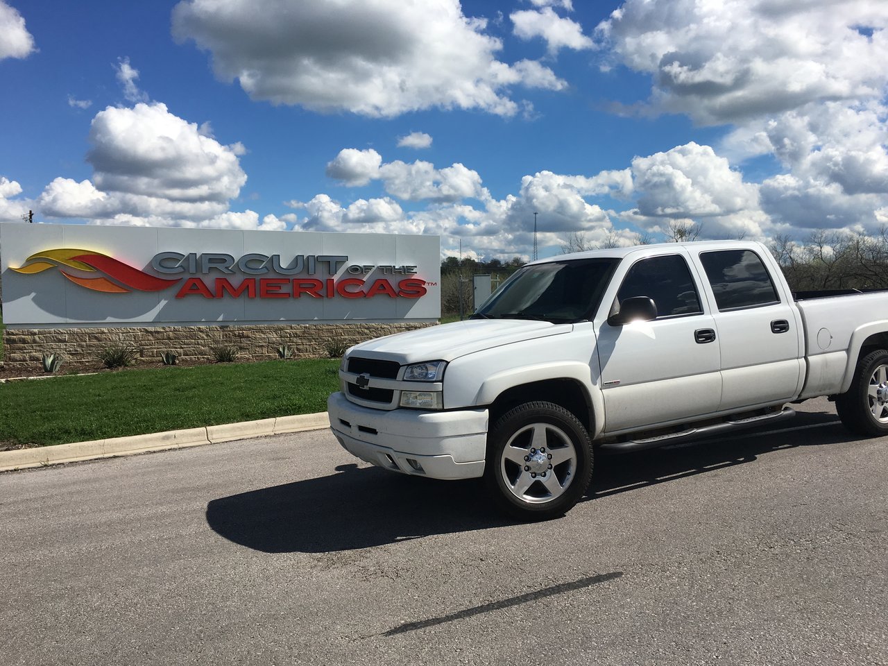

Thanks, I love them too and I picked them up with the factory tires for $450 off a 2016 in December 2015 :D I think they actually looked better on the Chevy front end I had before which looked like this:
But the truck I originally fell in love with them on has the same front end as your Suburban and looks like this :D
