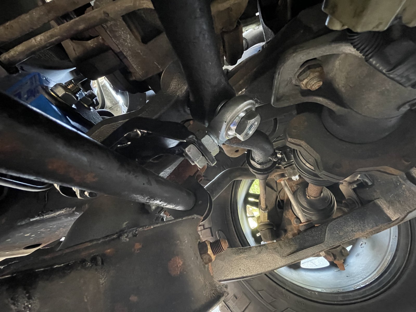

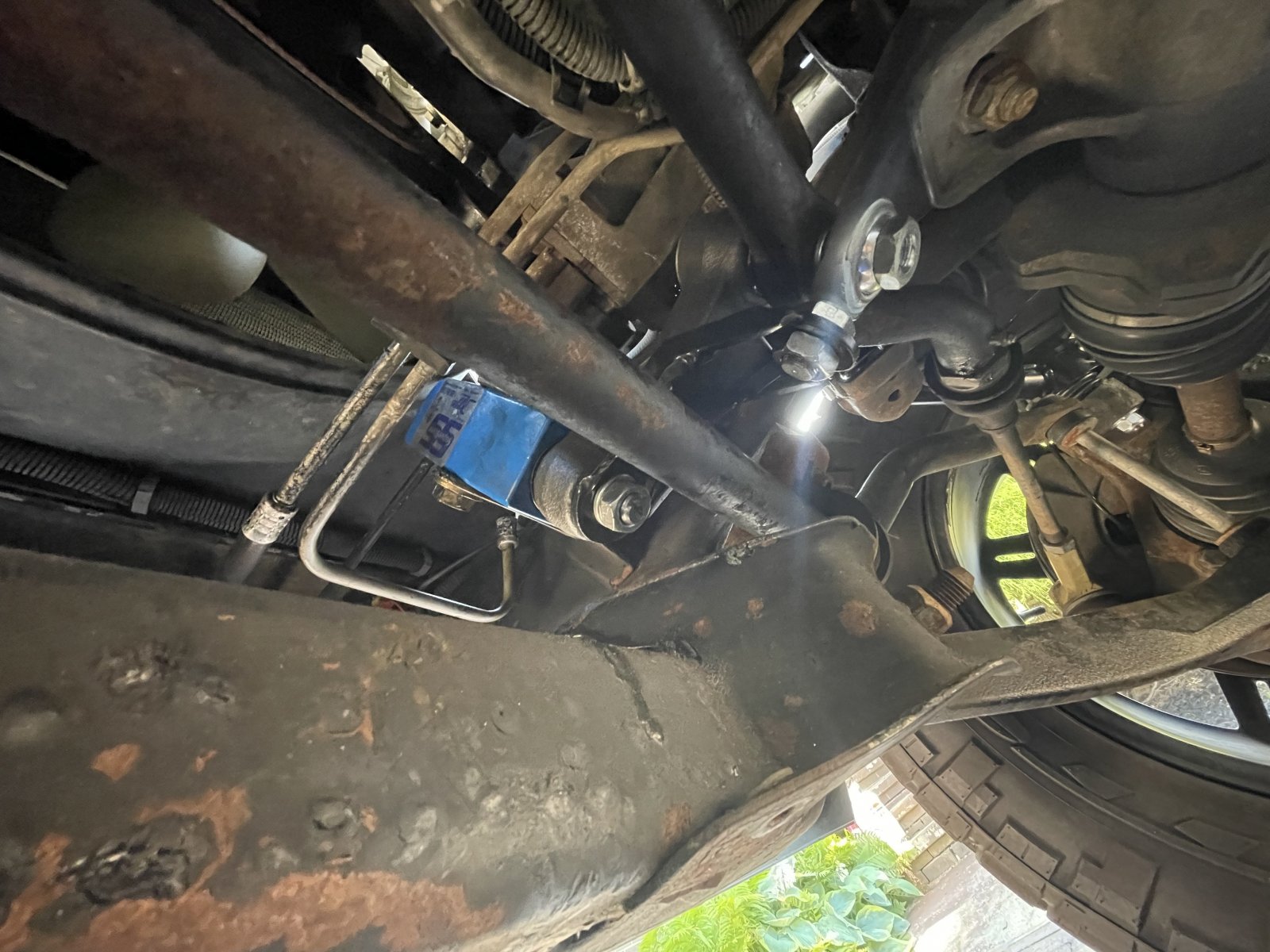

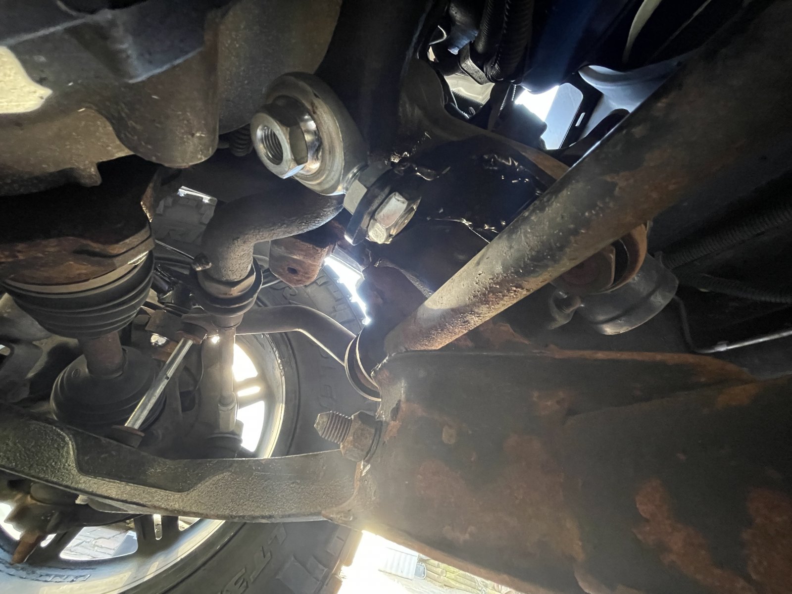

Looks straight when the steering wheel is centered, the truck also has the Cognito braces so it’s a bit hard to see in the pictures.

Is that front contraption keeping your relay rod from moving in an arc? You proplems start after you put all that stuff on there?

And the bolts holding new Heim joints too short.
