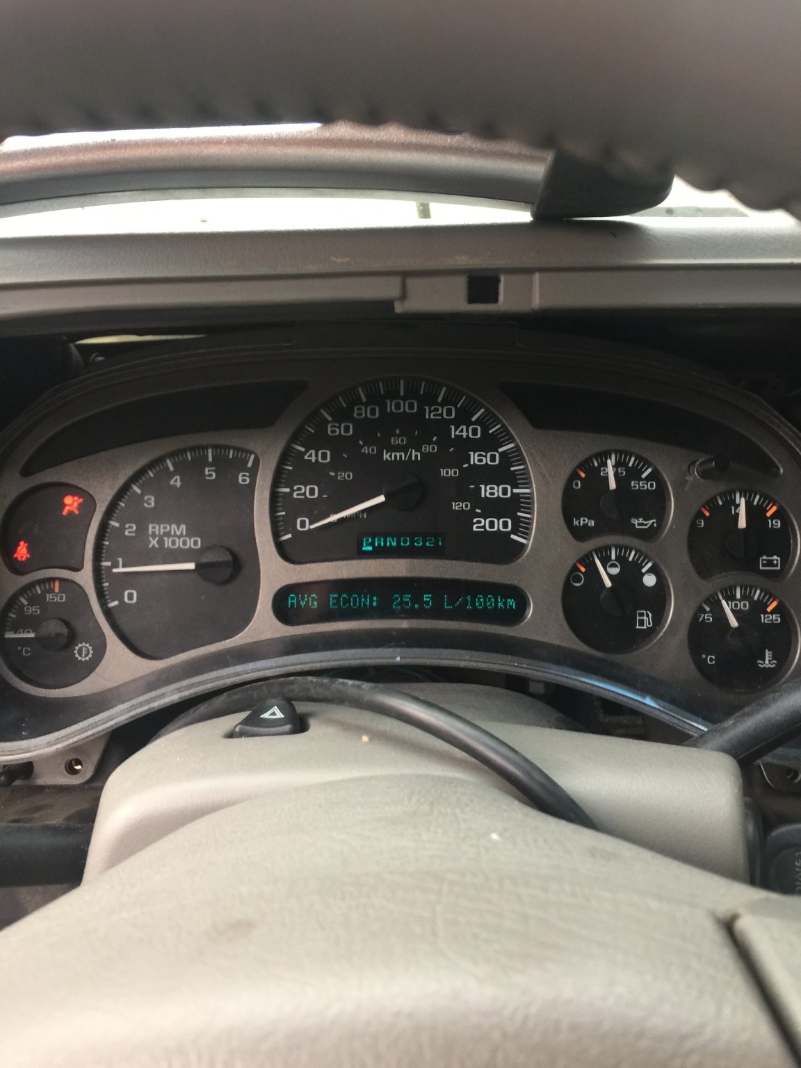

Hey fellers,
Any one with some insight on repairing
PRND and the message display?
I surfed the interweb and forums, not getting much out of it thus far

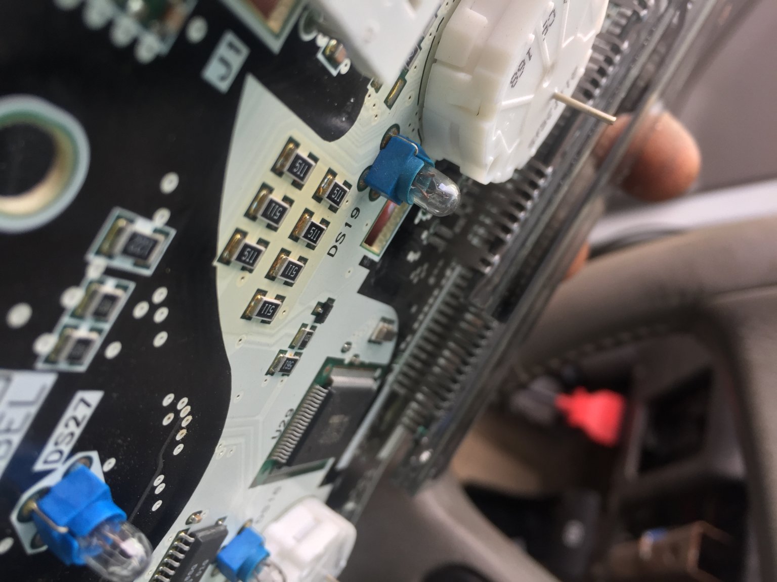

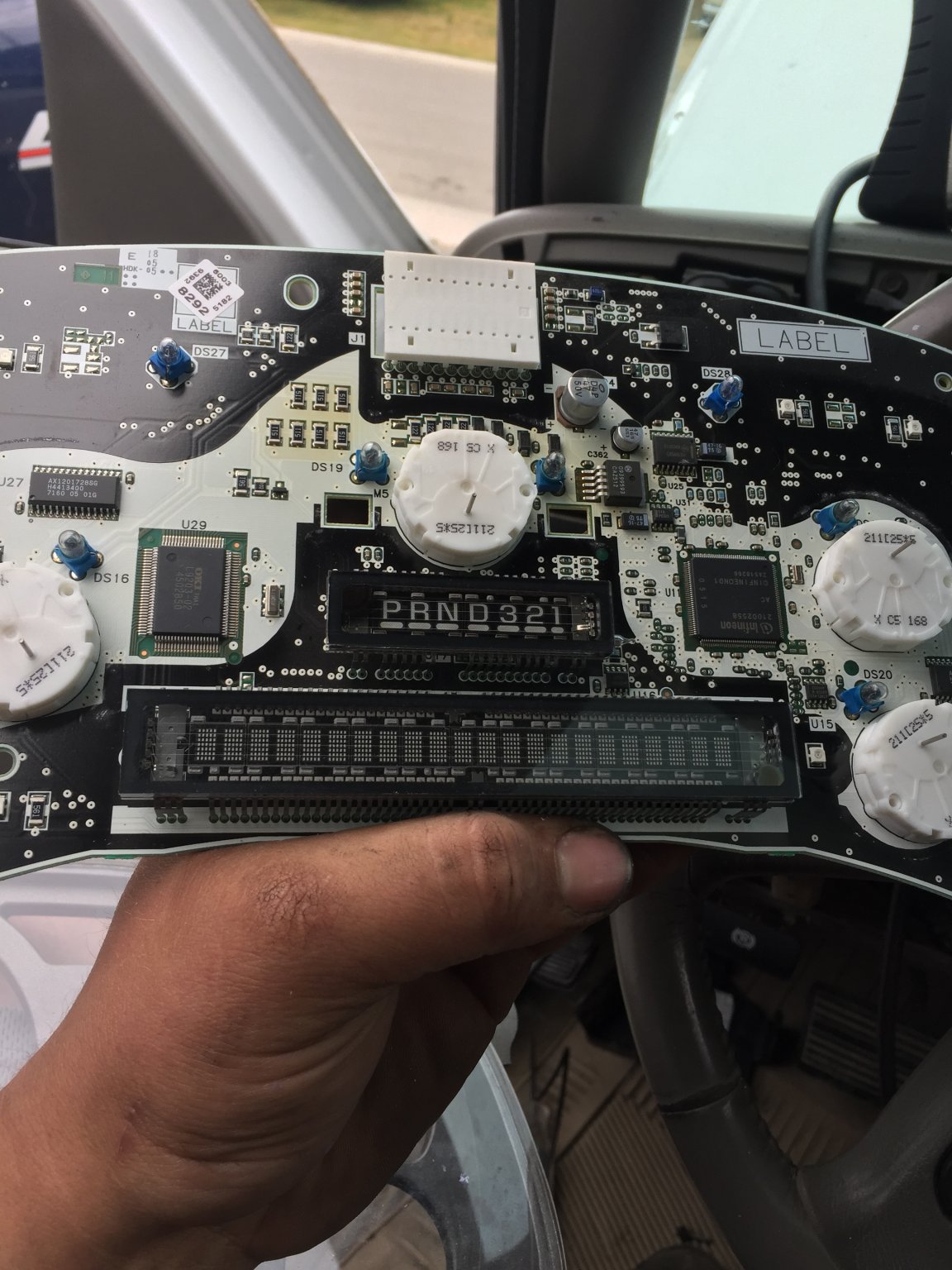

Up on closer inspection... 5 of the 7 resistors had broken solder...
Booyah!' Quick solder job for tommrow, temporarily pushed the resistors against the circuit board lol
Anyone think the trans was in limp mode on account the PNRD display wasn't working??
